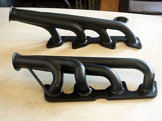

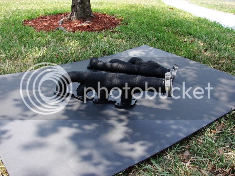

  • Take the header wrap off.
  • That particular log style of manifold is not the best design possible in a turbo manifold. It's the cheap & quick way. For much less money, someone could have modified the OEM manifold to accomplish the same thing. Food for thought...
  • THAT IS NOT "thick wall pipe". It looks like typical t304 16-gauge. When you build a header & claim you're using thick wall... That means you've broke out the Schedule-40. 16-gauge = .08", schedule 10 = .106", schedule 40 = .145"
  • The amount of material cost, work done VS the price is completely outrageous. The price is simply rediculous for those turbo manifolds
Header wrap is stupid. It's destructive, and DOES NOT save money VS cermaic coatings when building & selling a product over time. I would seriously suggest buying youself a powder coating gun, and buying, or making an oven. Powder is much cheaper than wrap. It also won't retain moisture & cause your stainless to rust.
I do like the flanges. I preffer mild flanges greatly on turbo manifolds, but it's a personal prefferance, not an issue of right/wrong. I like you flanges. :)
Those manifolds typically would run roughly $600 a pop for a descently good home fabricator to make. Which there are dozens, hundreds floating around the net. So that'd be the $1200 range, give or a take afew hundred. Now that that's a blind guess, and I don't like blind. So let's break it down!
4x 1.5" 16-gauge 180* mandrel bends with legs = $80usd
6' 1/5" 16-gauge staight pipe = $50usd
Not sure what size V-band you're using but for example purposes:
2x 2.5" v-band kit $110usd
Custom waterjet/CNC milled flanges typicall run from free to $100 a pop. I'll spot ya & say $100 a pop. Flanges = $200
We're up to $440usd. In raw materials for both manifolds.
Any welder/fabricator worth knows that raw material cost x3 is *generally* going to be very,very close to the quoted price. $440usd x3 = $1320.
So $1320usd worth of work suddenly equals $2500usd how?
At any rate. Your product does not seem to be bad. But at the price you are listing them at. My opinion of them changes from, "I'm glad someone is finally selling them", to "wow those manif's are POS's for the money, and are meant to separate people from their money just for monitary gain".
ps, I am not being insultive, simply stating what I think of them & should be obvious to anyone else that dabbles in any kind of exhaust / manifold / turbo manifold creation. The price / product ratio is horrible. Ya gotta recoupe some cost of down-time on the guy's car, but I honestly don't see why the price would, for any reason, everbe more than $1750usd shipped to anywhere in North America.

Oh... And AFA complete header VS incomplete.
Technically those are incomplete turbo manifolds. To complete them, they'd have to take a v-band flange & weld it to your choice of turbine flange. If that were done, then it would become a complete set of turbo manifolds.
So incomplete turbo manifold. I would just call them turbo manifolds.
I have no idea why they would go to the trouble of ripping the legs of the 1.5" stainless pipe tho. All I can figure is maybe that's the only way they could weld the runners together? I think you could get a normal torch with a short / button back in to merge them faster without all that work. If not. A pencil style torch is like $75 online. Every manifold maker should have a pencil torch to seal the inside of their collectors anyway.
(Or have a gas lens & use alot of stickout & pre-flow)

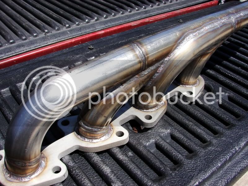

Eh, IDK if I'm better than him & wouldn't go so far as to say so. I don't think I am, he's welded for longer. I'm perfectly good enough... I've yet to have anything I've ever sold, or been hired to do crack, if that means anything...
We're doing gtaw this semister, I can't wait! Our program had the #1 & #2 overall welders, both were 1 & 2 with gtaw for the state of alabama, so I know the guy can definately teach people how to tig. I'm excited about it.
It'd be afew hours on each to reproduce something like that the way they're doing it. I hate ripping pipe that way with a grinder. It's extremely old-school & not too fast. For someone making multiple set's, it be worth it to just run a fence on a vertical bandsaw & then it wouldn't be so bad.
I have ground some very long 2-1 merge collectors that way & it's horrible, I hated it.
The only time I've ever done something like that was making transitions buy ripping V's out of them. Saves like 1/3 of the cost of buying one (or much, much more if you need a long one), but it does take up some time in the process.
I'm babbling on... Eh, I'd rather see a log manifold like that done with a typical collector than that really long one. That's bound to affect the flow to some degree. Just a nice, typical 4-6" merge collector... Everyone & their brother can make them, and there's way less work involved. (welding can be alittle tricker, but whatever)
And I would like to add... Anyone else see a lack of an external wastegate? IDk the space requirements or that engine bay layout. But before claiming 100% compatibility I would give placement & routing of an external wastegate a thought. Internal is great, but you know... T3 class turbo's normally start to creep around 220-250bhp on 4 cylinders. (so 440-500bhp)

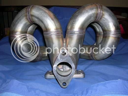

There's a manifold from while back.
Not great, but definately not bad by any means..........
Gas lenses rock :) Mine started coming out so much better the day I ditched the normal setup for a gas lens like everyone else told me to do. Sheesh. Just wish I had a pulsed tig. Man those things are great.
Oh... And ditched 3/32" filler rods for 1/16" goes a long way too lol!
It takes a man to do good welds on things like manifolds with 3/32" rods. I only use them for when I need alot of fill, like the random big gap, etc.
