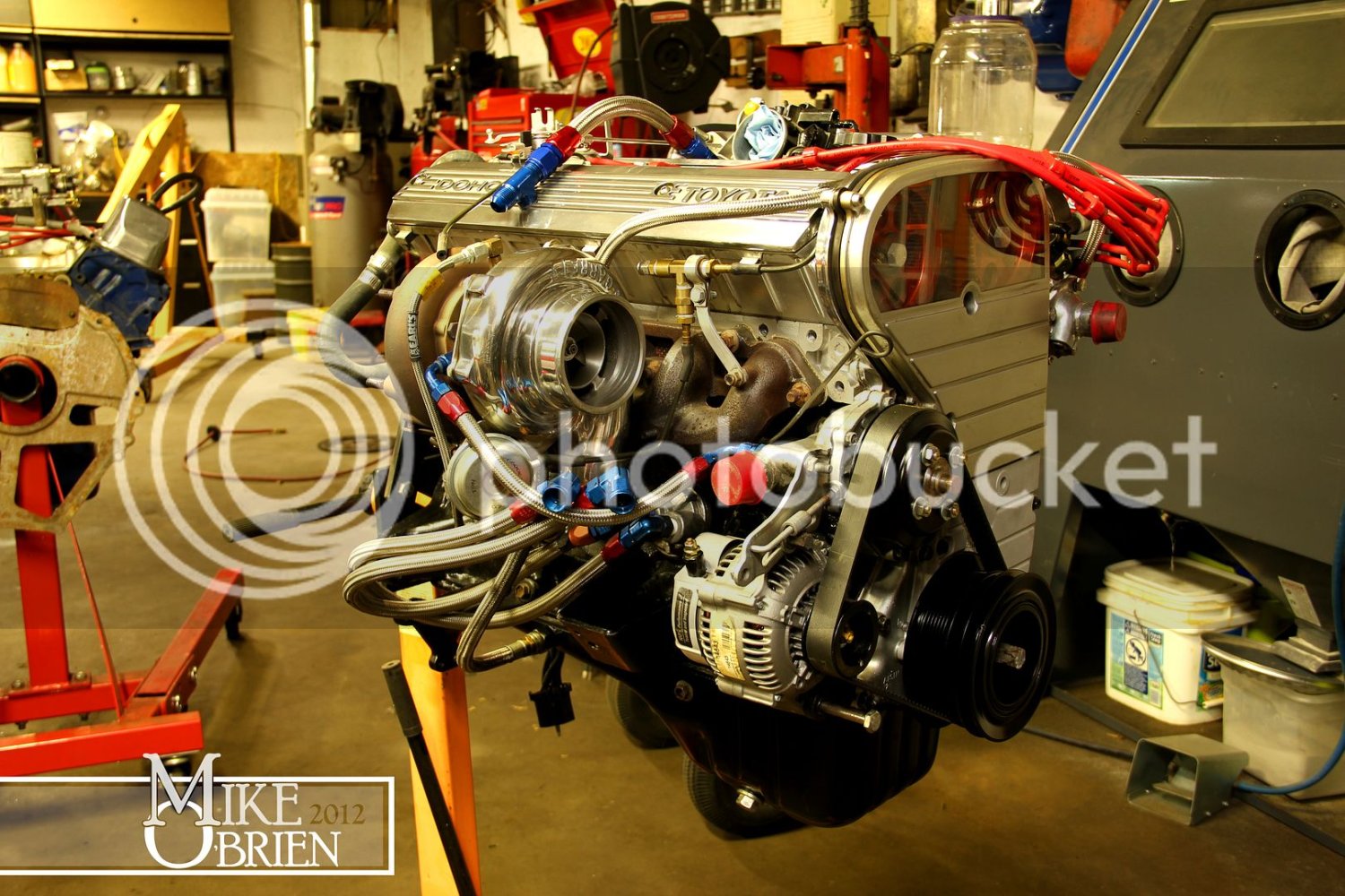

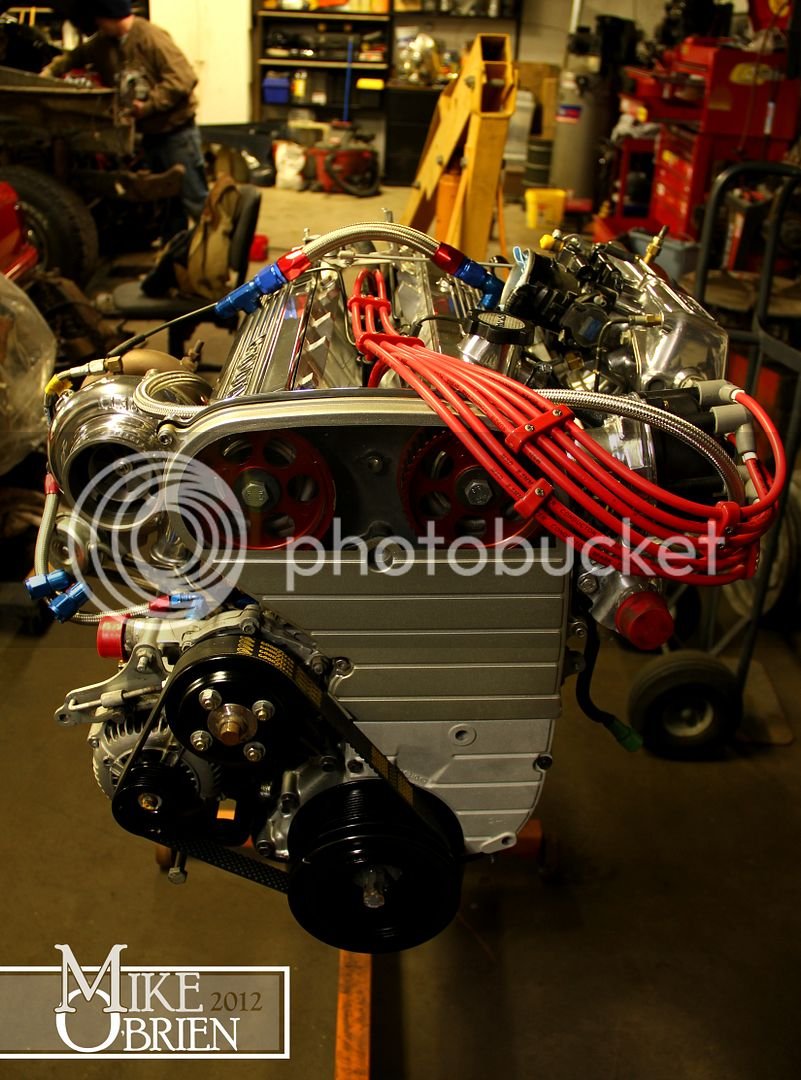

I pulled my old motor, which had alot of custom fab and parts done by myself:
I was running Megasquirt II with 7M 440cc injectors, ct461 (61mm) hybrid turbo, and tons of other goodies. It made good power and noises, but I felt the need for something with a more responsive torque curve and better parts availability.

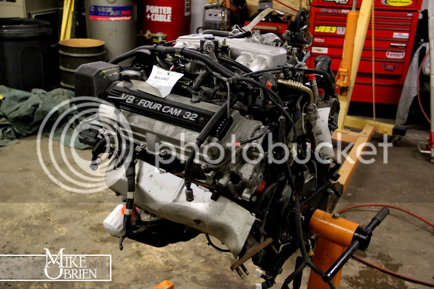

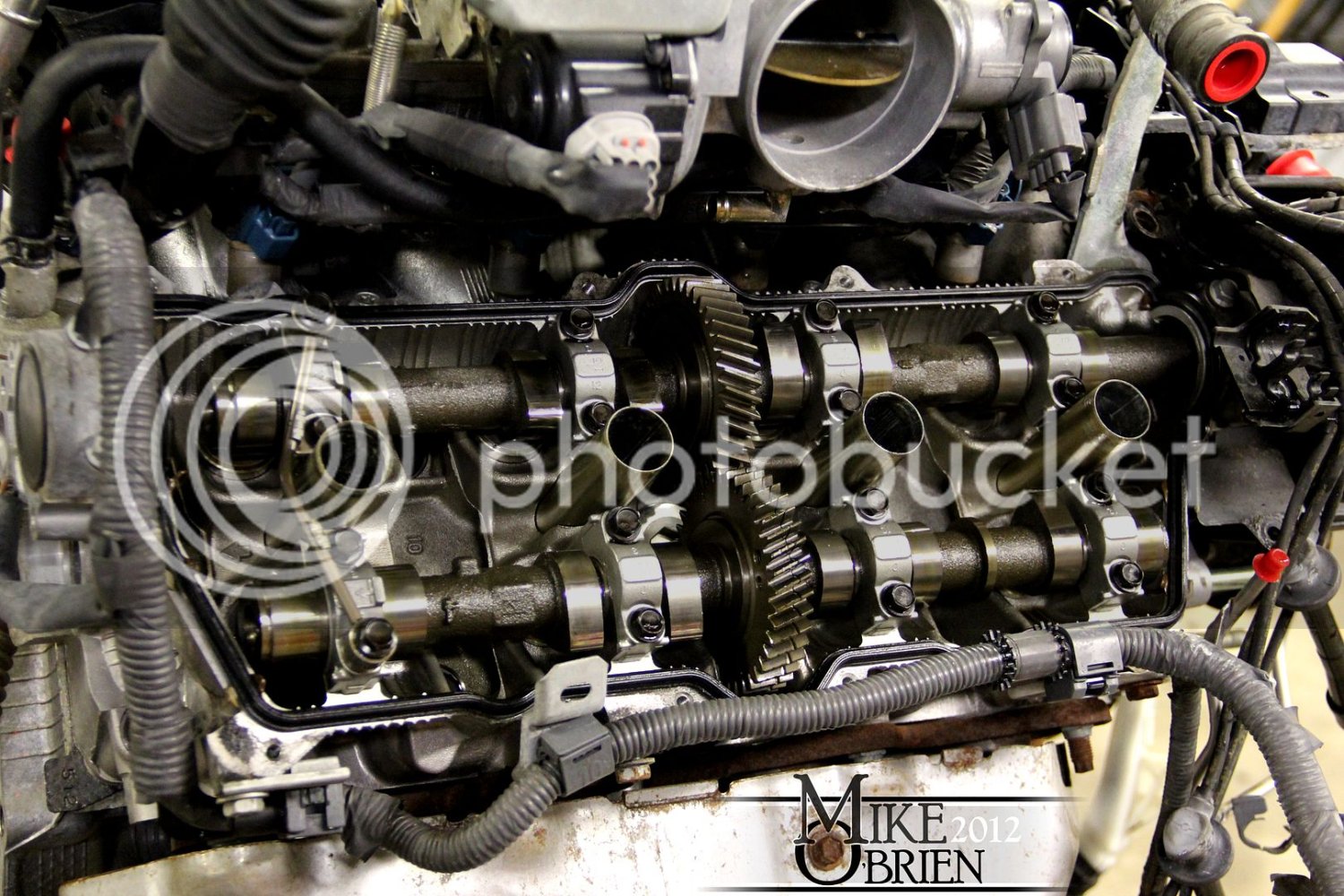

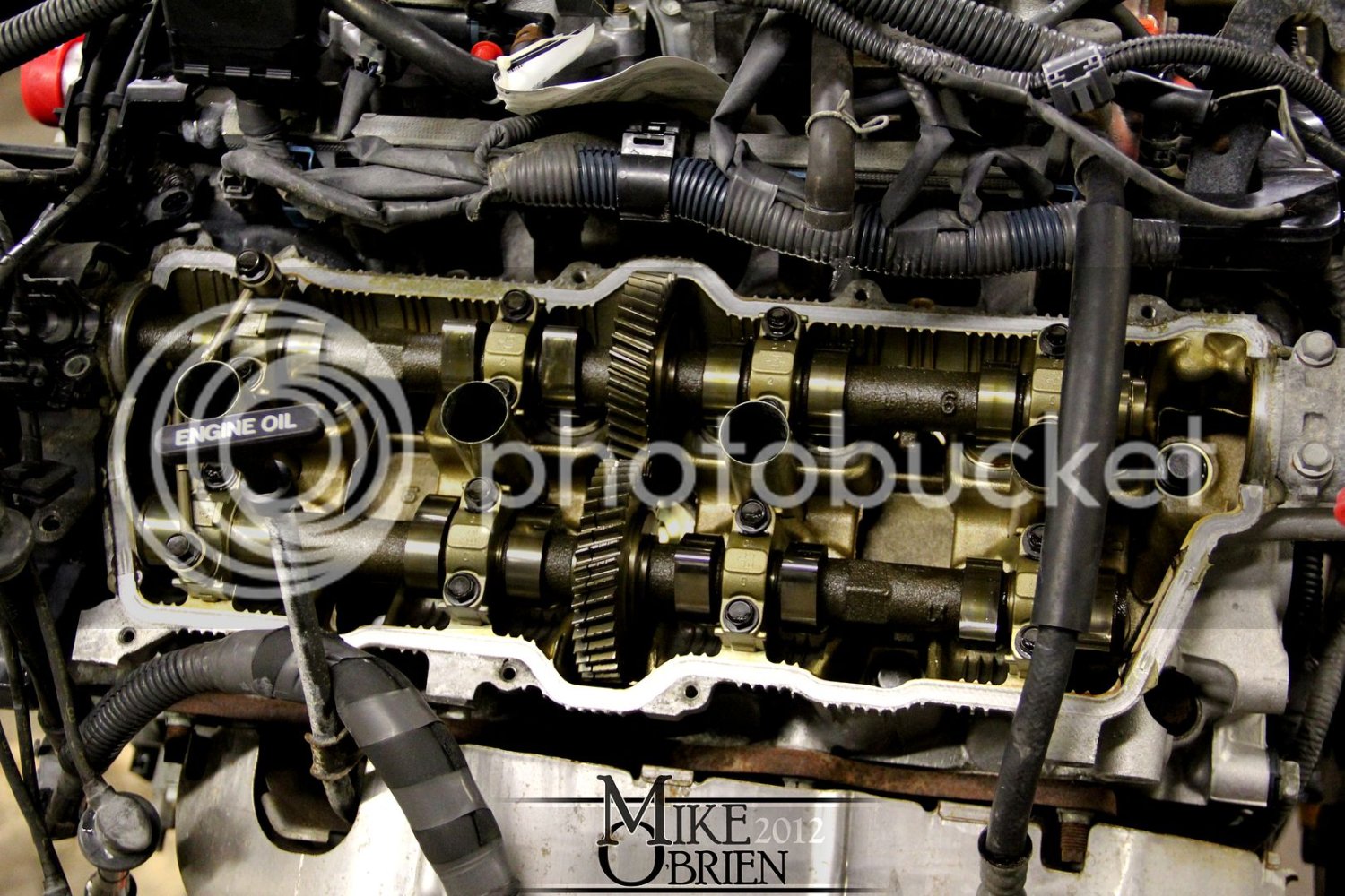

I recently purchased an 80K mile 1uzfe from a 95 LS400, and it is proving to be quite virgin upon inspection:
The plan is to go single turbo as of now. I am no stranger to standalones, wiring, or fab work (as you can see), so I look forward to the challenge. I was very happy with the Megasquirt II on my previous engine, so the plan is to continue to use it with EDIS-8 and a set of cleaned and balanced 440's. I am scouting for pre-95 rods, but will most likely fab the car up as is without touching the internals of the motor for now. I am looking for a decent low end response turbo, but something that will let me gently cruise without the need to be in boost at a mere touch of the throttle (to keep some economy). The current contender is a Borg Warner S300sx3 with a .91 divided housing, this should get me the response and power I want, even though a little low in the turbo's efficiency.
