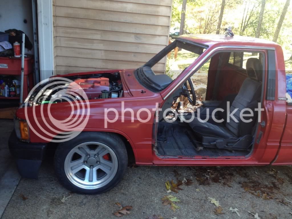

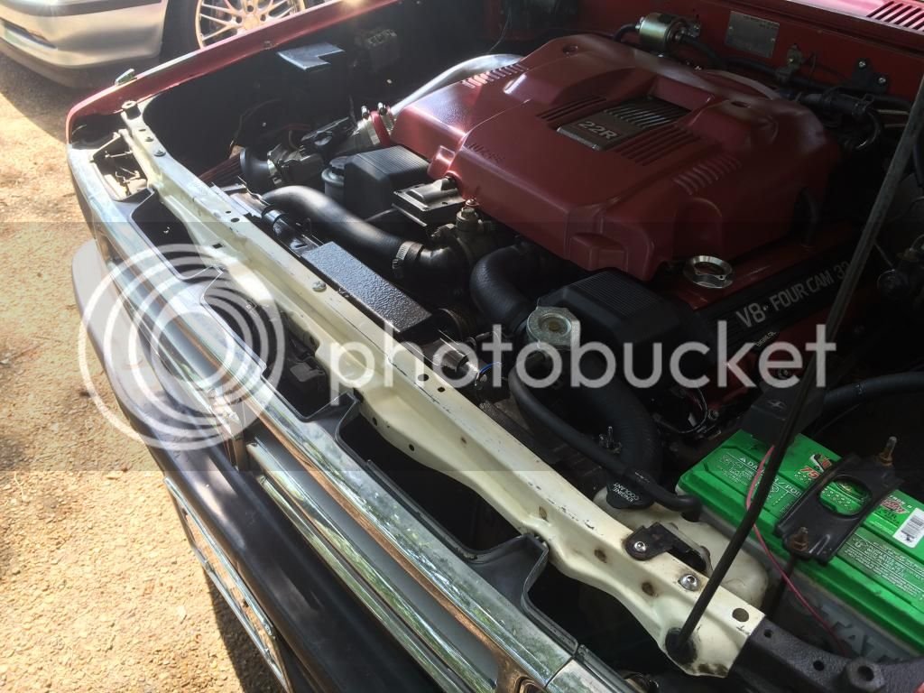

SC400 exhaust manifolds are a perfect fit. They are the only OEM manifold that will clear the 2WD upper control arms. I used the SC400 oilpan and replaced the original 2x2" bolt in crossmember with a welded in 1x2" crossmember to clear the pan. Xcessive manufacturing now offers motor mounts for 22r to 1uz swaps that work with this truck.
My truck has been going strong for over a year now. My only serious issue is lack of traction. Best 1/4 mile is 14.5 @ 99 mph spinning through 1st, 2nd and half of third. It's easily a low 13 second truck with a $200 1uz.
