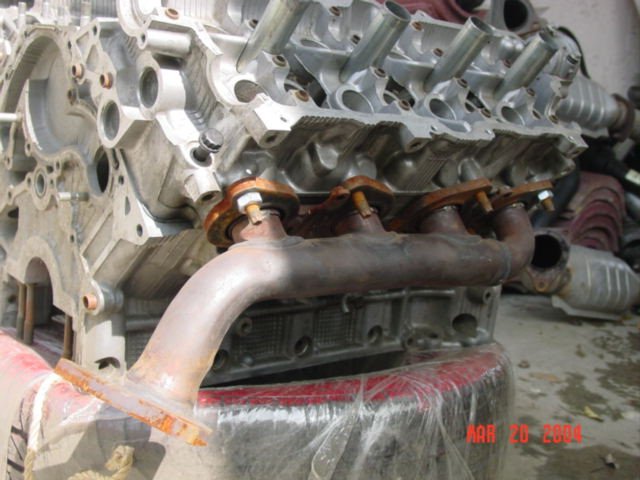

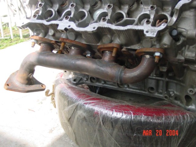

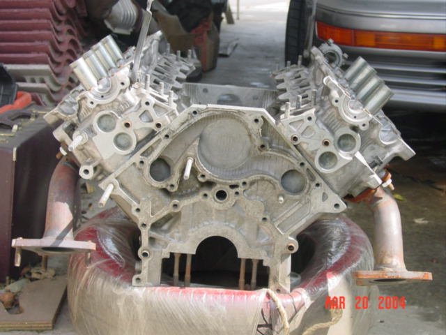

I have been looking at stainless steel pipes and they are very expensive. An average price for a 2.5" 90 degrees is about 25-30 USD. and if i get all the pipes for the twin turbo would be around 400-500 just material alone. I got the idea from Chrisman (thanks bro) However, i have mention this about few years ago on one of my articles about the Turbo Crown headers.
I got those Tundra Headers from ebay and got it for 100 usd plus 26 shipping. Total is 126 USD. I plan to cut the flange off and tig weld a 2.25 stainless pipe to it and make my TT that way.
Once i added the 2.25" SS pipe and chrome it again. It will looks like the new pipes be part of it. This route is very cheap and easy. The SS headers flanges alone are 120 USD. The SS headers are tig weld and very good qaulity.
This package also comes with two header gaskets and two CAT gaskets along with bolts and nuts. Very good price. Here are some pics
