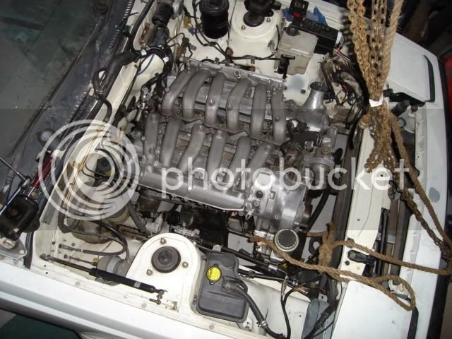

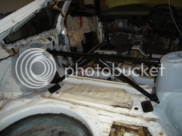

For those familiar with MA61 this pic will mean something, such as wishbones/A arms. More pics later.

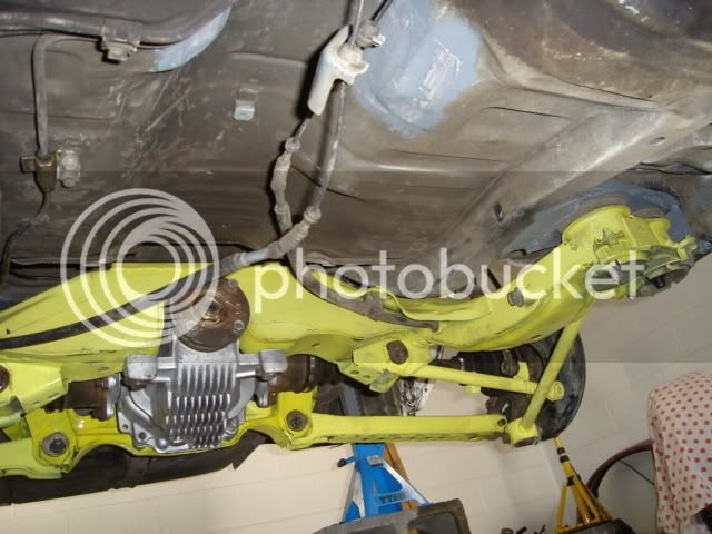

ok so where is the 1gz, and ill start the most common question everyone else is gunna bug you till the end of earth about. Where did you get it and can i get one too???
And it looks like your swapping a mk3 rear subframe in. all that welding, then why are the braces just bolted in?

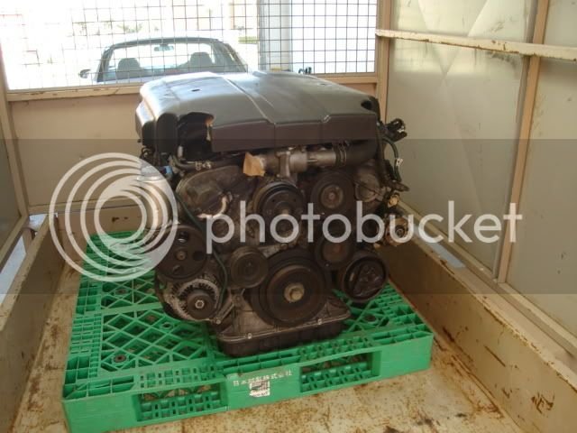

There will be engine pics on the weekend.
Yahoo Auctions Japan via an "import broker" in Melbourne, I told him the item # & my max bid, subsequently I won, he organized shipping.

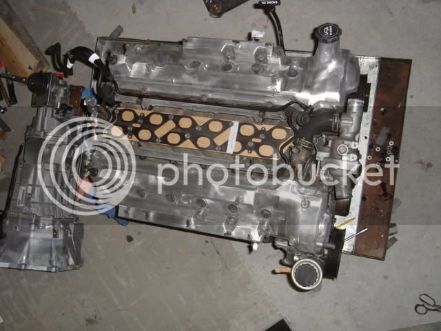

so im wondering, are you planning on putting the motor in stock or are you gunna do any intake manifold work? personally i would do somthing similar to what top secret did and remove the double(quad plenum) in favor of somthing similar to aftermarket supra plenums.

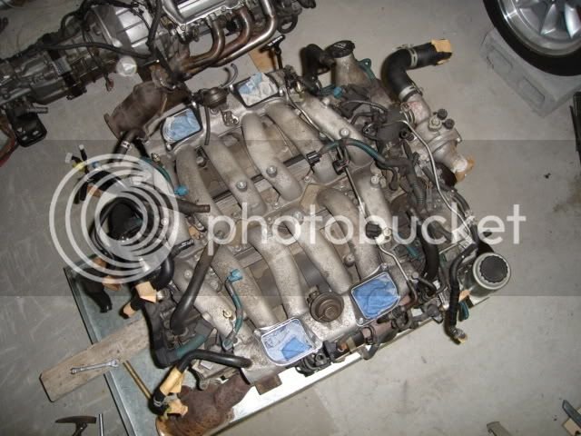

The top level of manifolds have to go, this is a way tall engine.
(compliments to the 60deg V)
I had planned to keep the 12 runners similar to Top secret or the BMW.
If that was too tall the next plan was to make a plenum in the valley as I want the stock hood.
I see today that the runners bolt on to a valley manifold that is way higher than I expected, so a valley plenum may not work out, hmmm?.
On the plus side, the Ex flanges from side to side are about 5" closer together than a UZ, compliments of the 60deg V, this I hope gives me room for pairing 1-6, 2-5, 3-4 headers for 180deg primaries.

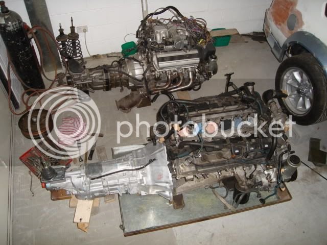

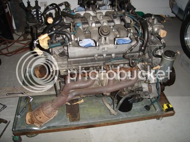

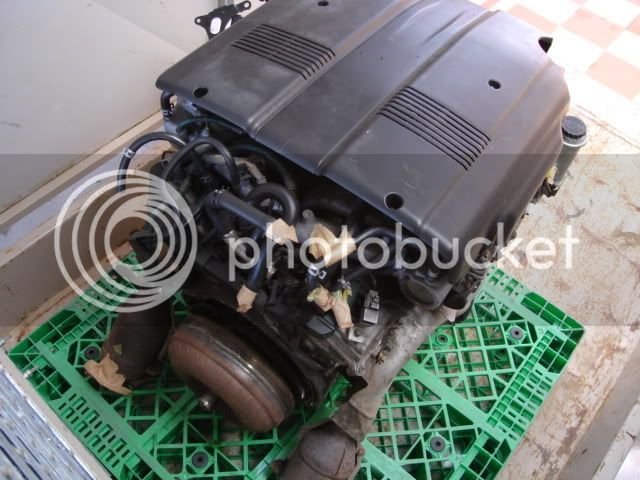

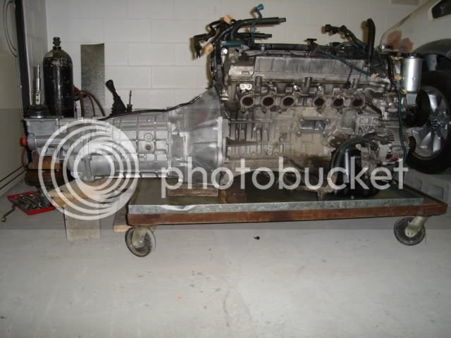

Engine pics
Swapped flexplate for a UZ one that bolted up to the crank ok, they appear identical but the block bolt pattern is different
Stock exhaust is not bad, the oil filter is nearly as big as the alternator
