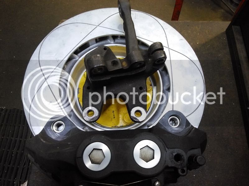

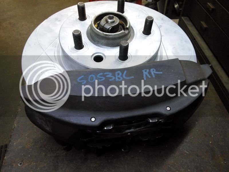

This will be my second adaptation of the Lexus monoblocks. The LS460 calipers are massive....
350x32 Cayenne rotors make this setup sick....
