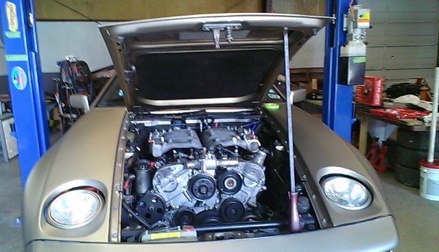

Looks like a great project; out of curiousity, why the 1GZ instead of perhaps a beemer V12 to keep it all German?

Because Toyota builds a better motor and it is only 1.5" longer than the LS1 I swapped into my 928.
Exactly.
1GZ is far superior engine in terms of quality and design than the dated 80s spec M70 BMW V12.
Horrible boat anchor engines as far as I'm concerned!

Agree on the beemer V12. The only possible way to use them is rebuild and run on standalone ECU. '90-ish BMW V12 uses about 4 or 5 ECUs to run

Looks like Dinsdale is making great headway with the MS pro. I keep hounding him to make sure he writes everything down. He is truly a walking schematic on everything he builds. If anyone could pull this off it was him, that's why I am building parts for this and future projects. I am still on the fence what platform I want to go with. Dins is saying old school Celica 1GZ. But I want the Uniqueness and reliability of the Vette torque tube and transaxle as well. So i may drop the combo into an SC3/400.
