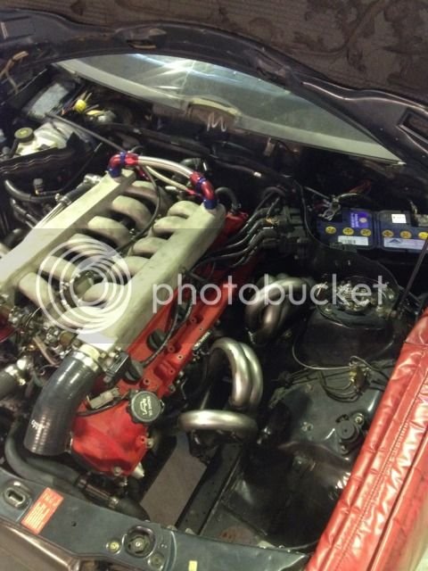

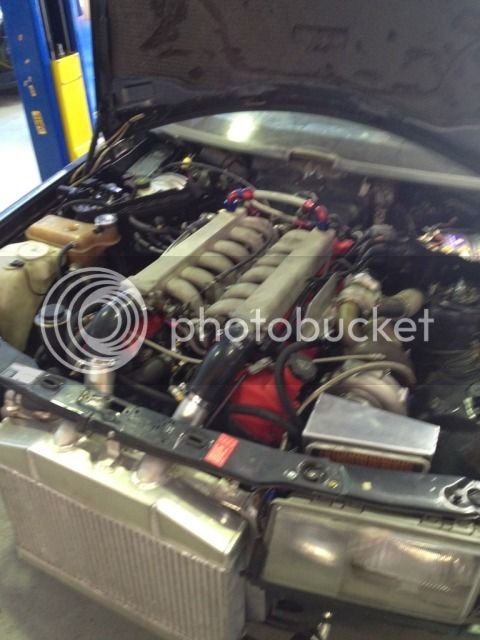

My setup looks like this:
Stock (unknown history) engine with a GT4088R and a T56 gearbox.
This failure happened while the boost controller was being setup at 345rwhp and 4500rpm. Everything was safe - rich mixtures, minimal timing, no cam advance and E85 fuel.

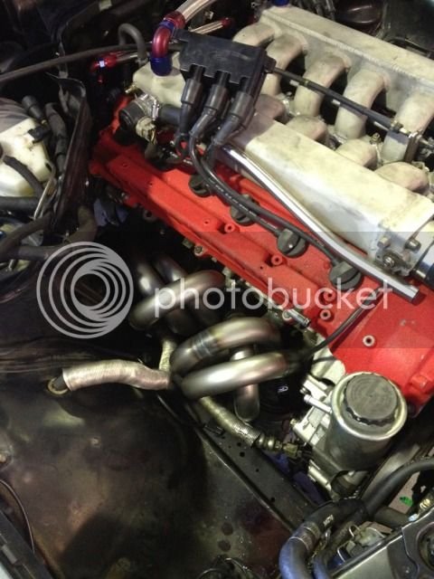

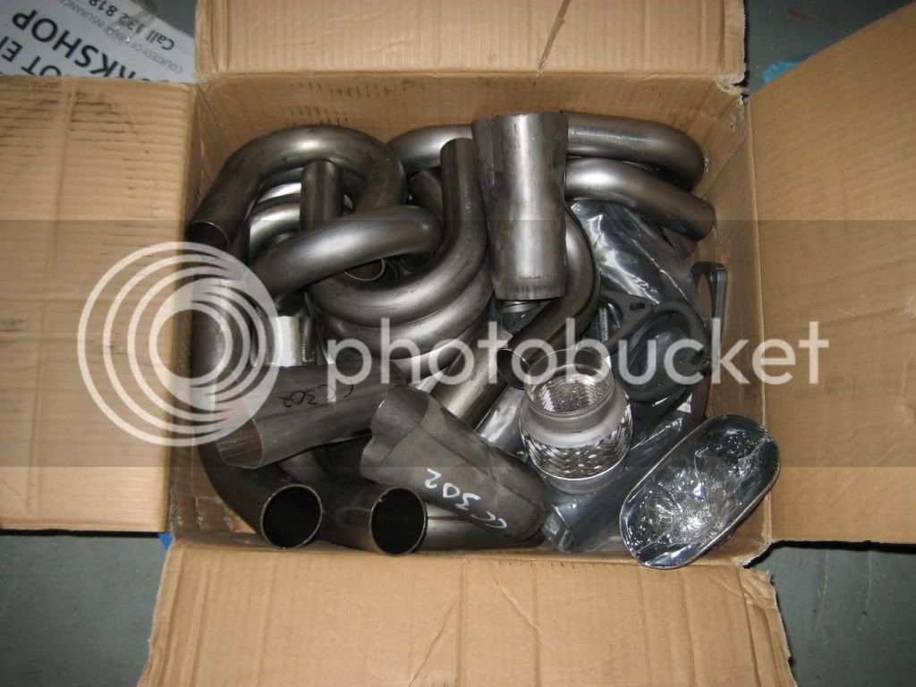

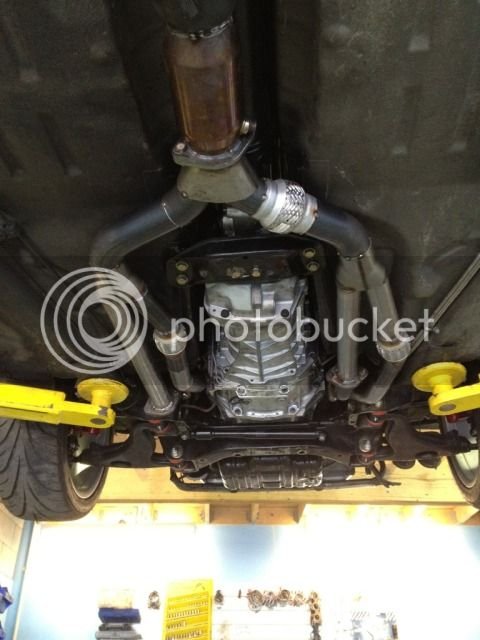

I was able to source another engine quite quickly. The decision was taken to move forward NA with a nice set of headers.
Here's the headers in kit form LOL! :D
There's been a few hiccups with this engine, but finally some results!
So, this:
+ this:
+ this:
= this!
