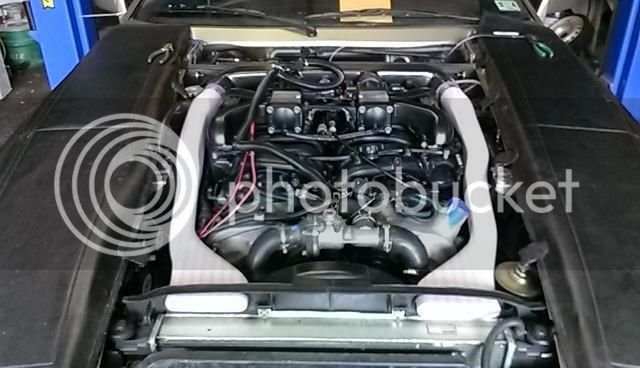

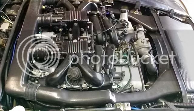

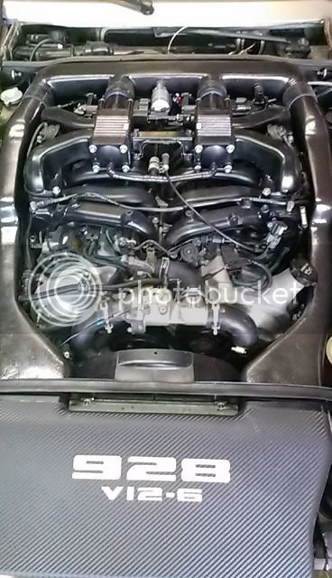

Reversed throttle bodies work perfect and custom linkage works with Porsche pedal

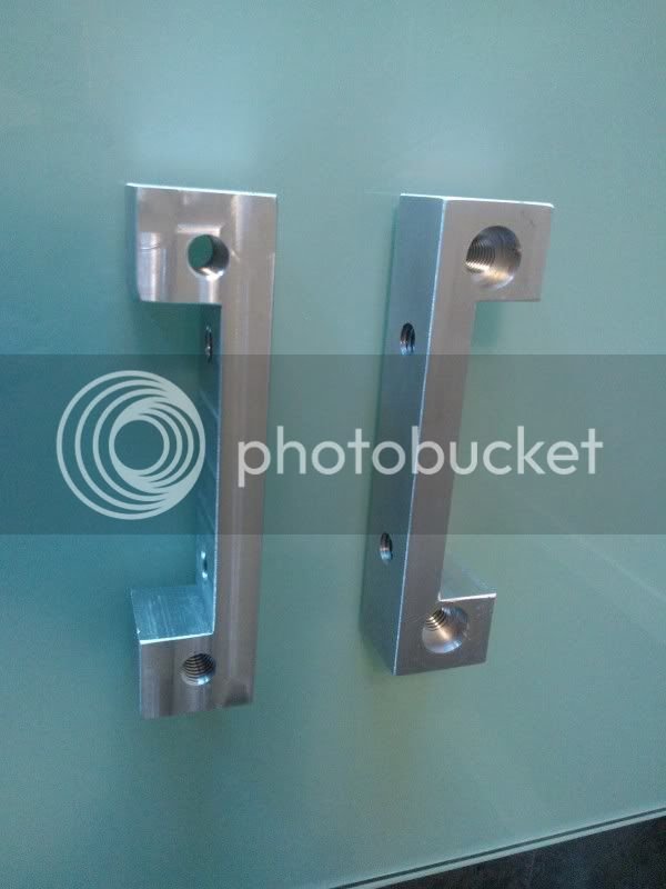

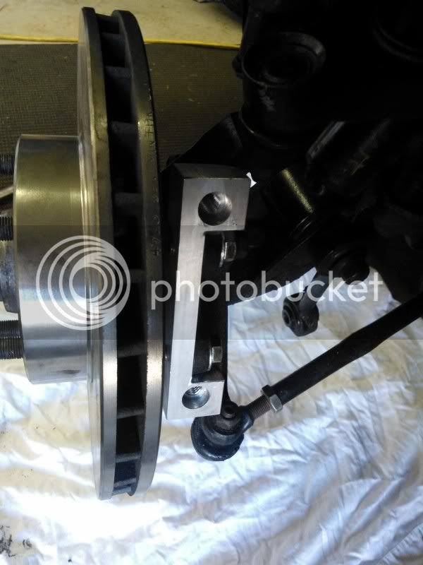

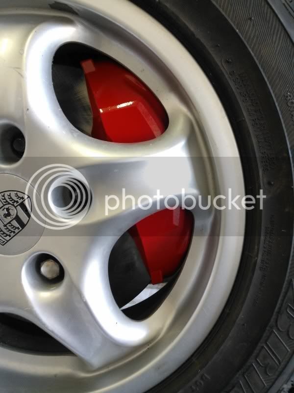

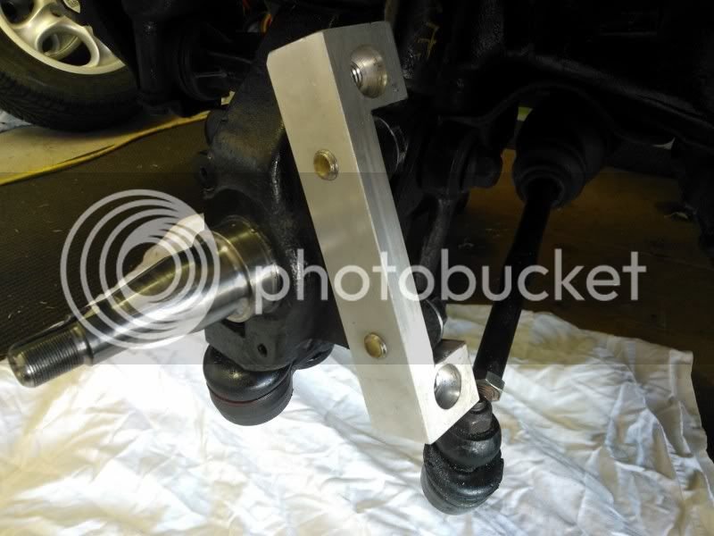

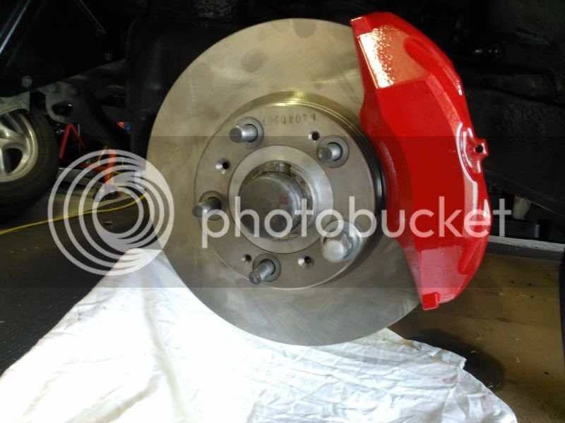

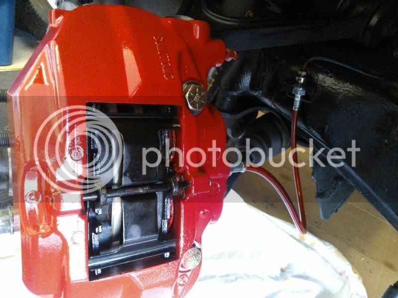

As far as braking technology, the factory 928 brakes are....factory... The LS-928 swap I adapted LEXUS LS430 monoblocks to properly put the stop to.... Again, better caliper build quality.....
16" *993 wheels fit the Boxster-S rotors with this caliper......
