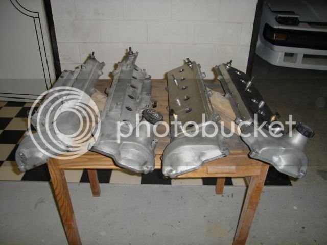

Not really into late model cars but i do appreciate the amount of work and modification skills going into this build. I also like thinking outside the square. Some nice polished billet covers over the coils would look nice with painted cam covers

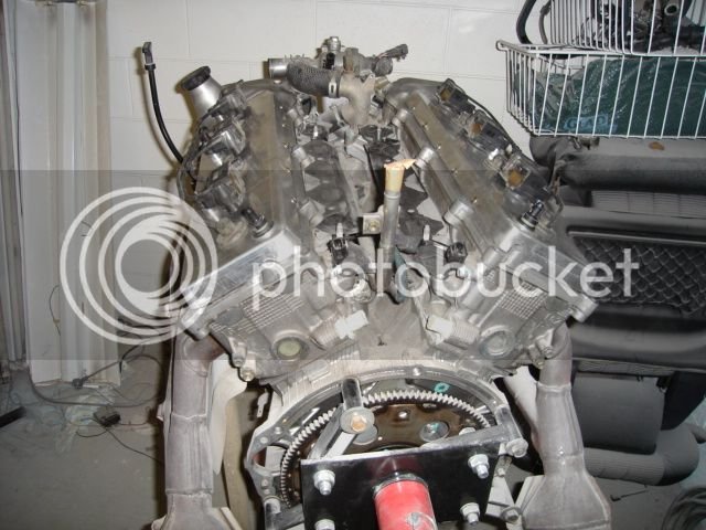

Hey guys, where do we get the dual clutch and flywheel from?
We'll be mating this V12 to a vette Torque tube and trans.
Thanks. I talked with Brandon and looks like well order the same billet flywheel as we did for the 1uz-944 swap.
Look for places that make flywheels & clutches for the 1UZ as they will bolt to the crank.
