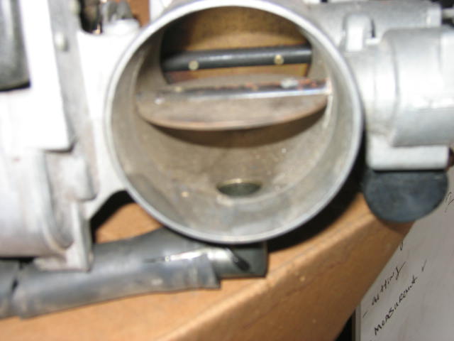

The passenger side crankcase vent into the throttle body via a 5/8″ x 5″ or so tube.  The vent pressure is exist via the throttle body and the crankcase pressure will vent into the engine (red circle on the left of the picture below).  The passenger side vent doesn’t have any check valve or PCV type of valve.  Its pretty much a straight connection.

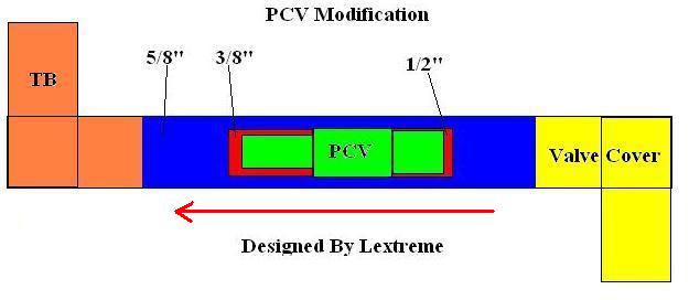

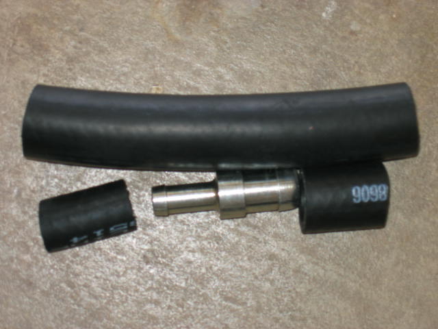

First thing, you should change your driver side PCV valve and its O-ring.  Ages O-ring or seal will leak pressure or cracked.  I highly recommend either you clean the pcv or replace it along with a new O-ring.  From my personal experience, the driver side will be great if you just replace the valve and O-ring.  However, on the other side will be little tricky.  I used to just plug up the connection between the vent and the throttle body.  What I found was not letting the passenger side vent is a bad bad thing.  Here is what u need to make it work:
  1. 5-6″ long 5/8″ tube
  2. 1″ long 3/8″ tube
  3. 1″ long 1/2″ tube
  4. 1 new PCV valve

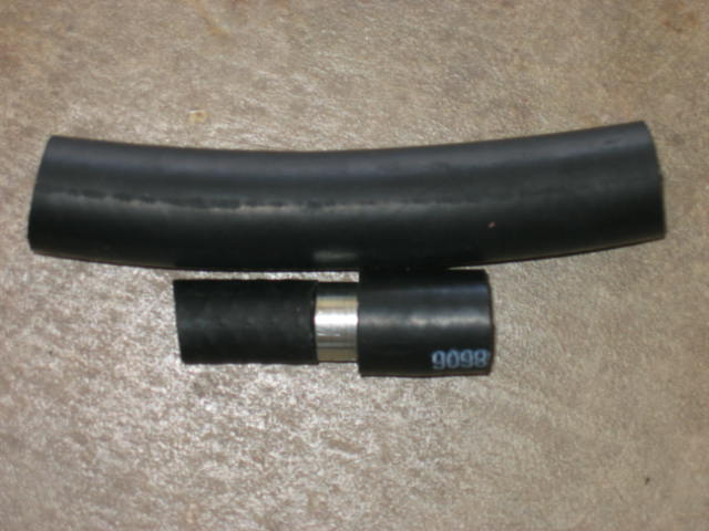

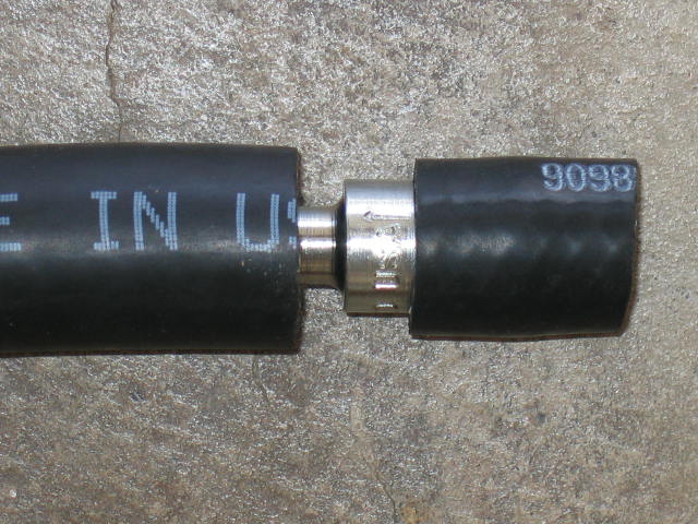

Placing the 3/8″ tube in the front of the pcv valve, 1/2″ tube on the rear of the pcv valve.  Now use some WD-40 inside of the 5/8″ tube and slide the whole pcv unit in the center of the 5/8″ tube.  Basically you are creating another PCV system on the passenger side.  Please see diagram below.
Once the pcv unit is inside of the 5/8″, now u need to find out which direction goes where.  You should try to blow into the 5/8″ tube.  Make sure the check valve venting into the throttle body.  Blow into it and see if air goes through.  If it does, the the piece from your mouth will be mounted to the valve cover vent and other side will mate with the throttle body.  Make sure you use worm or similar lock to tighten them.
This method work the best because the passenger side can vent crankcase pressure during idle and cruising.  At the same time, the check valve will also prevent increase crankcase pressure when at boost.  By doing this method, I noticed my car gain little more lower end response.  I can tell you some some stories about my experience with crankcase pressure.  From years of trail and error, this is the best solution for crankcase pressure in forced induction application.
