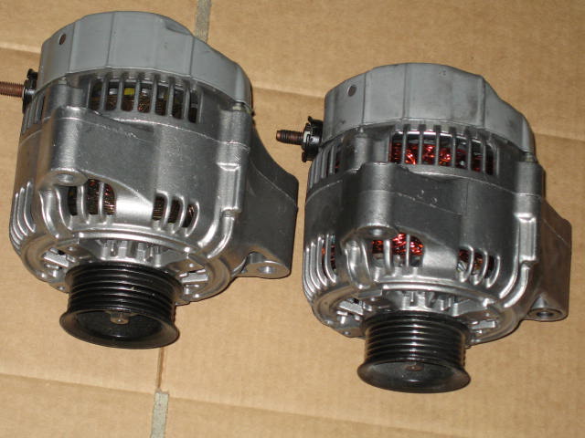

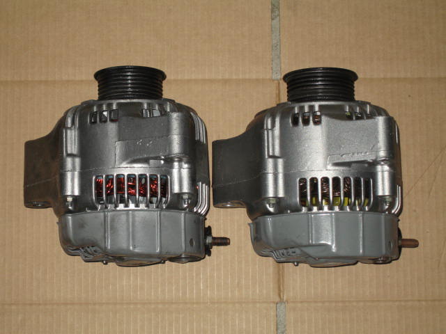

So here is goes, the early model LS400 and SC400 have the round plug and later models have oval plug.  Here are some pictures of the two alternators giving everything else is the same.
The left alternator has the round plug                                                                                   The right alternator has the oval plug

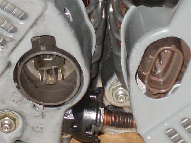

Here are two pictures of close-up of the two alternators side by side.
So which alternator do u have?  Here is the break down:
Model Year Alternator Plug
LS400 1990-1992 ROUND
1993 to 2000 OVAL
SC400 1992-1994 ROUND
1995-2000 OVAL
GS400 1998-2000 OVAL
I hope the above explanation would help you clarify what you have once you see it.
