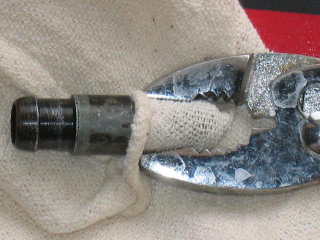

The pictures below are techniques how to take out the pcv.  If you plan to reuse it, make sure you use a towel and wrap around it and use a plier to pull it out.  This process will take little muscle.

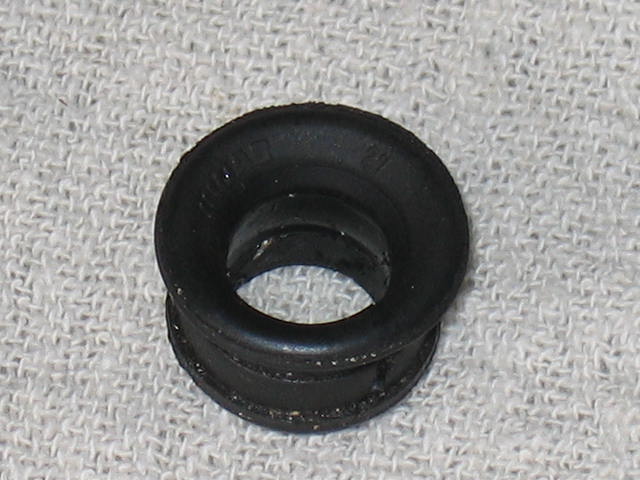

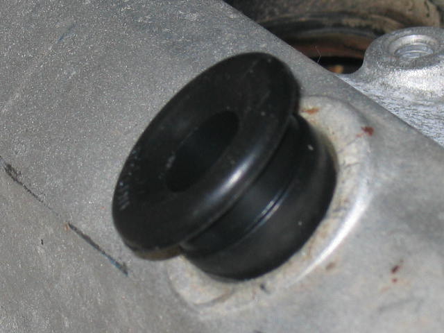

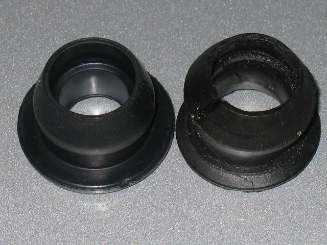

After you take out the pcv valve, you should also consider changing the o-ring.  Aged o-ring would leak and its best time to change both at the same time.  The last picture is a used and aged o-ring.  Be careful when taking out the o-ring make sure you don’t break it and pieces of the o-ring fall into the valve cover.  Best is to use two pliers and slow pull it out.

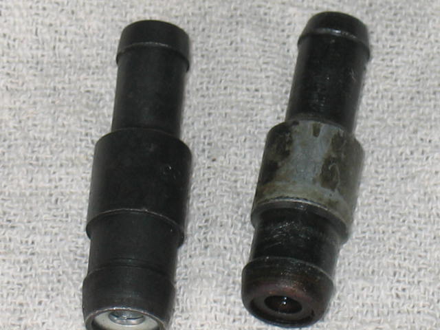

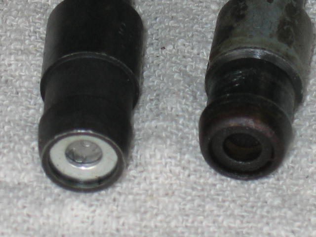

The pictures below are two pcv valves.  On the left is a brand new pcv from a local Lexus dealer and on the right is a used with residues build up.  On the far right picture below is a engine degreaser.  You need a degreaser and a compressor.

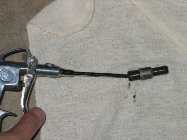

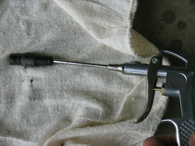

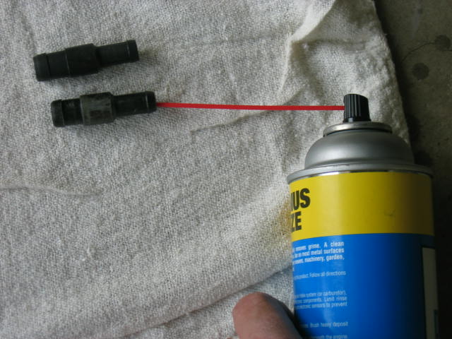

Spray the degreaser on both side of the pcv and shake it few times.  A compressor would be very helpful at this time.  Blow out all the crankcase vent residues.  Once its clean, the pcv is as good as new.  However, you can also replace old pcv valve completely.
Once the pcv is cleaned, you can now re-install it back along with the new o-ring.  In the middle picture is the comparison of new and old o-ring.  Use some WD-40 on the o-ring and it should slide right in.  After that, you can insert the pcv valve into the o-ring.  Now you can connect pcv tube back and you are all set to go.

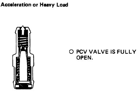

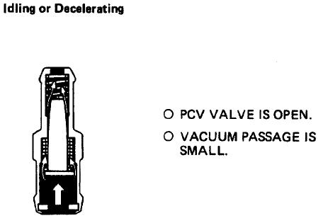

Below pictures are the normal function of pcv valve in a Lexus 1UZFE engine.  Good luck and have fun.
