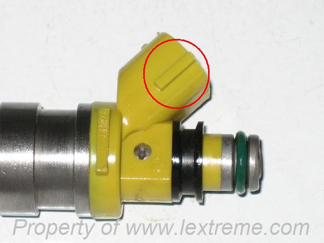

After reading those articles now you should have a pretty good picture why and what you need.  In this article I would like to show you how to modify the Supra Yellow Tip to directly bolt on to the 1uzfe engine.
Here is a picture of the two connectors:
Side by Side comparison of two injectors and clip guide
Here is a close up picture of the guide
You have to cut or grind these guides out in order for the stock clip to slide in.  Final product after cutting.
Here is how a stock 1uzfe (LS400) looks like.
Here is Supra Yellow Tip with 1uzfe clip.
As you can see, the clip is directly bolt on and locking too.  This upgrade will give you few additional psi and idle should be fine.  The stock computer should able to compensate.
