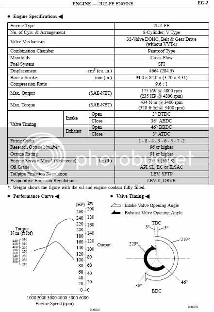

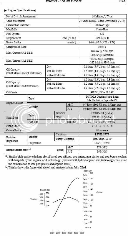

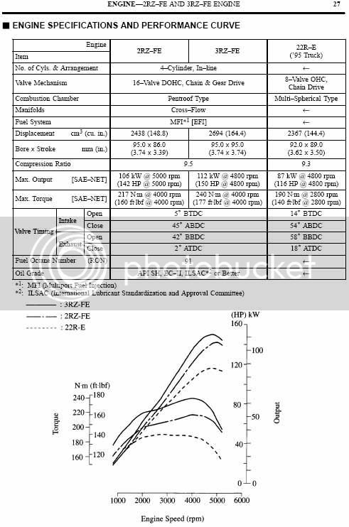

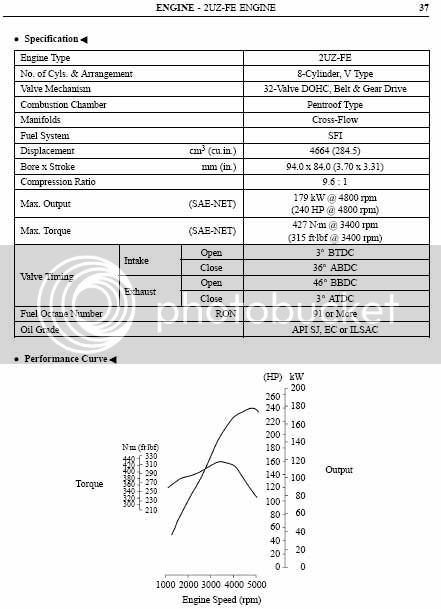

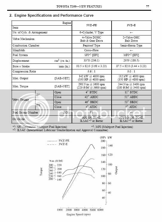

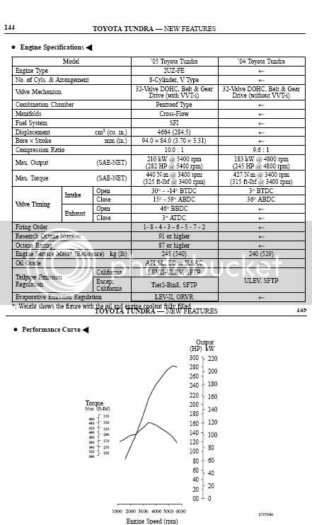

I spent alittle time looking at some things for you. This is the progression of Toyota truck engine power from '89+. What is going to greatly surprize you is the power the 2.7L i4 has, against the eldest of the truck v6's. The (dreaded) SOHC 3.0L 3vz-e.
That 2.7L isn't drastically short on power. It's no less powerful than the eldest v6, and there are a good number of people running those. Aside from that. The new 4.0L 1GR-FE v6 is a complete brute of a v6.
