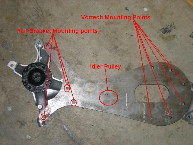

Khris and the gangs,
Here is something that will help you. Perhaps i can get some of the bolts for the fan bracket/Fish connection. Here is a picture that will help your project.
Let me visit a local bolt specialty sop and get you the proper size bolts.
It will look very similar to this with the exception of the top pulley near the water bridge.
attachment.php
