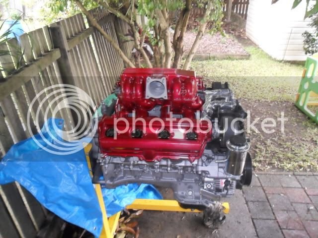

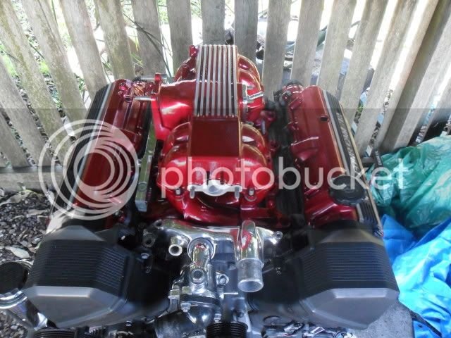

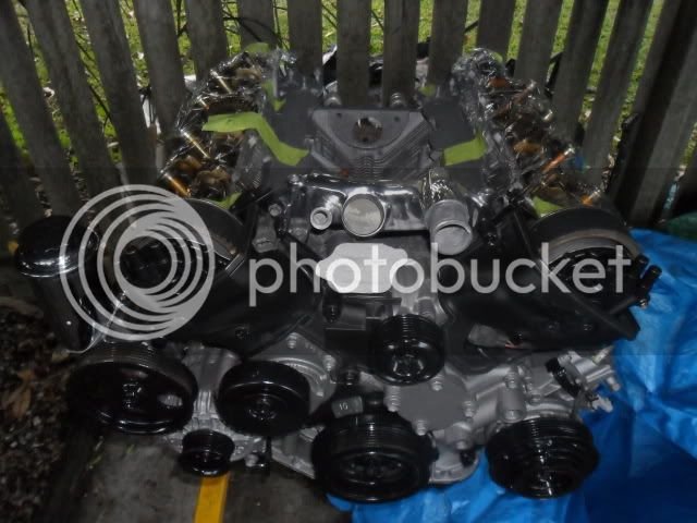

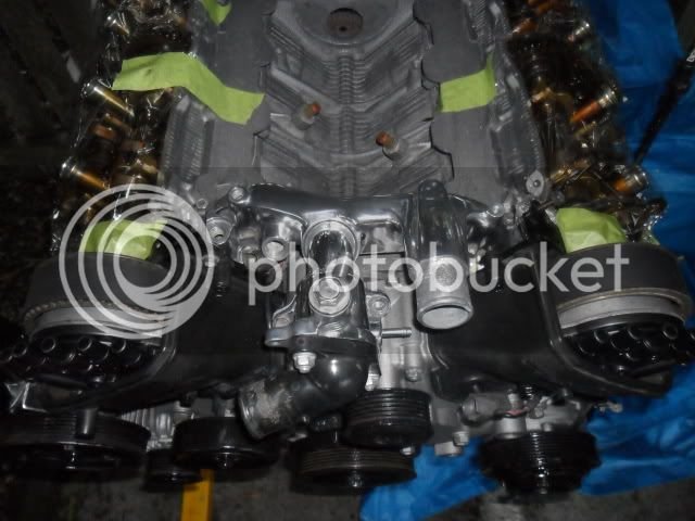

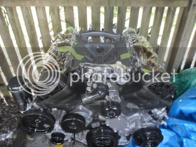

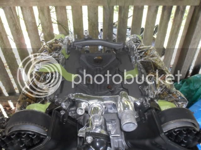

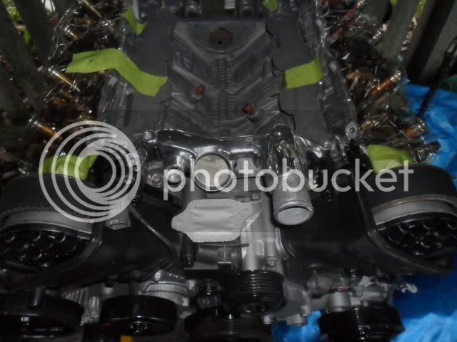

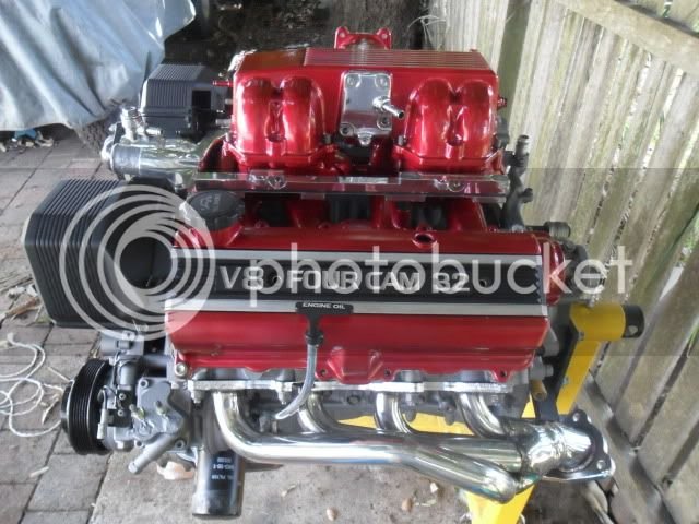

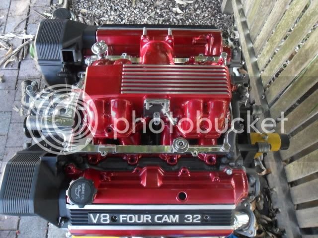

I finished off the thermostat housing today.
It's hard to get a good pic in the dark with a flash.

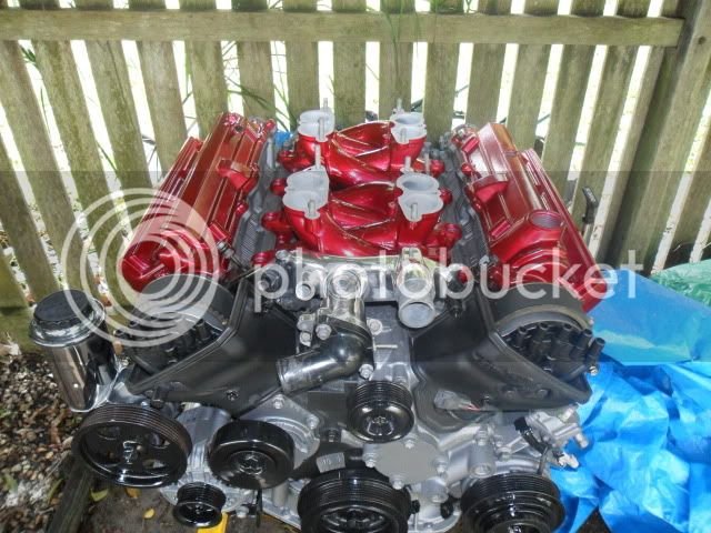

I smoothed out and painted the rear water bridge, I was going to polish it, but you can't see it with the engine in.

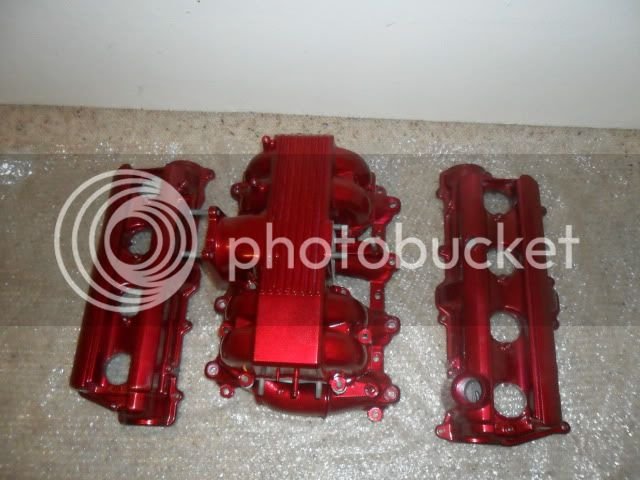

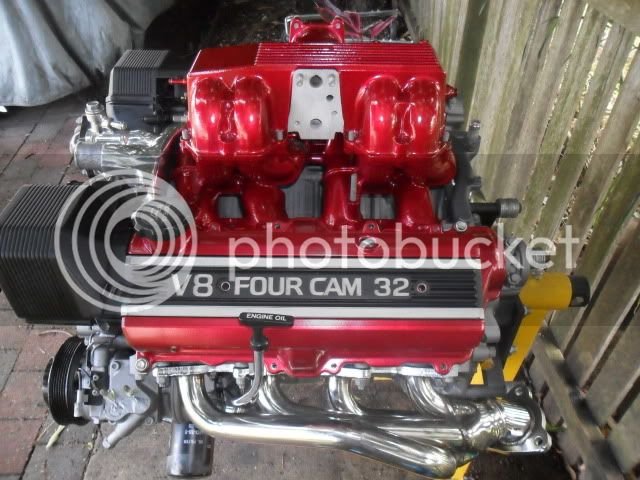

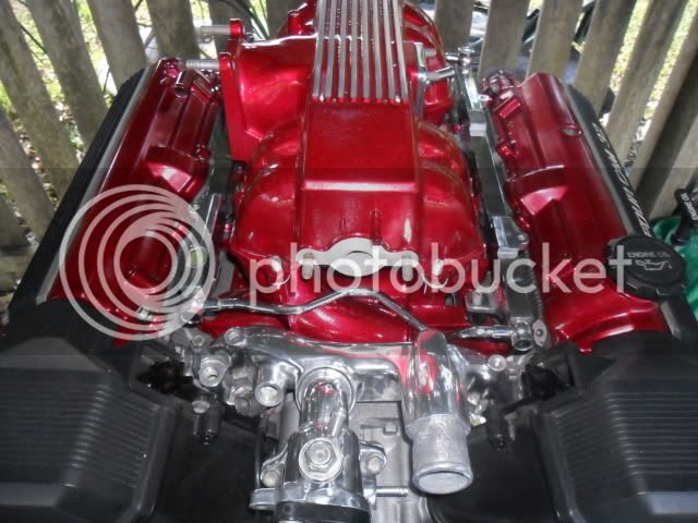

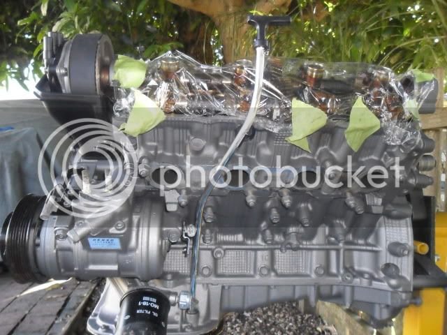

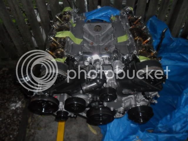

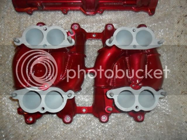

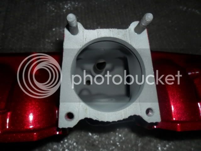

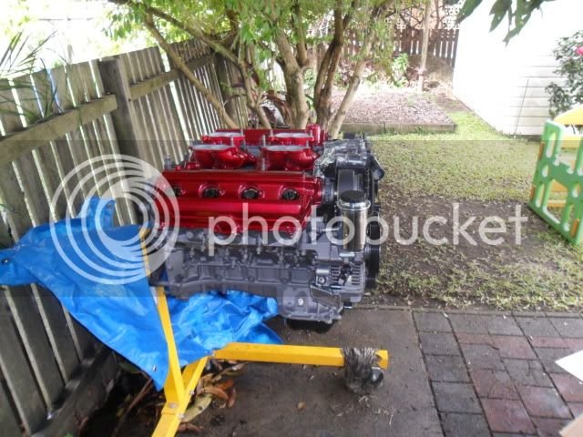

I got the bits back from powder coat today, it's too bad it was raining, I can't wait to see them in the sun.
I ended up using High Octane Performance Coatings in Rydalmere, after sending out 5 emails to different places, they were the only ones that replied.
http://www.performancecoating.com.au/

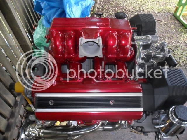

I'm pretty impressed how clean they are inside as well.

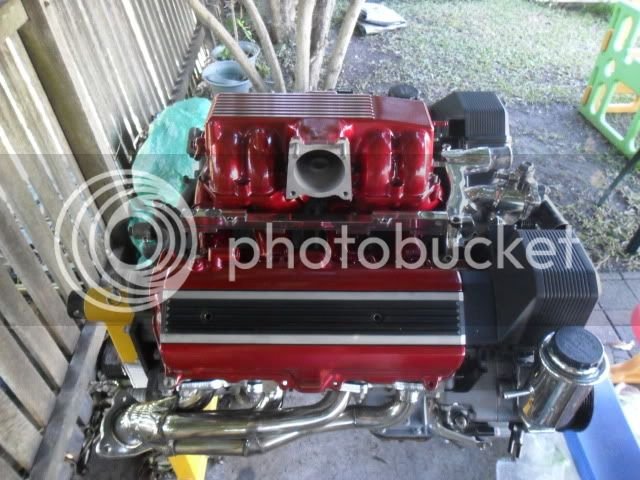

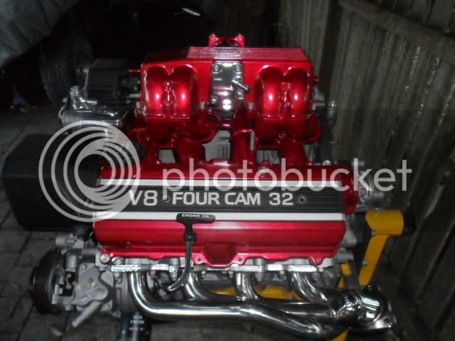

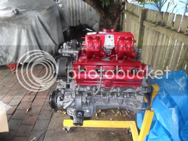

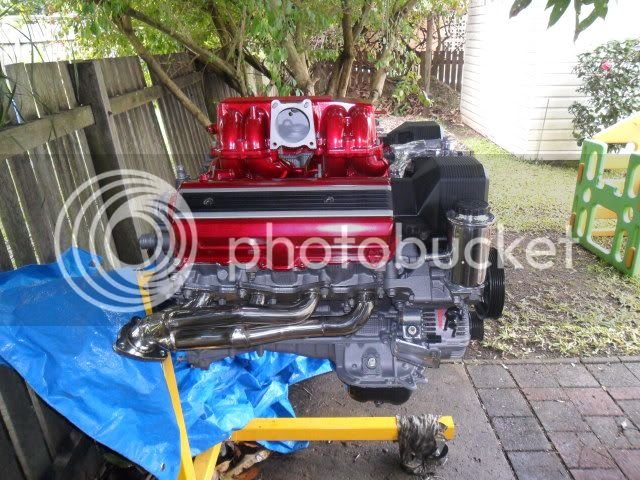

I finally got enough of a break in the rain to put a few bits on, I guess I will have to wait for the sun.

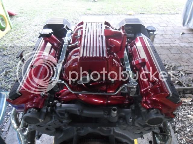

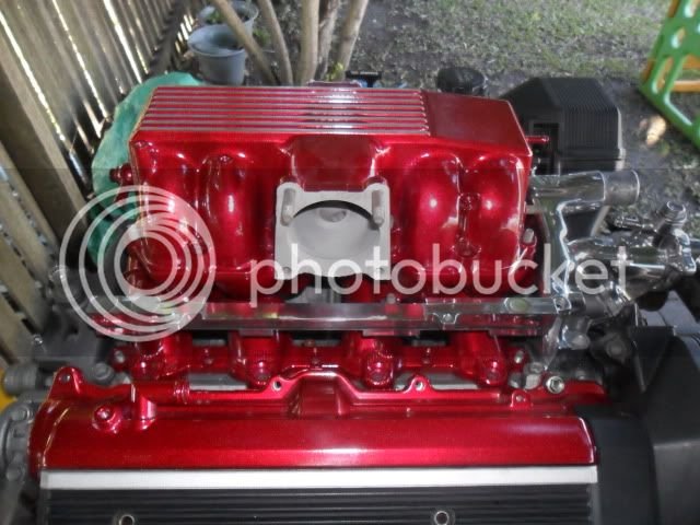

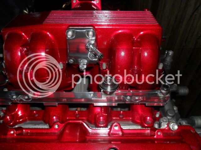

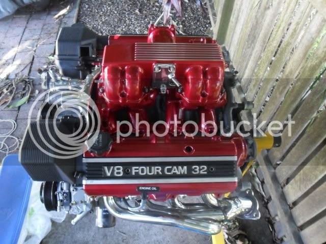

I got one of the fuel rails polished today, it took a bit longer then I was expecting, for a billet rail they have some pretty rough castings in them.

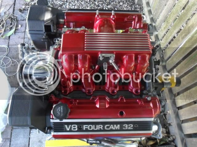

I also got some better pics of the manifold ribs.

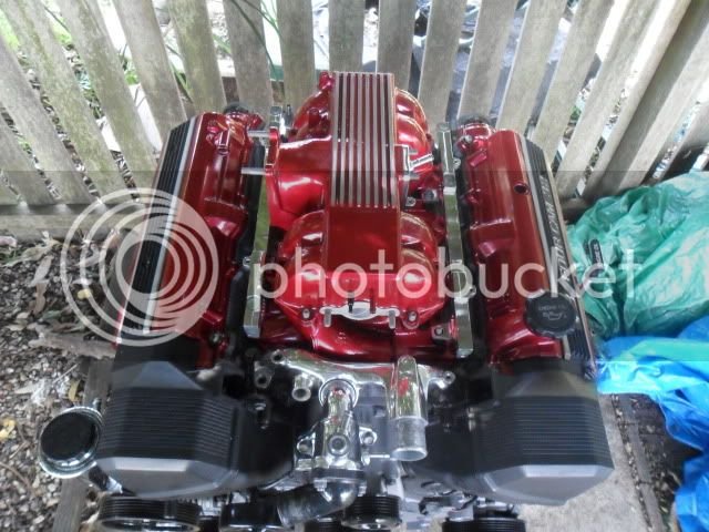

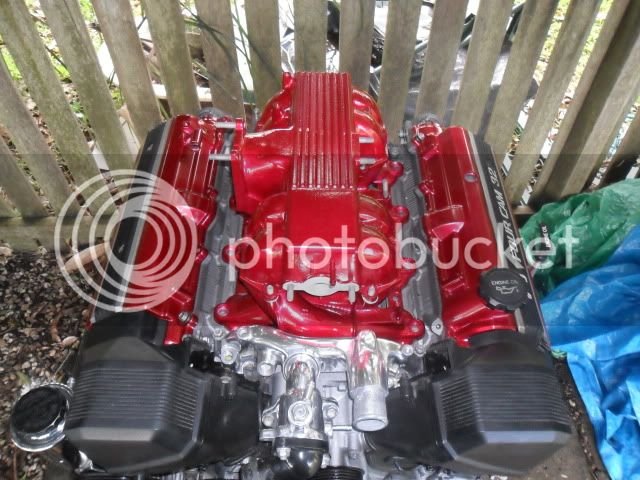

Your motor is looking fantastic. I never have that much patience to make one that tidy. I hope it goes as good as it looks. Cheers

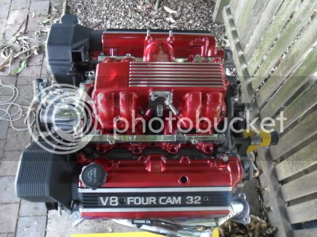

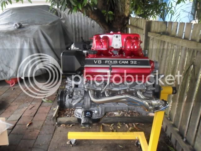

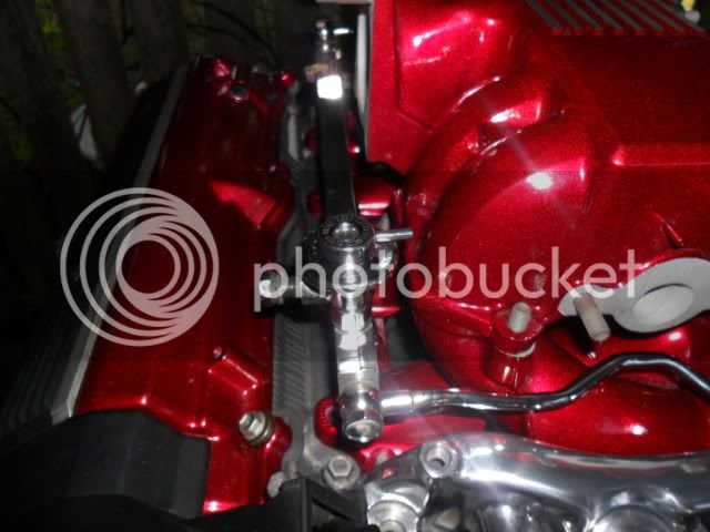

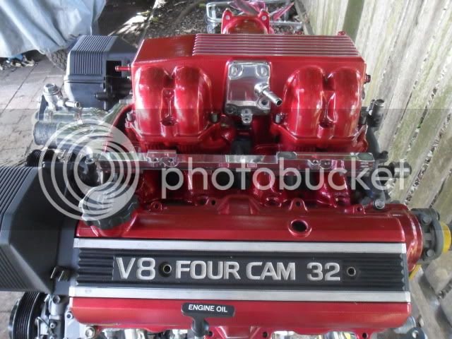

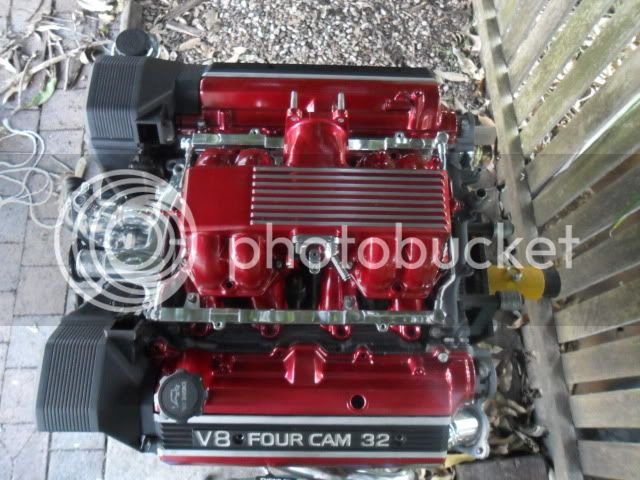

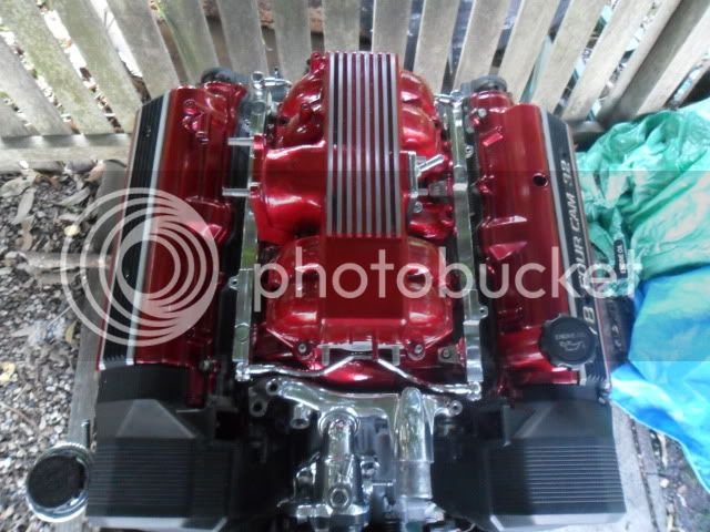

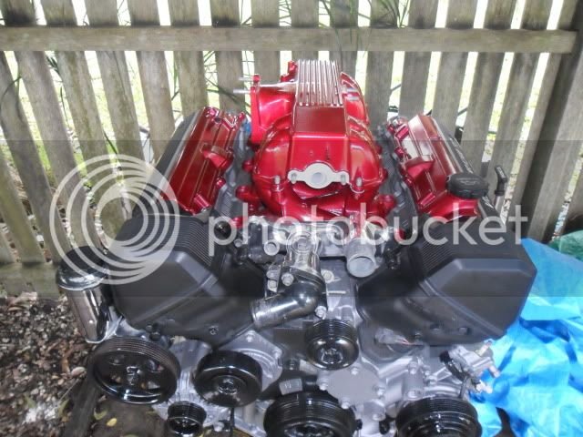

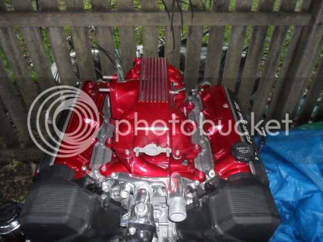

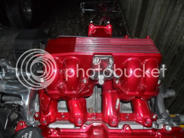

I had the day off today, so I got the reg and damper polished.
I almost got the colour of the paint in these pics, except the metallic looks like bright yellow spots, and everything else looks dull.
