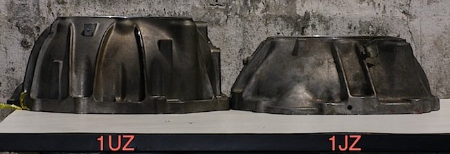

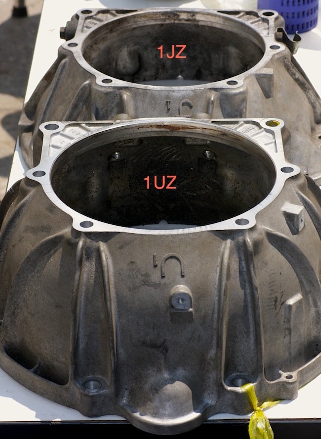

The 1JZ and 1UZ bell housings have the same trans bolt pattern, so a 1JZ trans will bolt right up . . . . they look look the same . . . . .
. . . but the 1UZ bell housing is taller/thicker than the 1JZ bell.

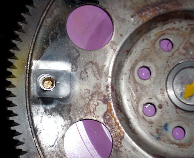

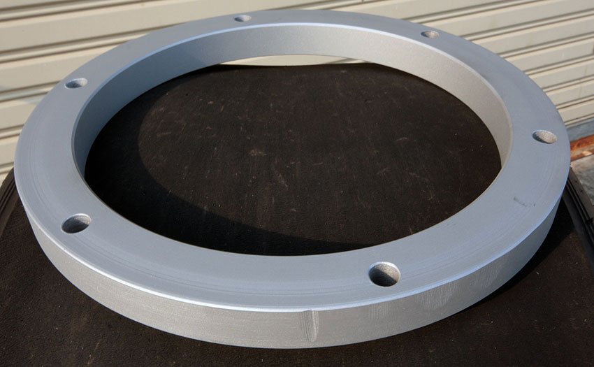

You need to make a "drive ring," like the one above, to space the torque converter so its internal splines properly index with the trans input splines. As you can see, this drive ring allows one to bolt the converter to the drive ring with one set of holes, and then bolt that assembly to the ring gear with the other . . . or as I did, since I had already modified the 1UZ flex plate to accept the 1JZ torque converter bolt pattern (less than 1/8" difference, as depicted below), I used three high quality bolts all the way through the flex plate and through the drive ring into the torque converter mounting pads. A last piece, not shown, is an extended "pilot bushing" for the end of the crankshaft that captures the knob at the end of the torque converter to supply support to the input shaft/torque converter assembly.
The 1JZ torque converter mounting bolt pattern is not exactly the same as the 1UZ torque converter bolt pattern. As can be seen above, the bolt circle is slightly smaller in diameter.
