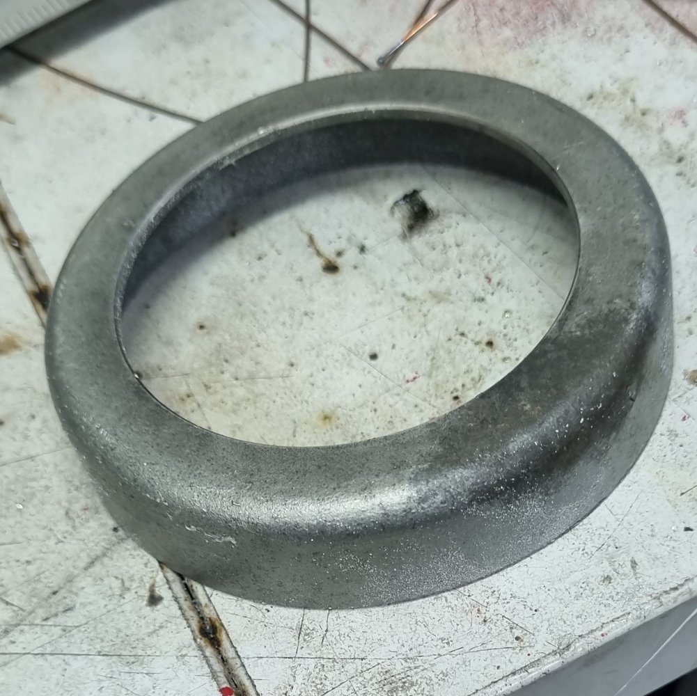

I'll bet then you must be their 2nd customer to have purchased these. PRP have now released an update they label as V2 after I told them about the problem. I'm guessing you haven't installed them yet either as you would have picked the problem. You will need to do a comparison between the OEM gear and the PRP ones. You will find that the right hand gear is fine, whereas the left hand gear has the trigger tab for the cam angle sensor 90 degrees retarded. Easy fix you might say just remove the screws rotate the trigger ring and refit. Well the problem with that is that only 2 screws line up, the other 2 don't. The fix is that PRP have now drilled new outer gear to fix the problem. Next issue is that you can't fit the cam sensor mounts back to the engine because they fowl on the gears. Picture below shows you what I machined off.
