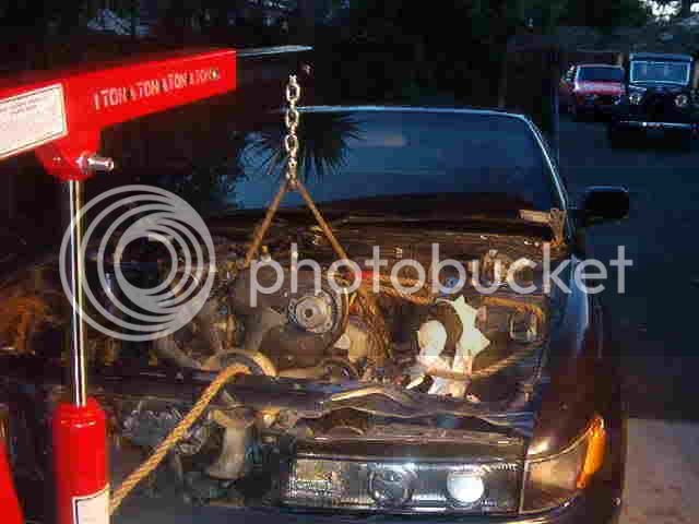

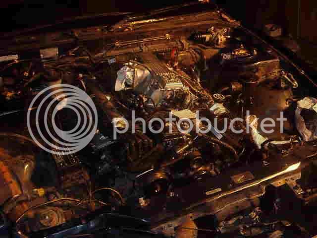

Hi all here are some pics of my engine and w55 box to go in my s13 silvia. The engine is a 98 Aristo engine, just changed the timing belt, what a job glad the engine was on the floor wouldnt like to do it in the car! By the way someones selling 1uz timming belts for $75 on trademe.co.nz very cheap considering its a genuine toyota part. Repco quoted $350 or something crazy. Im waiting on a 4 puck clutch and pressure plate and then Ill be putting her in the car probably in a couple of weeks. Thanks to everyone, Ive found a lot of good info on this site.
It will mainly be used for drifting as I think the torque should make it pretty easy to get sideways. Im running a LINK lem with the new V5 software and a mitsubishi two channel igniter.

I dont think you will have much trouble drifting, in fact if you can keep it in a straight line I will be amazed. How much room is left in the engine bay, have you measured?
Yeah I did a quick measure seems to be fine. There is a guy in aussie with a nissan vh45 v8 in one and they are a lot bigger so I should be ok. Im thinking about going to a twin throttle plenum but I might just get it going first. Twin turbos are also in the back of my mind but that depends on what the NA performance is like.

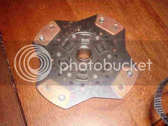

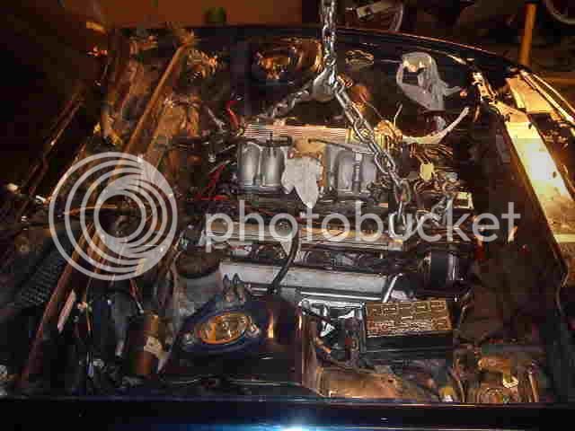

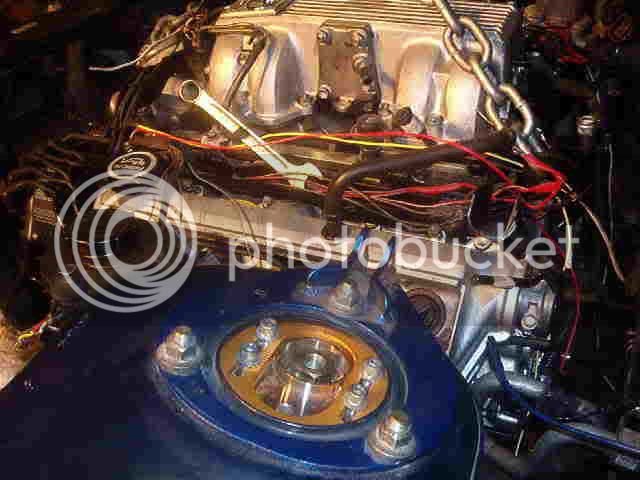

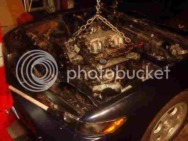

Ive got my clutch and flywheel done now Ill post some pics tonight. The clutch is a brass 4 puck unit which will be grabby but should stand up to some punishment. It cost nz$350 from clutch systems in Christchurch. My flywheel is a 3sgte unit with a machined lead in on the ringgear and redrilled holes. It cost $100 plus $100 to machine it. my adapter plate cost $350 and the w55 was $100. So allup to convert a 1uzfe to manual it shouldnt cost more than $1000.
My old man has a tig welder so Im planning on modifiing the alloy mounts that come off the block. Imm going to sit the engine in tonight so Ill let you know.
U are using W55 tranny with which flywheel? I am getting a R154 tranny and trying to find out more info on the flywheel and a strong clutch.
Im using a redrilled gt4turbo/sw20 mr2 flywheel with a lead in ground on the other side of the ring gear for the starter motor to engage. It works out really well. then u can use gt4/mr2 performance clutch and clutch cover with the w55 clutch fork and I think a nissan thrust bearing.
