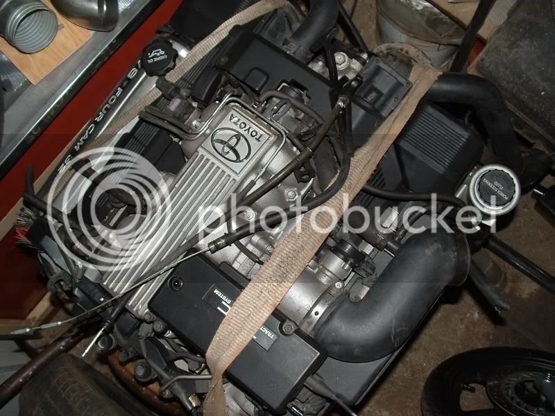

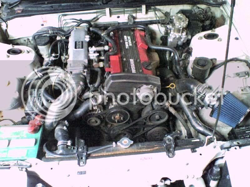

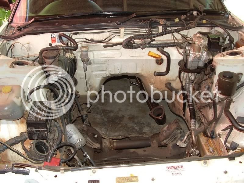

I've decided to fit the 1UZFE into my 180sx, I've seen a couple here on the site and it has helped me a lot. I'll be removing the CA18DET engine the weekend and start cleaning out the enginebay of all the crap.
I'm going to stick with the autobox for now because this will mainly be a normal "streetcar".
1. What I've seen it that I need the LS400 engine with the sump at the front.
2. Autobox controler.
3. I'll be using a standalone management for the engine
This I'm still not quite sure about is what shifter I can use for the autobox because finding the original one here is impossible.
How to make the speedometer work with the autobox.
Any other advice will be greatly appreciated.
