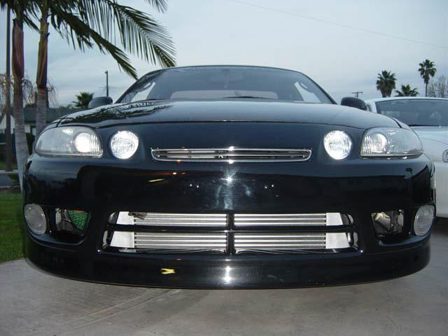

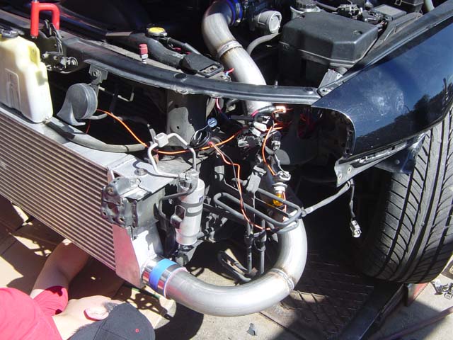

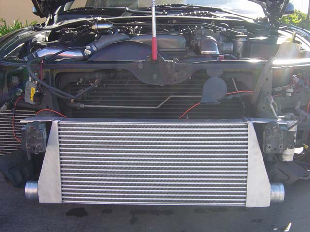

With the front bumper removed and all those misc. wires move to aside temporary, we managed to uninstall the front bumper in less than 30 minutes. We made few mock installation and the intercooler fit perfectly. If an additional 1/2″ in any direction would be too big and lots of cutting would be involved.
The intercooler is 12″ x 32″ x 3″ with 3″ in and outlet. This is a custom made intercooler specifically for the SC300/400. Beside the huge front mount intercooler (FMIC), we also redo all the pipings. Take a pictorial journey with us and enjoy:
