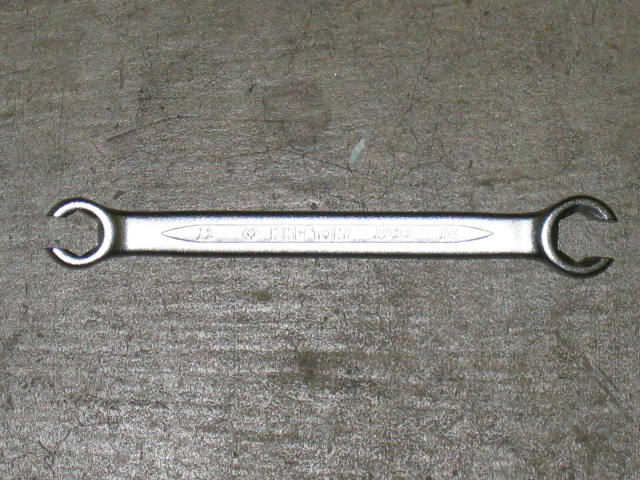

  • 19 mm wrench
  • 14 mm wrench (Flare Nut Wrench is PREFERRED)

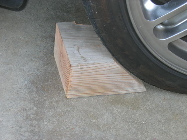

      1. The best way to attach this task it to jack the car up on the rear driver side with tire chocks in the front tires.  Once the car is jacked up, then u should put in a jack stand for safety.

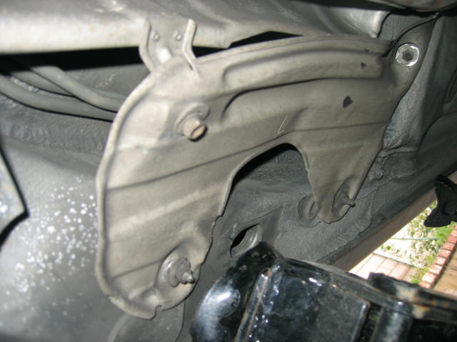

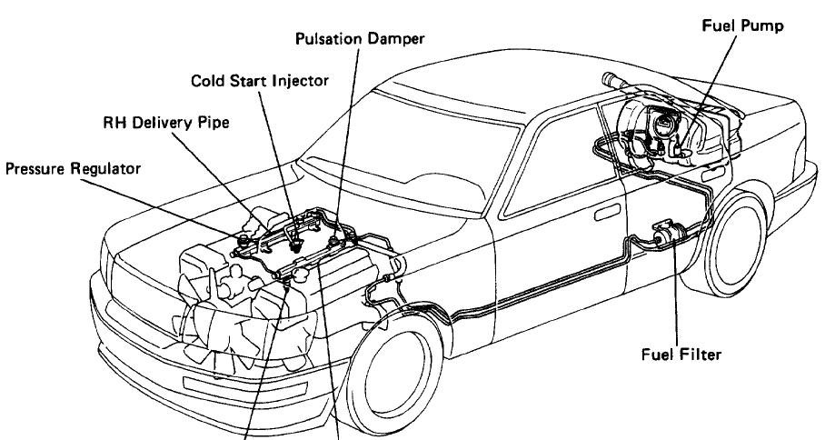

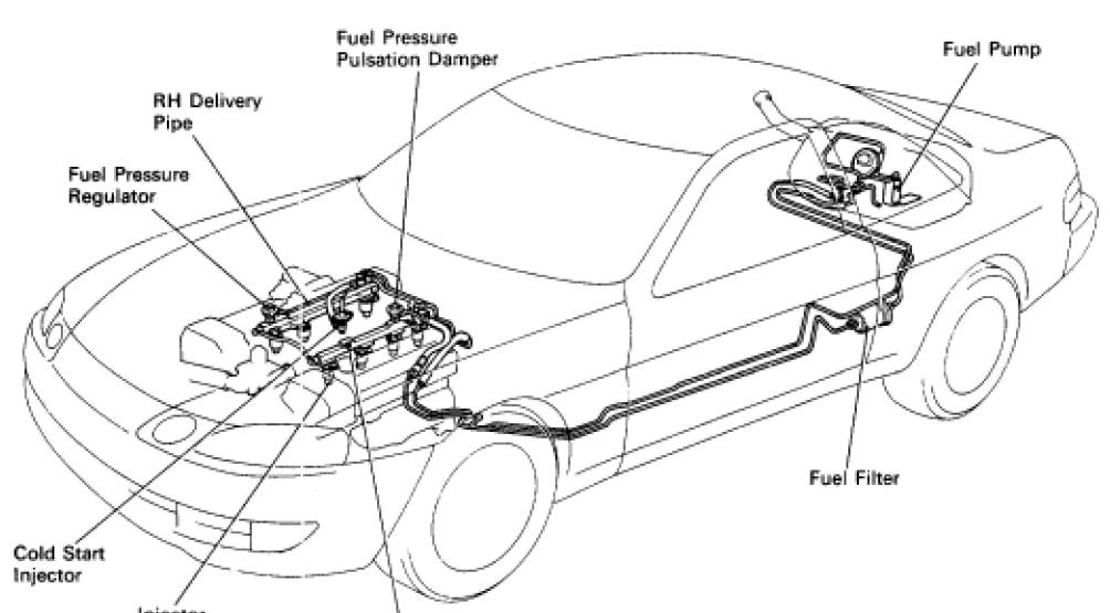

    2. The fuel filter is located under the car.  Its on
      the rear driver side of the car.  Its right in front of
      the driver side rear tire.  There is an aluminum plate
      covering it.  The plate is held by 5 10 mm nuts.

    4. Its an inlet fuel filter with one entering and one going
      out.  Now you will need the 19mm to stabilized the
      filter and 14mm to loosen the fuel line.  You need to
      loosen both inlet and outlet lines.  Once the filter is
      out, you will need to loosen bracket with a 10 mm.

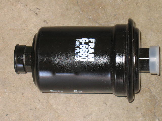

    5. Now you are ready to install the new fuel filter.
      Make sure the ARROW is pointing from the REAR to the FRONT.
      Basically the large end is at the rear and small end will be
      pointing to the front.  Look for the ARROW for
      indication.  The best way and easiest way is to loosely
      screw in the fuel lines first (not tighten), then you will
      need to install fuel filter and bracket back with two 10mm.
      Tighten the two 10mm then tighten the two 14 mm fuel lines.
