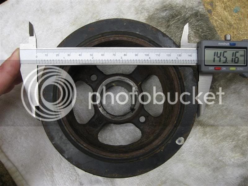

PWD, just a minor point - where did you take the 145mm measurement for the stock crank dampner?
If you used a set of calipers, I'm thinking you probably measured the lip of the pulley as I did below:

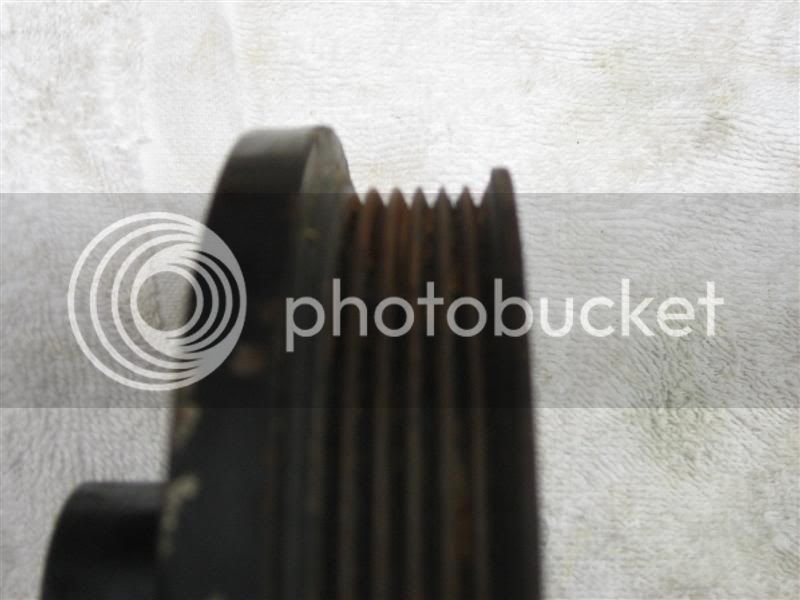

But if you notice, this outer lip is a bit larger than the grooves of the pulley themselves, (presumably to keep the belt from jumping the sheave?):
I then used a diameter type measuring tape to measure around the outer circumference of the grooves and got 5.53 inches or 140mm:
