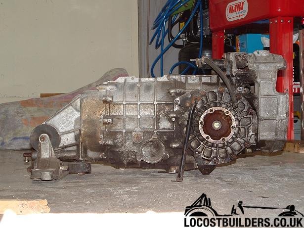

A very good condition Porsche 964 911 G50-03 non LSD, 38.000km old, ex front end collision scrap car.
with the 18" on the standard T70 and the max RPM I'm chassing I'll look at a top speed of about 280 to 290km and hour, if I can strecth the RPM scale by another 1K rpm upto 7000Krpm I'll be breaking the (to me) magical 300km/h barrier.
I'm cleaning it at the moment, and boy I'm glad that porsche don't have these boxes cast in sand.... they did lost wax so the surface is very neat and smooth makes for easy cleaning, though I did allready spend about 6 hours on it I've only done one side....... don't you hate casting ribs aaarrgghrhh :rant:
QUESTION: should I store this box with or without oil in it? won't see action for a few years to come probably
detailed measurements of it are in the swap and conversions section, the top sticky post.

Thomas,
With oil and turn the drive flanges every month or so.
It may rust without the oil and the oil will eventually drain off the top of the upper gears and the top of the crown wheel and they may rust.
Turning the flanges keeps fesh oil on all the gears.

Store the gearbox with oil in it and just turn it over every couple of months.
Put it up on some wooden blocks to insulate it from the concrete.
Give it a clean with some alloy cleaner and then spray it with silicone oil spray, the oil will soak into the alloy and stop any oxidation.

Thanks guys,
should I put fresh oil in it now, or just leave the old stuff in it?
ps itll be on a dolly to keep it of the floor and probably covered with one of Mrs Striker nicest bath towels, the box was more expensive than she was last year hahahah.
grtz thomas
I would drain the old oil out and check for any lumps or bumps in it and then put fresh oil in so it's ready to go, one less thing to worry about.
Be nice to Mrs Striker or you may find that it's not that much fun to cuddle up to an engine and gearbox.
haha it will take a lot more than ruining a nice towel in our home to get her unhappy, she even volunteered to get the gearbox out of the trunk of my honda accord all 70kg+ of it at 23:00 in the rain I might ad!
anyway fresh oil and top it up fully then drain the exces when it goes into action.
