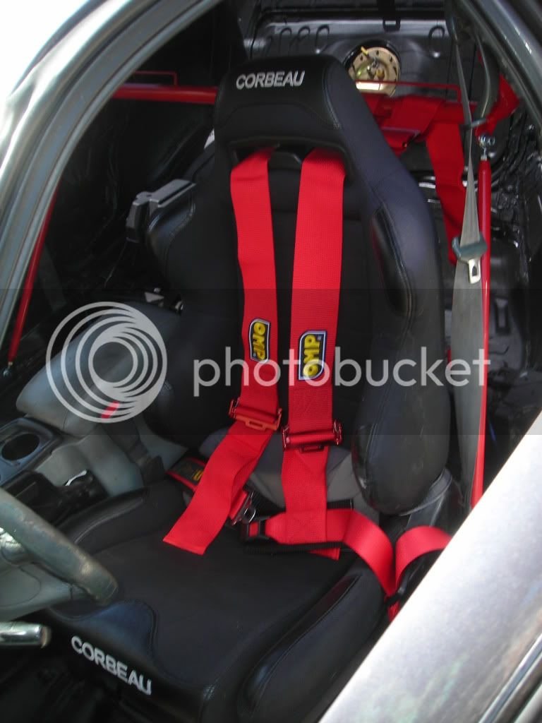

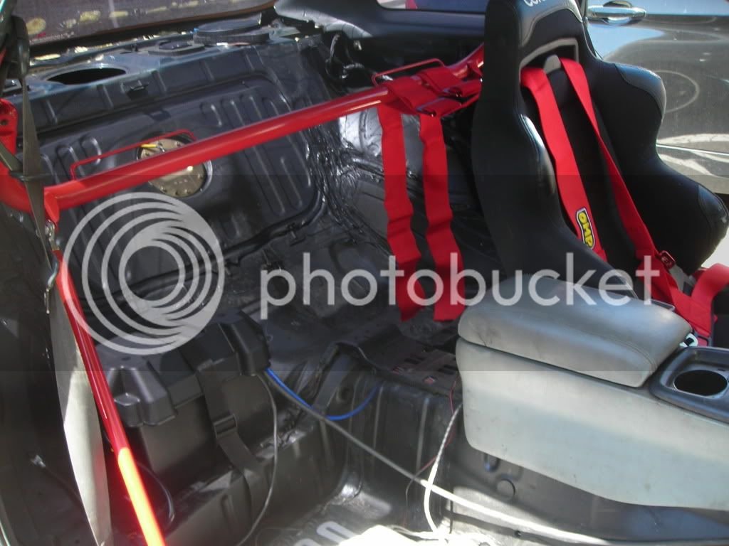

Just installed a $100 ebay harness bar and a new OMP 3" 4-point harness. I must say these are a 200% increase over my 2" 3 points. I feel like someone put me in a straight jacket as soon as im in. Zero movement whatsoever. I have a pair of black Neoprene harness pads coming next week but overall the entire upgrade was worth it. I also noticed some increased chassis stiffness as well.
