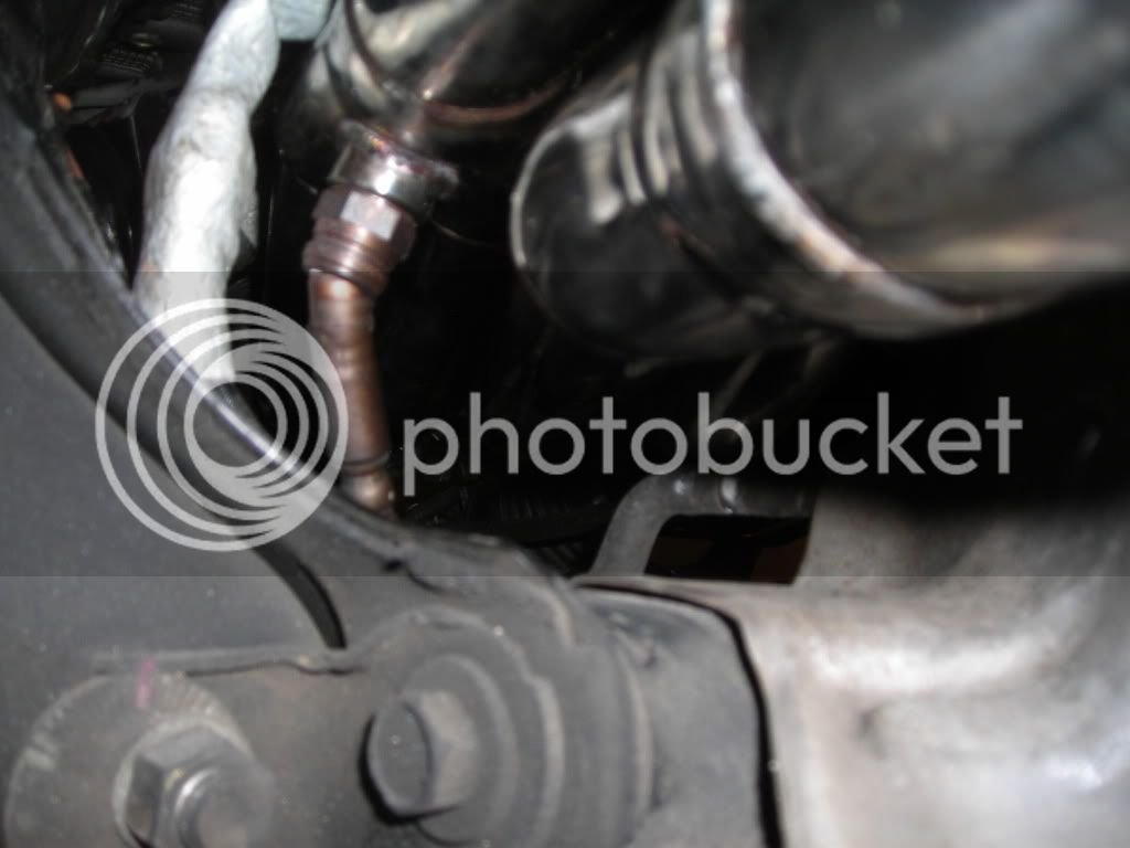

I wish the forum could bring back the "edit post" feature. I always remember details just after submitting. Anyway I just want to say that the stock Toyota Denso O2 sensors are pretty darn reliable. My header O2 bung is oriented incorrectly and it aims down into the crossmember. I bent the sensor while dropping the engine into the car and once bolted up, the sensor still works even though its bent into a 110 degree curve. I slathered the body/tail section merge with JBWeld and the entire unit is air tight again. Its voltage is the same as the stock driver side sensor. I heard about 2JZ sensors being bent to suit clearance issus so I figured why wouldn't the UZ sensor take well to a bend?
This was taken BEFORE the JB weld, but thats all it needed. Cant bear early generation engineering.
That O2 sensor looks like it may give up soon. lol. Bad position on the bung there. If you don't care about the look, you can extend the 02 bung and use the OEM sensor. You can go to a hardware store, buy a 90 degree steel pipe fitting with the diameter of either 3/4" or 1" and the length of about 1". 1" diameter is better. That fitting is used for house plumping. Take it to an exhaust shop and have them weld it to the header O2 bung. Then weld another O2 bung at the end of that extension. Then you can plug the OEM sensor to it.
As long as the exhaust gas can reach the sensor, it'll be fine.

Steve, that pic is a bit off, once I bolted the motor mounts, the sensor now has an inch of space from itself and the crossmember. Its currently perfectly sealed, putting out an exactly matched voltage signal as compared to the other side. I have a pile of OEM sensor in my garage so I think i'll wait and see how many rounds it can endure. 2JZ guys bend them to fit 4"+ downpipes sometimes.
