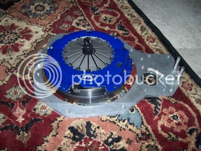

well Node I am possitive I will have the clutch, flywheel installed when you get here! I was hoping to have power at my garage last month but its gonna be next month before I can! :( anyways I have to source a E153 tranny from a solara and TRD or stock 93 LSD for my trans. In the meantime Im going to bolt up the adapter to the bell housing to drill the holes so once I get the gears in the trans its ready to bolt to the motor! Second issue is the alt location! I will address that issue soon!

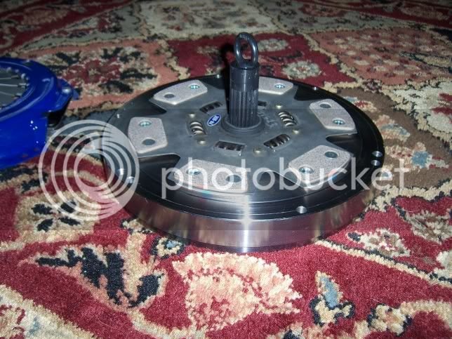

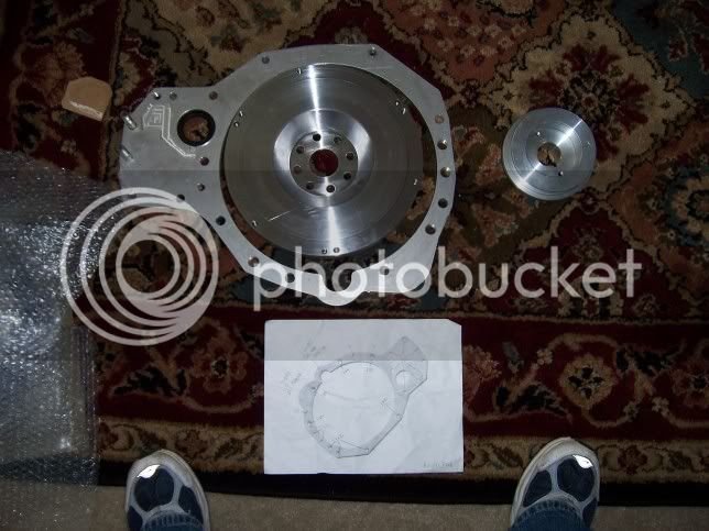

I have my underdrive pulley, and my adapter, and my flywheel!
This week I must...
Machine the flywheel and add ring gear from SC400 (lots of work for someone like me).
Machine the adapter plate, counter boring some holes, then counter sinking the other holes, and a possible resurface jsut to be on the safe side!

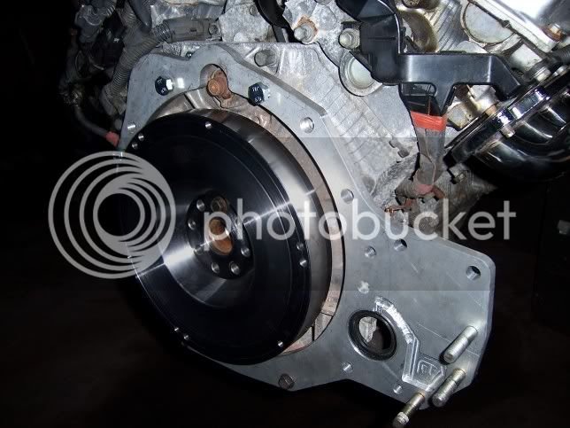

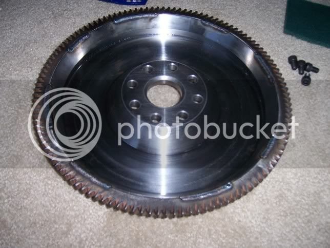

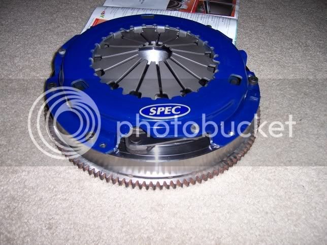

the flywheel is finished!!!!! The ring gear was cut off the factory starter plate and then pressed and spot welded to the flywheel disk.... so this is what happened next.

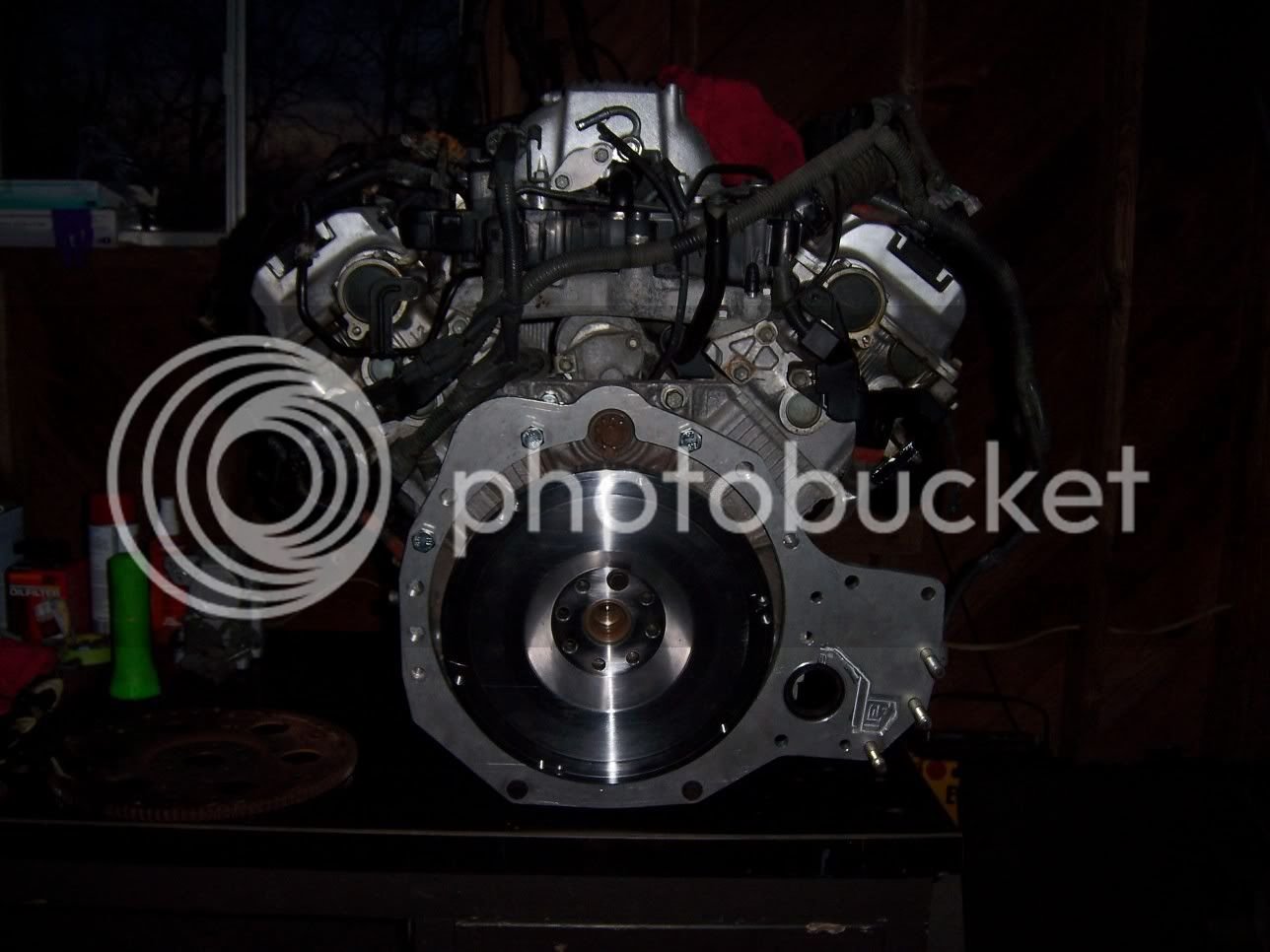

One last picture with the Spec Stage 3 clutch pressure plate sitting on the finished product!

Today I put my flywheel on, it was to close that the starter gear was touching the flywheel gear, can someone please tell me how man MM the starter gear should be from the flywheel? I think I was missing my plate spacer, now when I use pliers I can pull the gear to the flywheel, but they get sorta stuck, it still might be to close. THE LAST THING I WANT TO DO is take that thing right back out of the car over something so simple. So if anyone has a 1UZ with the torque converter still on it I'd appreciate a measure.
