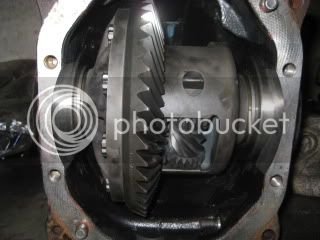

[URL="http://i164.photobucket.com/albums/u12/bj_on_roids/Arnout%20Van%20Der%20Kamp%20Single%20Turbo%20LS400/IMG_4360.jpg%5B/IMG%5D"]http://i164.photobucket.com/albums/u12/bj_on_roids/Arnout%20Van%20Der%20Kamp%20Single%20Turbo%20LS400/IMG_4360.jpg[/URL]

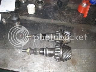

[IMG][URL="http://i164.photobucket.com/albums/u12/bj_on_roids/Arnout%20Van%20Der%20Kamp%20Single%20Turbo%20LS400/IMG_4359.jpg%5B/IMG%5D"]http://i164.photobucket.com/albums/u12/bj_on_roids/Arnout%20Van%20Der%20Kamp%20Single%20Turbo%20LS400/IMG_4359.jpg[/URL]

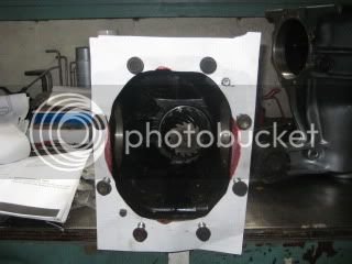

[IMG][URL="http://i164.photobucket.com/albums/u12/bj_on_roids/Arnout%20Van%20Der%20Kamp%20Single%20Turbo%20LS400/IMG_4358.jpg%5B/IMG%5D"]http://i164.photobucket.com/albums/u12/bj_on_roids/Arnout%20Van%20Der%20Kamp%20Single%20Turbo%20LS400/IMG_4358.jpg[/URL]

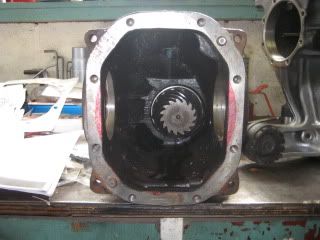

[IMG][URL="http://i164.photobucket.com/albums/u12/bj_on_roids/Arnout%20Van%20Der%20Kamp%20Single%20Turbo%20LS400/IMG_4357.jpg%5B/IMG%5D"]http://i164.photobucket.com/albums/u12/bj_on_roids/Arnout%20Van%20Der%20Kamp%20Single%20Turbo%20LS400/IMG_4357.jpg[/URL]

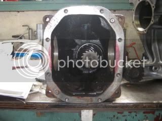

[IMG][URL="http://i164.photobucket.com/albums/u12/bj_on_roids/Arnout%20Van%20Der%20Kamp%20Single%20Turbo%20LS400/IMG_4356.jpg%5B/IMG%5D"]http://i164.photobucket.com/albums/u12/bj_on_roids/Arnout%20Van%20Der%20Kamp%20Single%20Turbo%20LS400/IMG_4356.jpg[/URL]

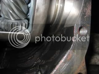

[IMG][URL="http://i164.photobucket.com/albums/u12/bj_on_roids/Arnout%20Van%20Der%20Kamp%20Single%20Turbo%20LS400/IMG_4355.jpg%5B/IMG%5D"]http://i164.photobucket.com/albums/u12/bj_on_roids/Arnout%20Van%20Der%20Kamp%20Single%20Turbo%20LS400/IMG_4355.jpg[/URL]
