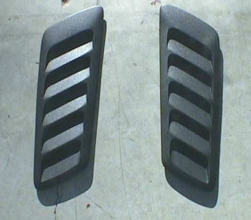

I plan to use the V6 rad, but was planning on a decent thermo setup and 3 hood (Bonnet) vents. I plan to use a Nissan Patrol scoop in the center and 2 Jeep Grand Cherokee 5.9 Limited style vents. Here's a pic of each.
Patrol Scoop:
5.9 Style Vents:
Either those or some port-hole fender vents maybe (fan assist????)
