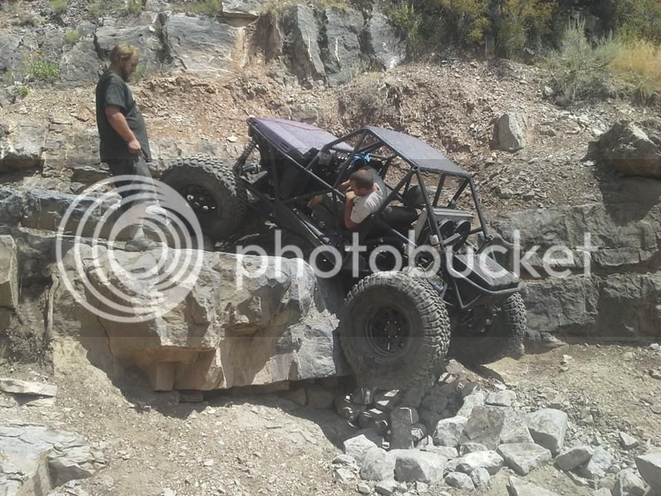

been loving my 1uz swap!
Zukijames
1uz,r150f,dual ultimates, fj80 axles, front uses a rear 9.5 diff
first trip

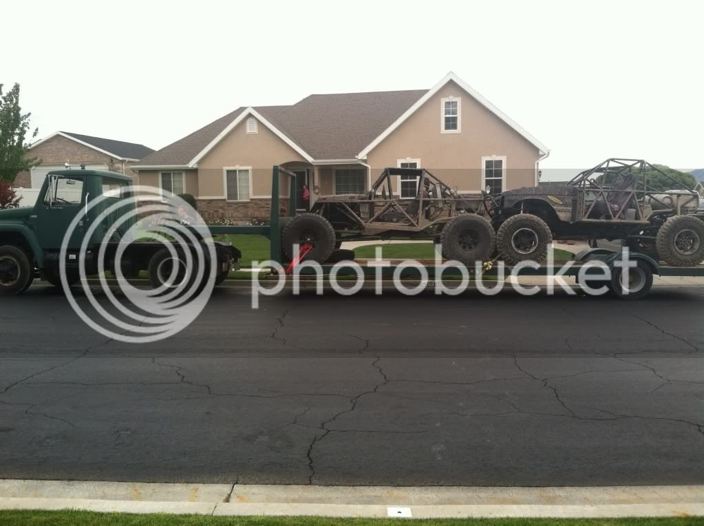

after the first trip ( the big truck and bigger buggy are my girlfriends rigs)
2 days after that
