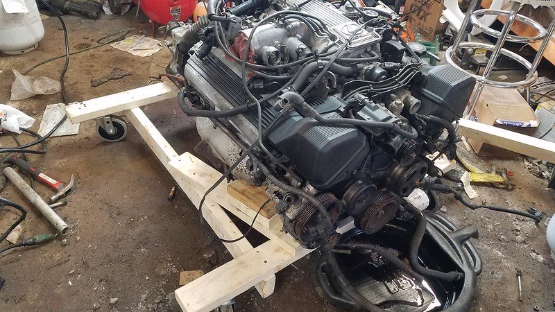

Since I'm going to be tinkering with it for sometime, and want to move it around the garage so we can still park inside, I built a crude little wooden cart with some castor wheels:

Yea, I think there are 3 VSVs (I think one controls the EGR). There's 3 separate vacuum lines that wrap around the front of the plenum (zoom in on the picture above of it on the cart in my garage), as well as some long hoses hanging off the motor (I assume for a charcoal canister). The engines on eBay (mostly JDM) have none of that.

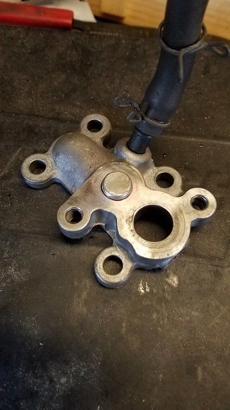

I discovered that a 9/16" freeze plug (Dorman 555-008) almost fits in the upper opening in the EGR adapter. It wasn't as tight a fit as I'd like, but I was able to tweak it a bit, and with some locktite around the edge, I'm pretty happy with it. cost 50 cents, and looks much cleaner than an aftermarket block off plate.

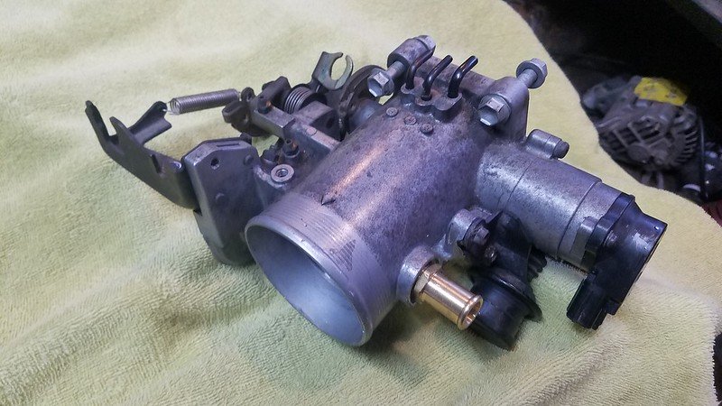

Modified the throttle body. I discovered that the bore for the bearings for that butterfly is perfectly sized for 3/8 NPT. I quick drill with a 1/2 bit to clear out the thin flange that holds the bearing there, and I was ready to tap.
Couldn't find almost any options for a brass 3/8 NPT - 5/8 hose barb adapter (Local hardware store had it in Nylon...). But www.fittingsandadapters.com had one, I was able to find $15 worth of stuff I needed from them, so I got a clamp-style hose barb, and a plug for the other side.
