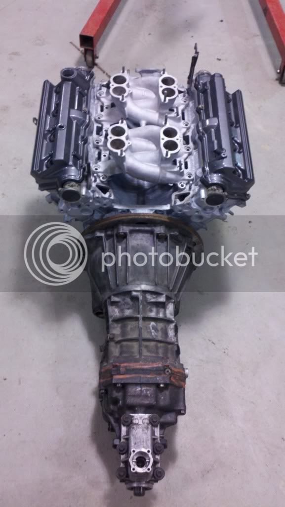

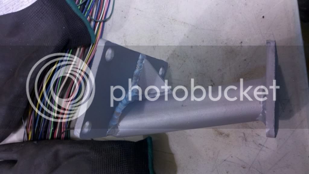

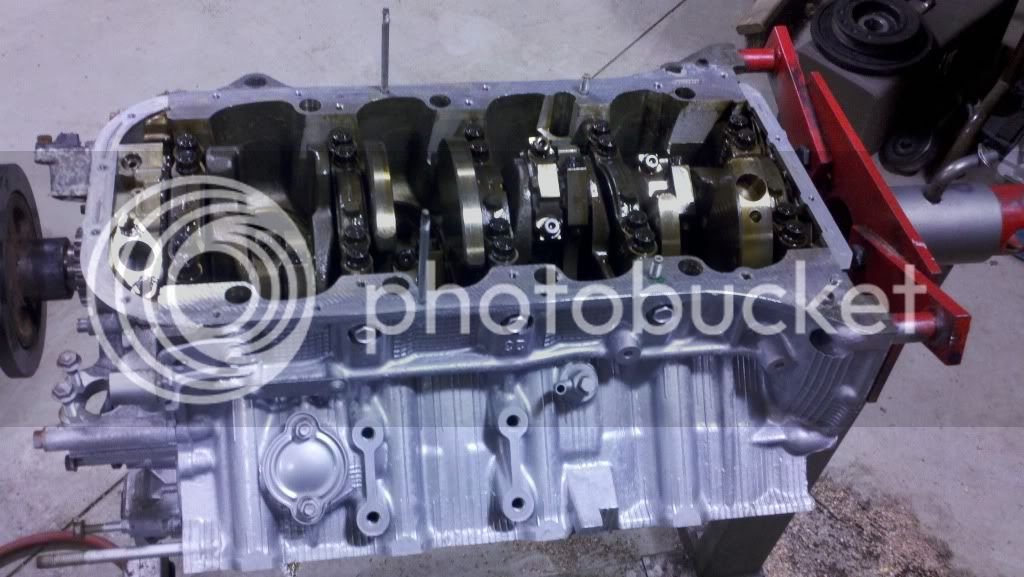

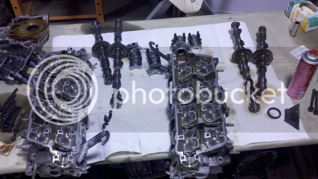

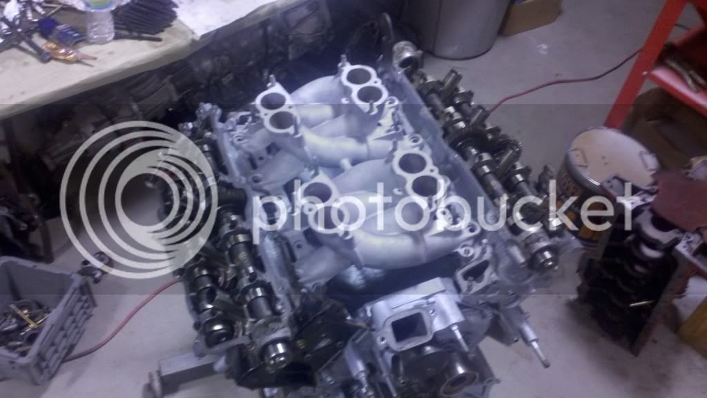

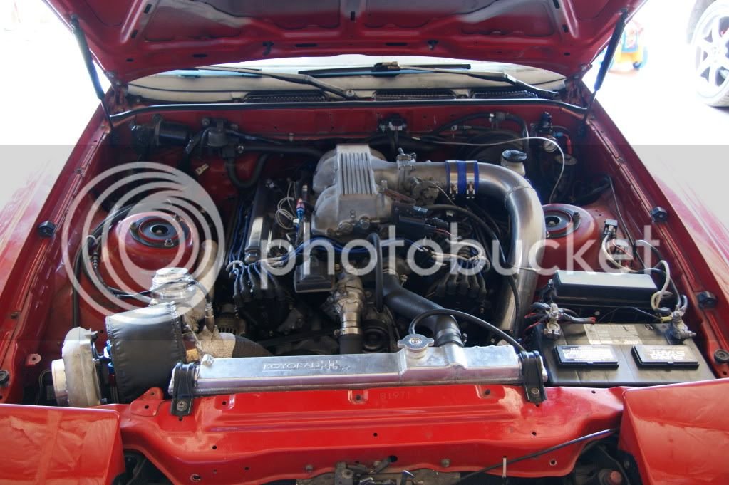

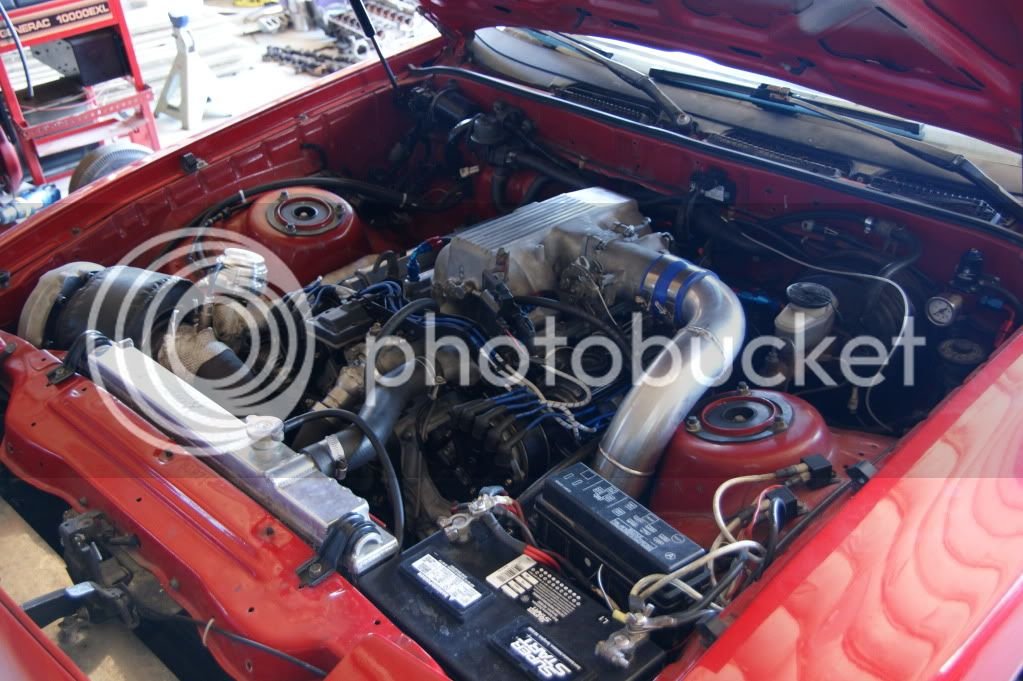

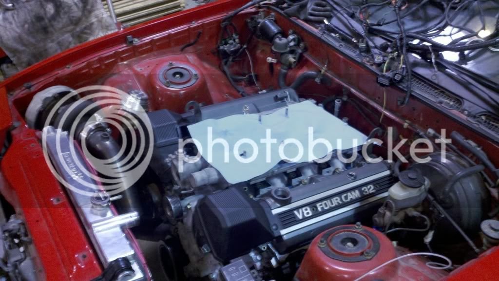

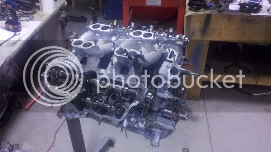

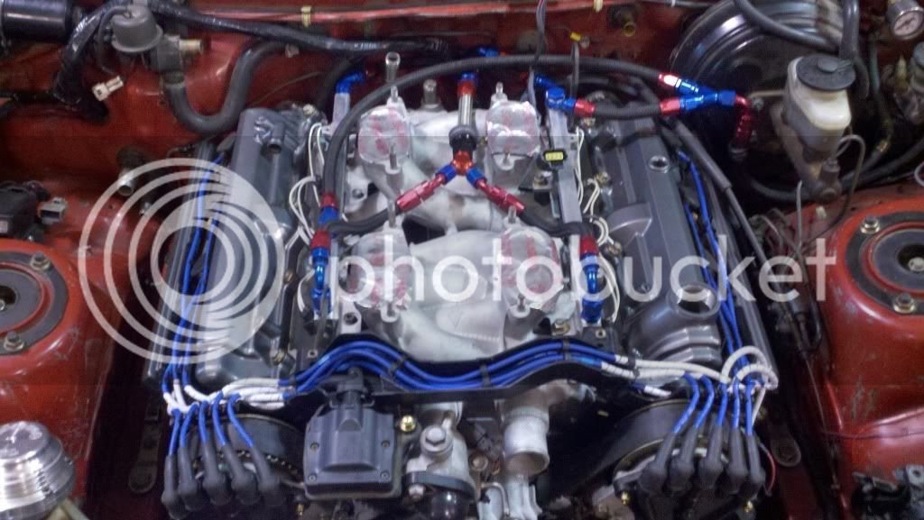

This is my first time posting on here. I've been a reader of this forum for quite some time but never had much of a reason to post until now. But with that being said, I figured that you guys might appreciate the current status of my mk3.

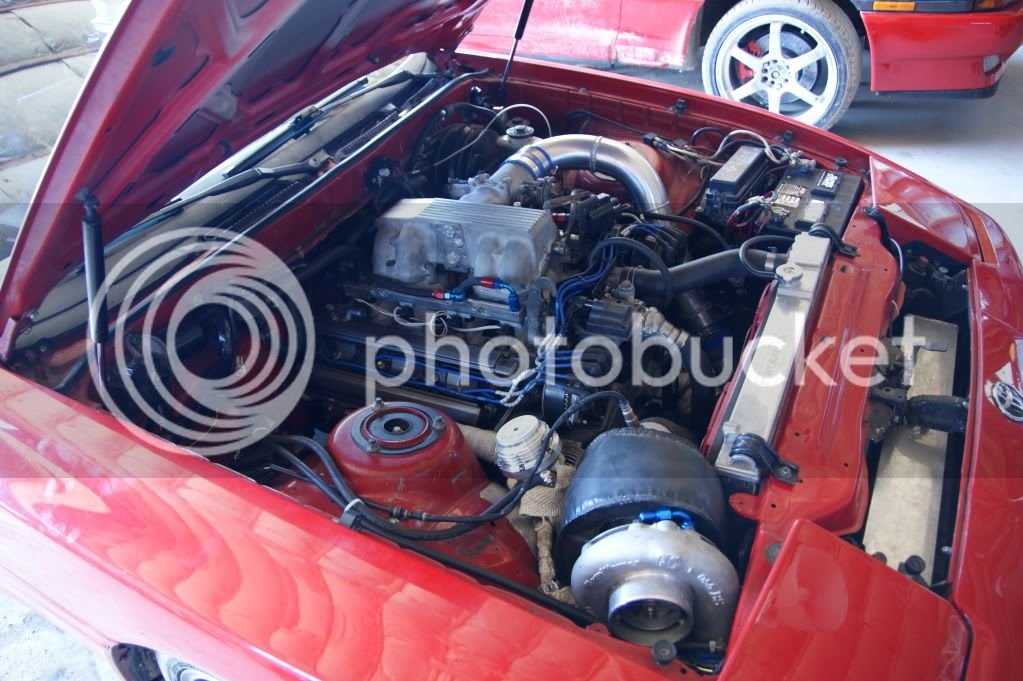

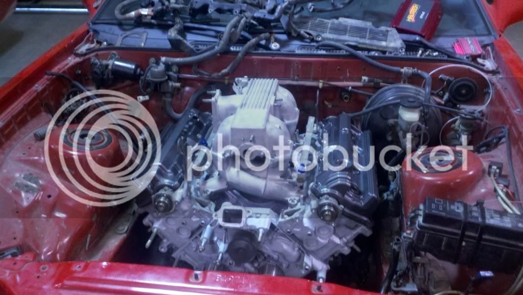

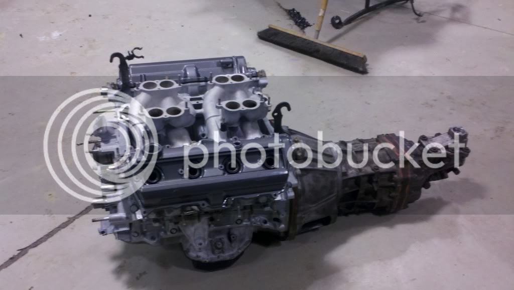

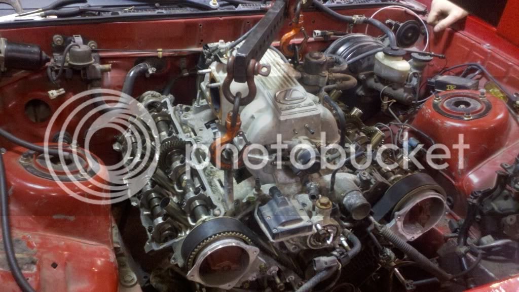

The whole process took about 3-4 weeks of actual work. It's still in the "shake down phase". When I'm confident that everything is sound then I'll put all the engine covers on and clean the rest of the mess up under the hood.
Here's what's done:
100% stock 1UZ-FE from the junkyard $350
Borg warner S366 (kind of annoying that this turbo is becoming the flavor of the month)
Running on E85
R154
Haltech EMS
8 x 875cc Injectors
Totally stock ignition system with all new components
3" I/C pipes to a 4" I/C core
2 Walbros feeding a -8 to the rails
Currently the car is sitting at 14psi. It feels pretty much like my 1J did at about 20psi but with a ridiculous power band. Unfortunately the clutch is letting go at anything above that. The clutch is rated at 600ftlbs...but you know how that goes.As far as final boost is concerned, I'm aiming for 20-25psi when it's all said and done. I don't see that being a problem at all with E85, 10:1 compression and and exceptional tuner ;-) The ONLY weakness in this engine is the composite headgaskets. If they become an issue then I'll swap MHG's and studs on. Then my goal will move to 30+psi.
