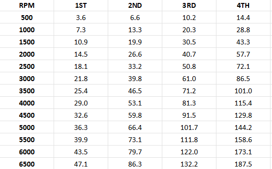

Hi - with your tire size and diff ratio, this should be your speed chart.
KPH = RPM / gear ratio / diff ratio * tyre circumference * 60 / 1000000
MPH = as above * 0.62
Mine is slightly slower (3.69 diff and 245/45R17 tyres) and it drives and cruises just fine.
