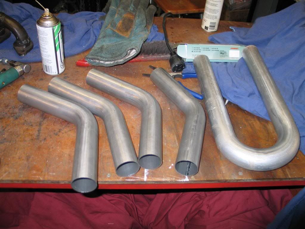

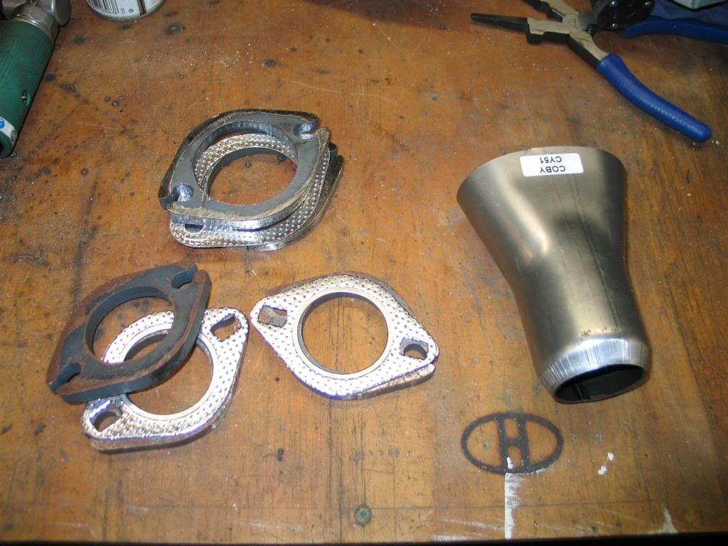

Using 2" from manifolds into collector, then 2.5" to muffler.
Bends
Flanges & Collector

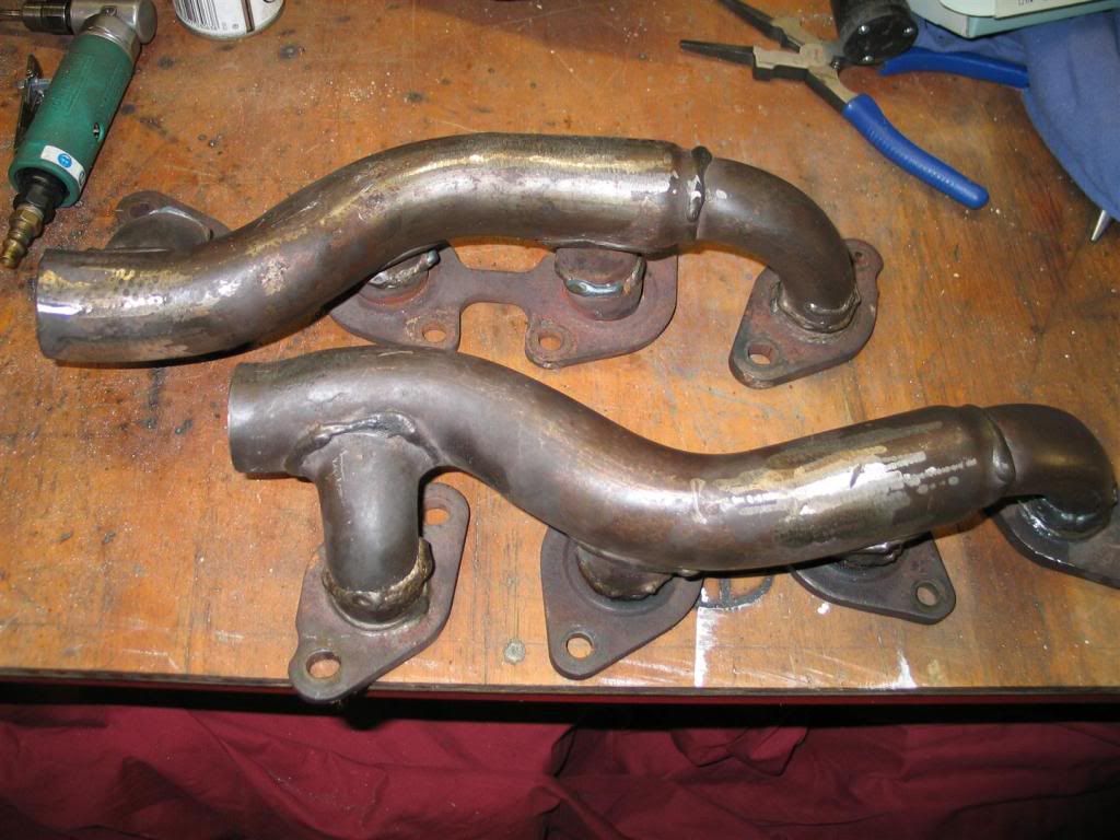

Original manifolds shortened. Die ground inside, very untidy from factory.
Right hand side

The swap looks like it's going great. Do you have any pictures of your die grinding inside the exhaust runners? I'd like to see how tidy you made things in there. I imaging the cleaner and smoother it is the better the exhaust is going to flow. Thanks for the great idea.
