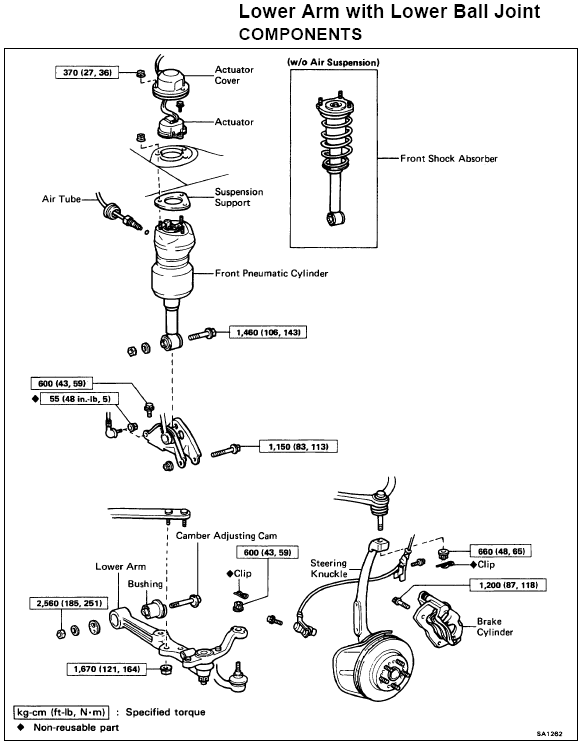

Since I have a lot more time than money, I took on the task to install the new bushings and lower ball joints on my 1990 LS400. My car has 165K miles. The old lower ball joints had about an 1/8th inch play in while the upper ball joint had no play. The upper control arm bushings were very warn and loose but I noticed very little play in the lower control arm bushing.
I replaced the lower control arm bushing anyway since I am sure the Daizen bushings will last a lifetime as well as offer an improvement over the OEM. The improvement in ride and steering is very noticeable. Clunks are gone. Ride is very smooth.

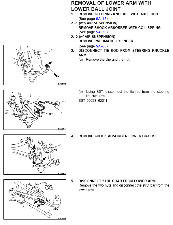

A few things I learned in doing the job myself. Don’t try it without a Lexus repair manual. The repair manual is very straight forward and easy to follow.  Most of the bolts and nuts haven’t been touched since the car was first assembled. I found an 18 inch cheater bar made breaking the bolts loose simple and saved a lot of skinned knuckles. The upper control arm bushings are the easiest to replace as you just need to press the entire bushing out.
The lower control arm bushing is more time consuming. As the Daizen instructions state, you need to heat up the inner aluminum core of the original bushing until the rubber around it melts enough to press it out. I only had a propane torch so this took about 15-20 minutes of heating for it to start melting the rubber. As the Daizen instructions state, you will reuse this aluminum core.
Once I got the aluminum core out, I just let the rubber in the bushing continue to burn and scraped as much of the rubber residue off as I could. The outer steel sleeve of the original bushing must stay in place on the lower control arm. I then cleaned all the left over rubber off by using my Dremel tool with a sanding wheel attachment.
It took a while but I eventually had a very clean inside to the original bushing to then install the Daizen bushings on. This took me about an hour per lower bushing. I am sure others can improve on this by using a hotter torch. I liberally greased the bushings with the included waterproof grease which has to be the stickiest grease invented to date. (Don’t want these new bushings to squeak.)
While I had the lower control arm off, I replaced the lower ball joints which takes next to no extra time. I got them on-line at Olympus / for $45 each.  Total time for me to do the first side was about 8 hours. Total time to do the other side (after learning from doing the procedure once) was 5 hours. IMO it was well worth the effort.
