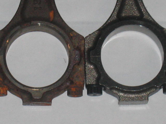

The pictures below are to original rods from Lexus, specifically LS400 and GS430.  The rod on the left is 1UZ and the new rod is 3UZ.  From the first picture of the two rods, you can already tell the difference and similarity between the two rods.
Lets start with the cap.  The 1UZ rod cap seem to be little beefier with same bolt size for both rods.  The larger end diameter is the same.  They both measured 2.165″.  The small end is measured .864 respectively for both.

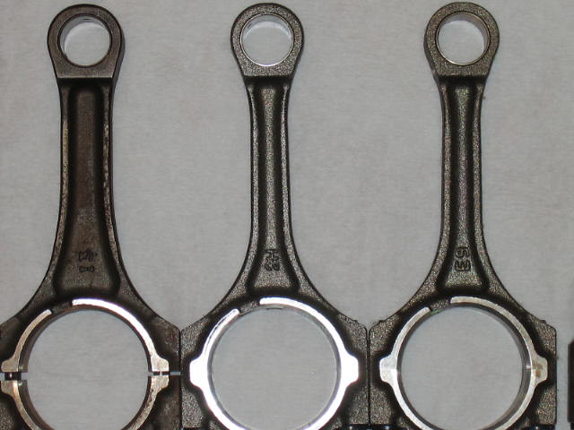

So far there are more similarity than differences.  As we move toward the shaft, you will find out the disappointing specs.  The 1UZ rod is actually beefier then the new rod.  The thickness for the rod shaft is .880″ for the 1UZ and .652″ for the 3UZ rod.  The width of the rods are appear to be a huge differences.  .483″ for the old school rod and .445″ for the modern version.
As you read more  and see more, you began to ask yourself.  Why would Lexus make such a weak rod on the 4.3 liter?  That is a very good question and it will be a hot topic for discussion for a long, long time.  I don’t have a sensitive scale and I will try to weight them.  However, the two rods are noticeable in weight and size.
The picture below start to pain a picture in your mind.  1UZ on the left and 3UZ on the right.  As for forced induction application which rod would you choose?  Personally, I would choose the stronger one.  Which one is the stronger one?
The full picture is really telling a story.  The noticeable differences in rod shaft width and thickness.
I really felt the $50 usd was well spent.  I was very surprise to find out the thinness of the 3UZFE rod.  Since the newer engine has larger displacement (larger bore size), did Lexus tried to compensate larger pistons with lighter rods?  Lighter will rods will rev higher and making up for the larger bore?  Those are very good questions and we should continue this discussion in here.

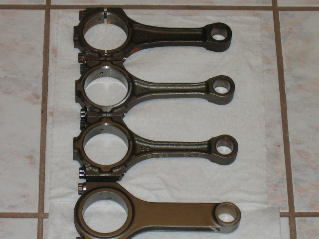

Here are three UZFE rods from 1 to 3 and I also attached a Lextreme Lightning H Beam rod.  U can see the Tundra and 430 motors have skinny rods.  This is one of the many reasons why TRD stop making the Tundra Supercharger Kit.  The rods are too small and unable to handle hp.
Here are the official weight from a Pitney Bowes Postage digital scale. The weight include, the rod, cap and 2 bolts without bearings.
1UZFE Rod: 628g
2UZFE Rod: 581g
3UZFE Rod: 581g
