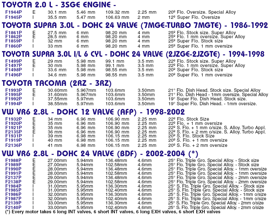

Comparing 2JZGTE Valve Spec Vs. 1UZFE Valve Specs
Ferrea Valve Specification
Properties 2JZ Intake 2JZ Exhaust 1UZ Intake 1UZ Exhaust 2JZ Retainer 1UZ Retainer
Stem Length 98.55mm 99.10mm 95.2 mm 97.12 mm .340″ Height .299″ Height
Stem Diameter 5.98mm 5.98mm 5.96 mm 5.96 mm .986″ O.D. .986″ O.D.
Valve Size 33.60mm 29mm 33.45 mm 28.04 mm .786″ 2nd Stage .686″ 2nd Stage
Tip Length 3.5mm 3.5mm 4.00 mm 4.00 mm .502″ 3rd Stage .474″ 3rd Stage
Tip Groove N/A N/A 2.15 mm 2.15 mm .291″ I.D. .300″ I.D.

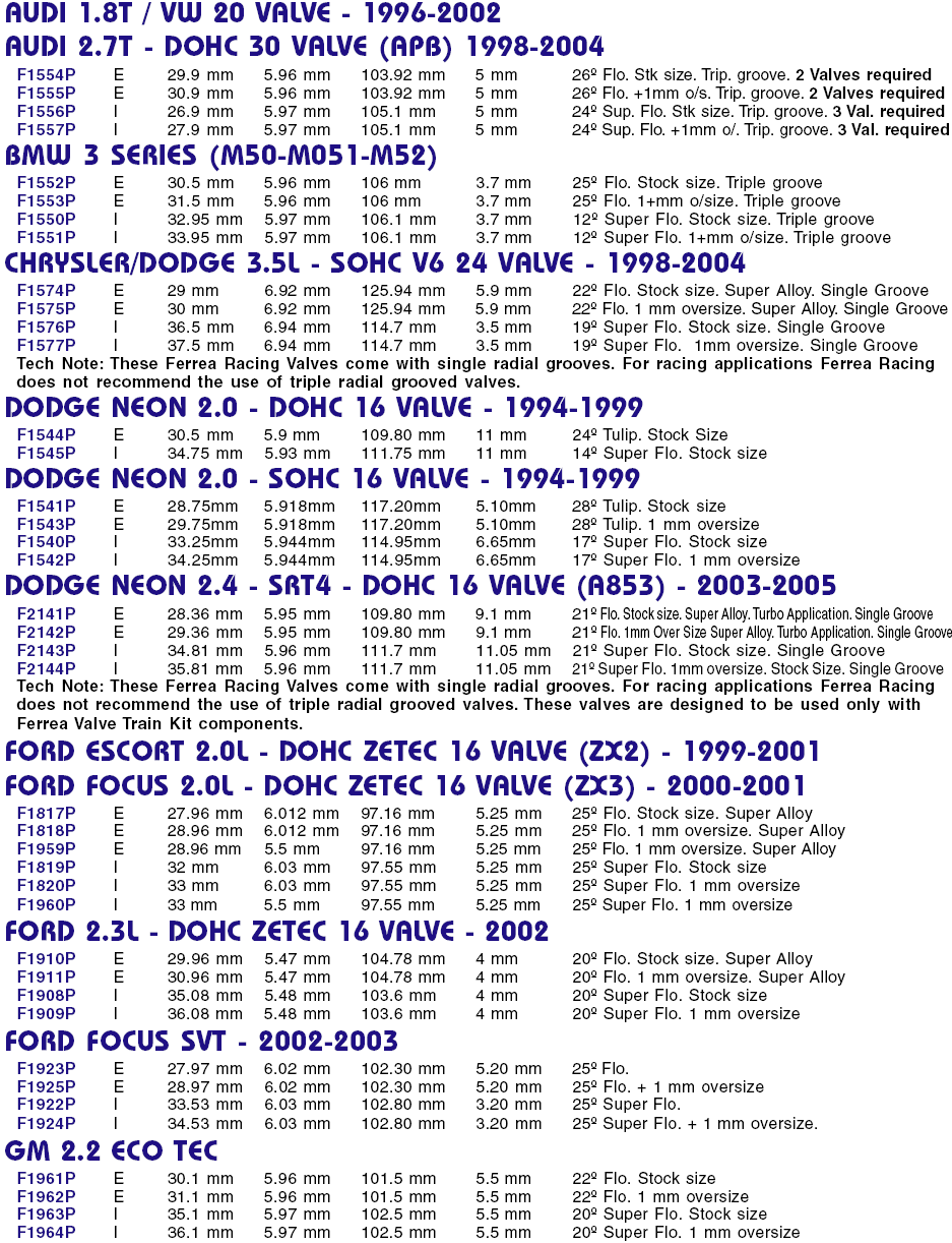

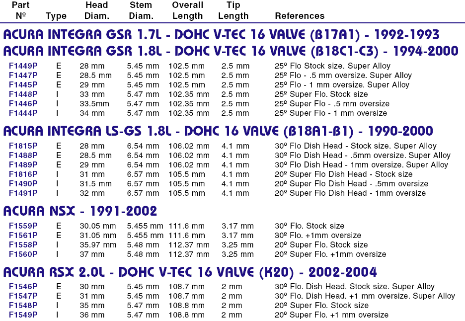

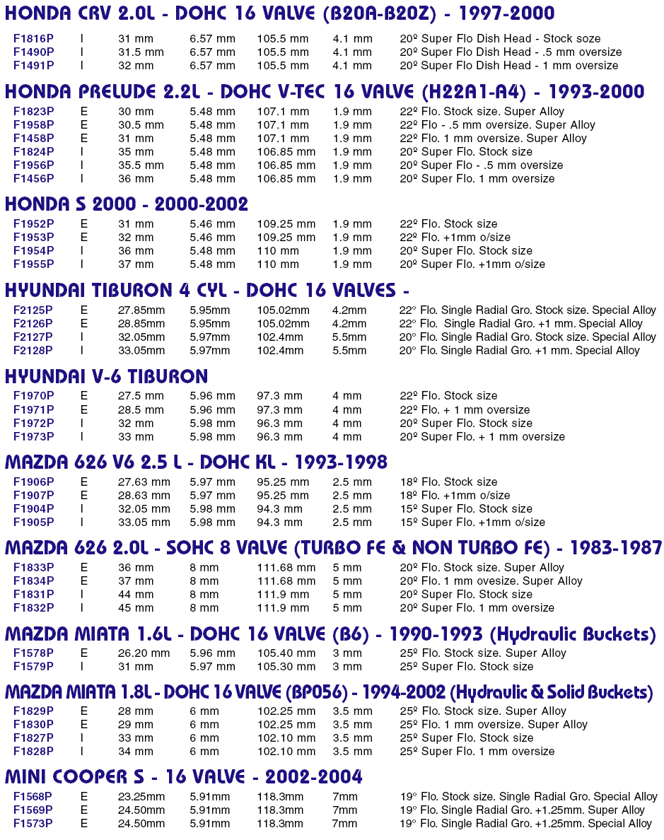

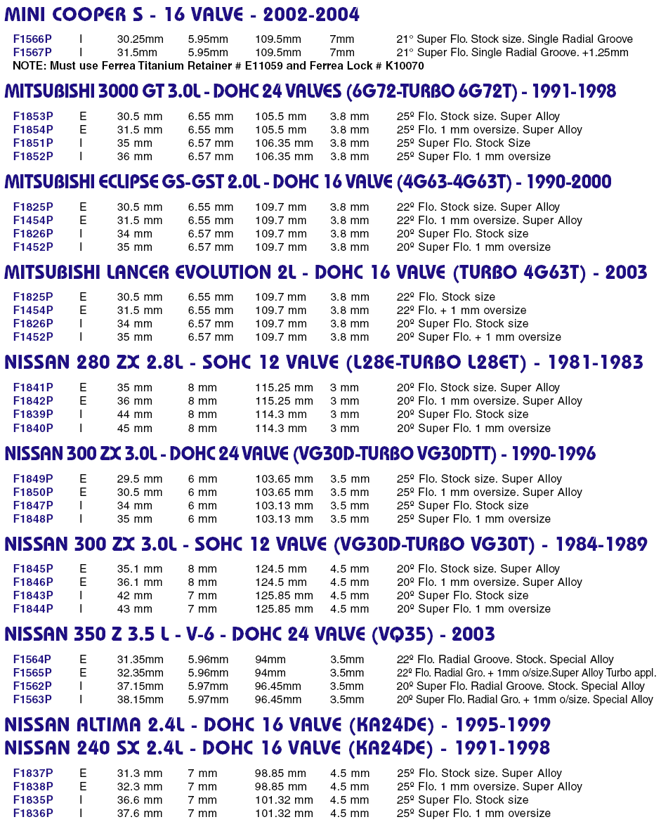

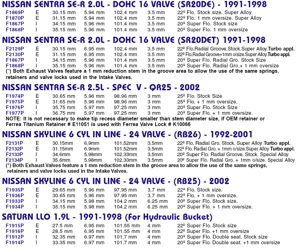

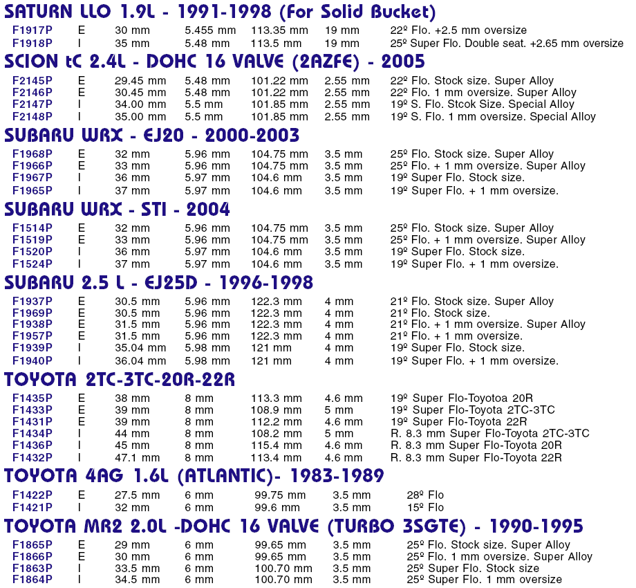

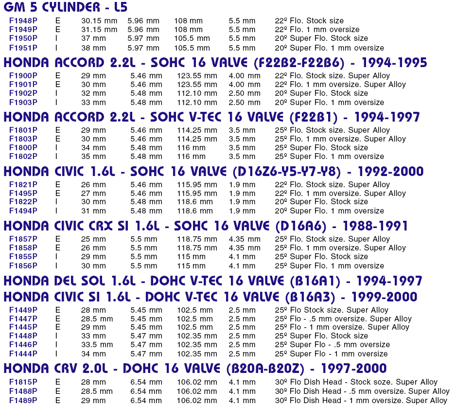

Here are some possible valves that can be use on the pre 1998 1uzfe valves.  Credit for the valve specifications go towww.ferrea.com.
