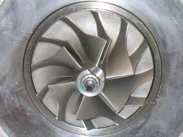

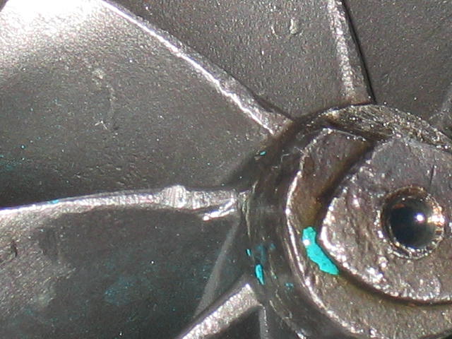

The truth is that this turbo is NOT brand new.  Matter its a recondition used.  I also did some further investigating and noticed the specs were way off.  As stated above the compressor is 82mm compressor wheel but in fact its only 76mm.  This turbo got used parts that were cleaned and reconditioned.  Below is a picture took on the turbine wheel:
You can see multiple scratches and deformities.  You can also notice blue paint residues.  It doesn’t take an engineer to determine this turbine wheel is used and damaged.

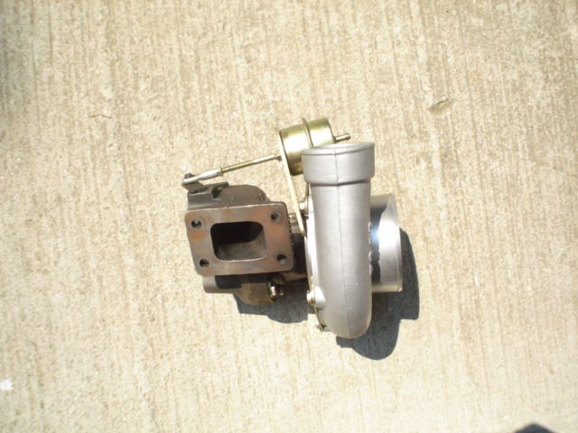

Below is a picture of the GT35/40R from SSAutochrome turbo.  The compressor is new however, its not align when its spin.  The compressor wheel is misalign and also have some grinding sound when the turbo is turn.  This is extremely dangerous especially when installed in a high power car.  If this compressor wheel break, you can kiss your build engine good bye.

  • Wastegate included: Yes its included but doesn’t work with the current turbo.  Doesn’t matter how you rotate it, it doesn’t fit.  The picture on this page shown it attached to the waste gate but it didn’t bolt onto the turbo.  Its basically is useless.  You will need a complete actuator and a bracket in order to make it work.
