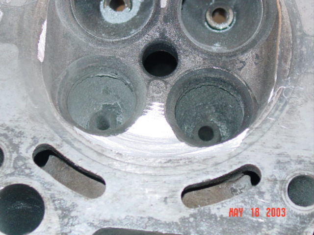

2. Machine The Heads:  Machining the heads are pretty common.  I have two extra motors at home and one is fully disassembled.  I took of the head and start to analysis what I can do to decrease the structural around the chamber.  Here is a picture of standard unmodified 1UZFE head chamber.  The valves are taken off at this picture:
To look at this picture carefully, you will noticed the intake valves are at the top and exhaust valves are at the bottom. The angulation of valve seats are different.  The intake valves are lower (higher from opposite view) and less material we can machine out.
Therefore, I don’t recommend machining the intake or the top side from this picture.  The most available area to be machine would be the bottom area.  I also carefully exam the posterior area (water passage) of the chamber making sure there are enough material to keep the integrity of the head after its machined.  All the grinding is from my 4″ Craftsman Grinder.

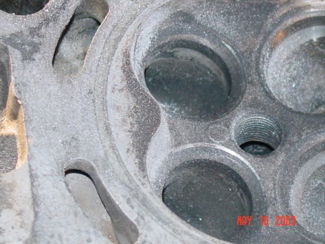

Here is a picture after it was machined. The top area is the intake valves and bottom is the exhaust valve chambers.

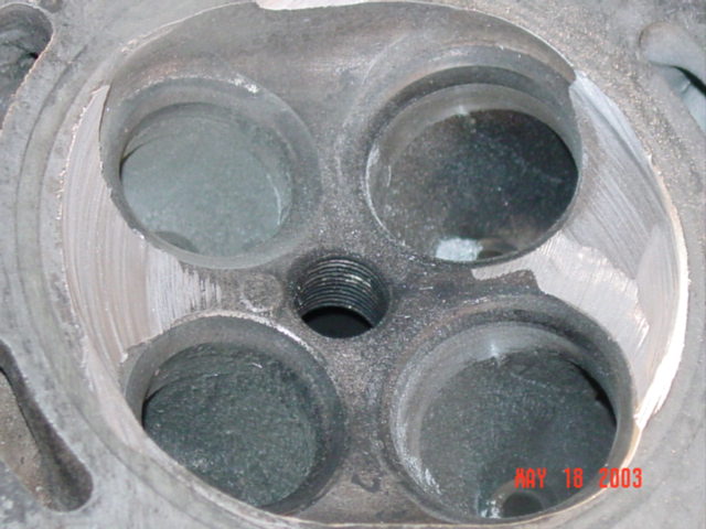

Its a same picture with different contrast so you can see it better.
This is a picture of sthe exhaust area being machined.
This is taken from a slight different angle. The left valve chambers are exhaust and other side is intake.

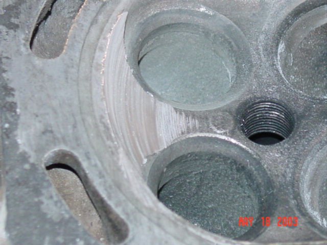

This is a close up of the exhaust side being machined

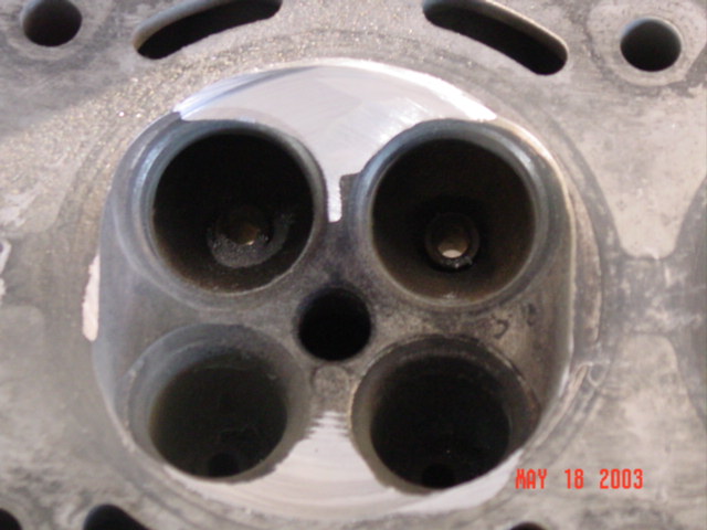

This is a un-machined chamber.
Of course this is just an experiment.  A professional engine builder will be able to do all the machining to a precise measurement between all chambers.  How much would this lower the compression?  I do not know, but my guess would be around 9.5:1.
