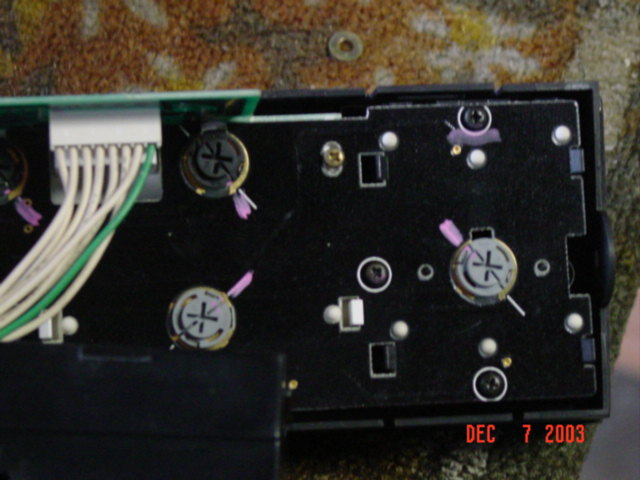

This is a closeup on the LCD display. The black panel needs to be removed. There are about 7-8 screws holding it in.
Here are the basic tools you will need beside the screw driver.
This is how it looks like when the back cover is removed.

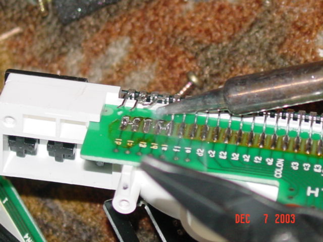

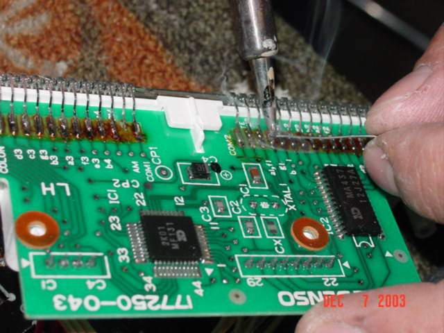

Using the heated solder and start removing every single pin.
A closer look at the pins bring removed.
Cleaning up the old solder with a solder removing wire.
Now the old dead lcd is out.
New LCD being solder in. Its pretty much plug & play.
Soldering it in. Becareful don’t over solder.
A closer look at the new lcd being solder.
