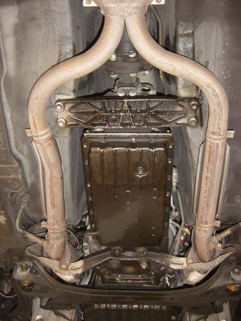

Here is how the stock SC400 exhaust system looks like:

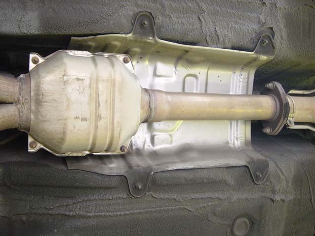

The U.S. Spec Soarer has a Sub-Catalytic Converter and its very restrictive.  Since I had dual 3″ exhaust and it was LOUD and its a pain sometime for a luxury car.  Here are some pictures of before and after Greddy Muffler installation:

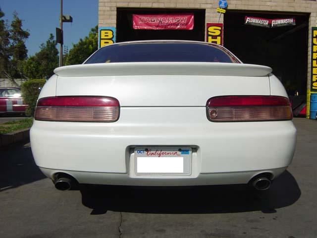

Here is a beautiful picture of a clean SC with stock mufflers.

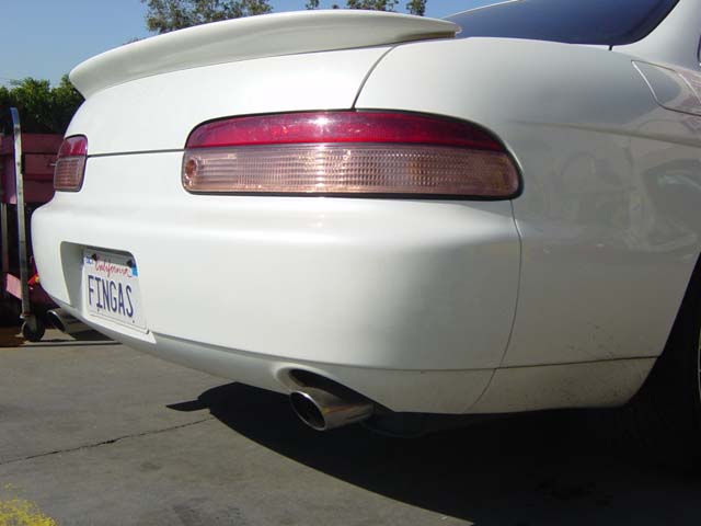

Side profile before the modifications, its a virgin.

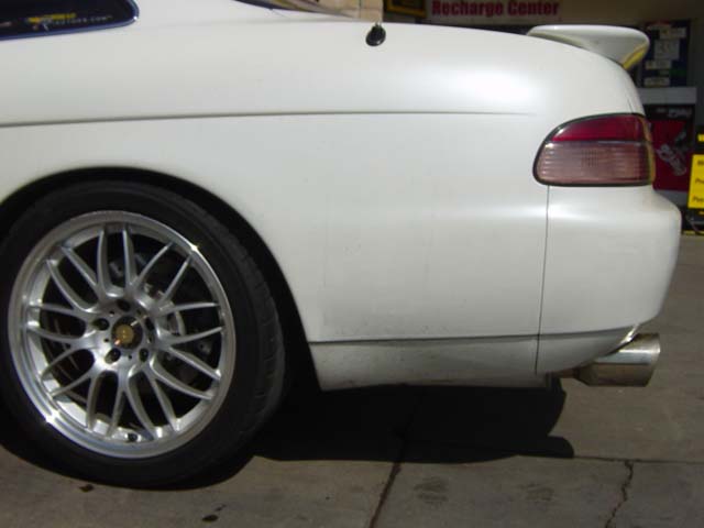

Tinny little stock exhaust tip.

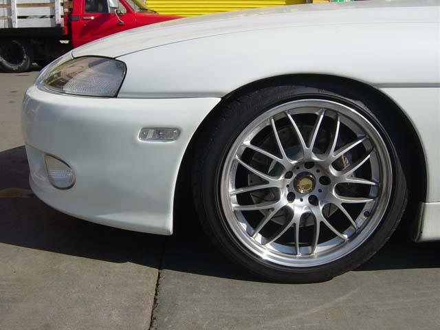

Tony is showing off his Supra Brake with drilled and slotted brake. Nice rim by the way.
Tony still showing off his clean Lexus. Gotta give it to him, its ACleanSC for sure.

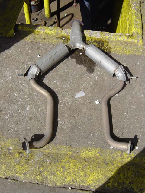

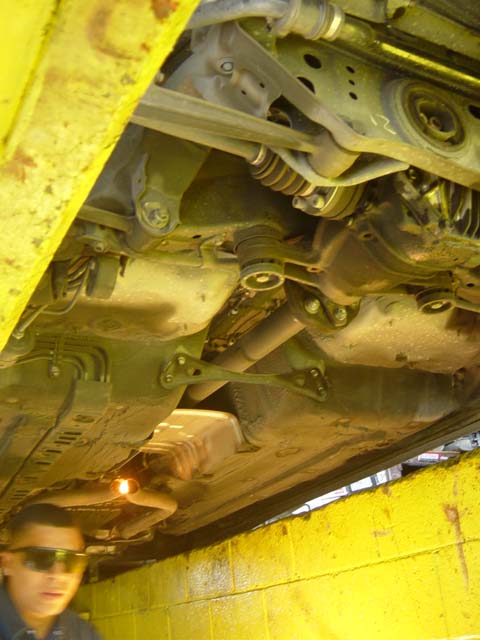

Ok, this is a stock exhaust coming out from the primary cats.
Here is the U.S. Spec Sub. cat. Bottle neck is right here.

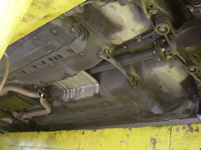

This is post sub cat and moving toward the mufflers.
Primary mufflers and going toward secondary mufflers.

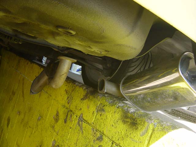

Stock post sub cat exhaust is out and gone.
Those are Greddy primary mufflers for the SC300.
Its in…. Nice already..
Getting better.. I can just image how it would look like once its done.

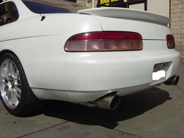

Two huge pipes coming out from each side. I think the muffler tips are 4″ each.
An above view of the tips.

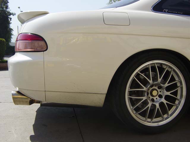

Side view of the new exhaust.
Nice… Dual 4″ Tips.
Very nice…
From our phone conversation, Tony stated this setup have slightly deeper tone, but the sound level is almost like stock.  However, Tony stated there is definitely an improvement in performance.
