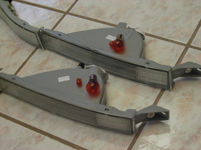

* Two Clear Night Lights
* Two Clear Signal Lights
* Two Night Light Bulbs – Street Legal
* Two Signal Light Bulbs – Street Legal
Here are two sets of clear corners with street legal light bulbs.
A closer look at the clear corners and light bulbs.
The night light and signal light bulbs are street legal.

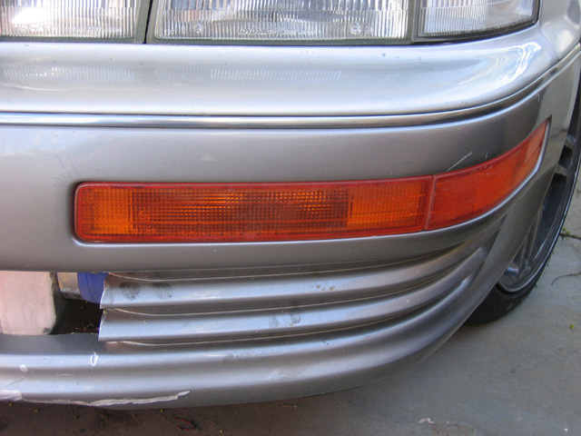

Here is your dual and ugly looking yellow/orange night light and signal light.

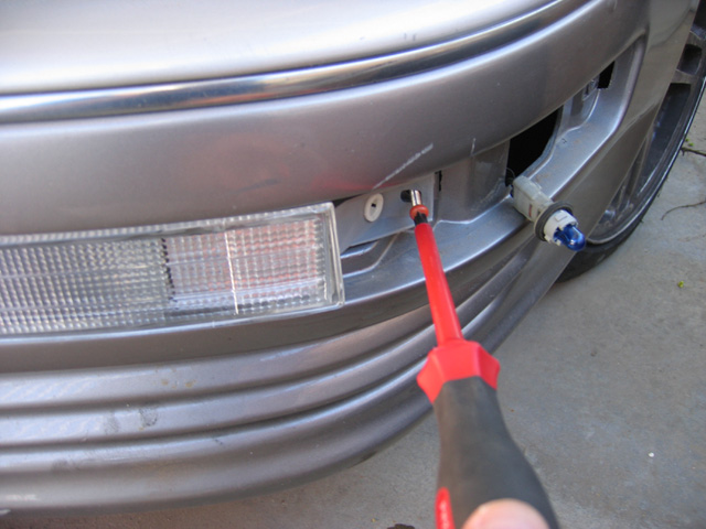

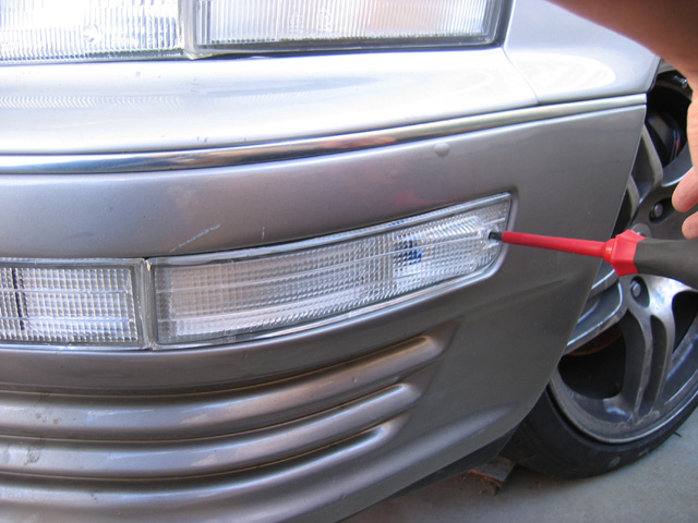

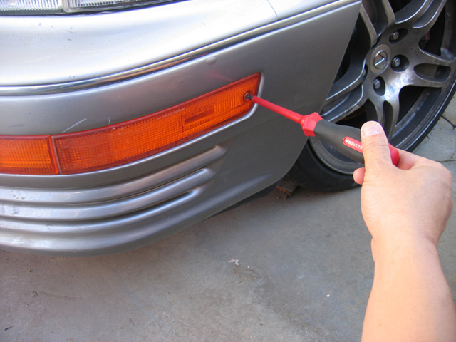

First step is to use a Phillip Screw driver near the end of the bumper.

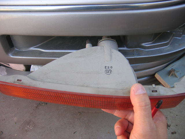

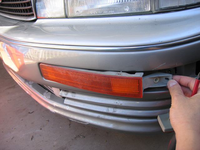

Once the screw is loosen, the signal lens comes right off with a little pull.

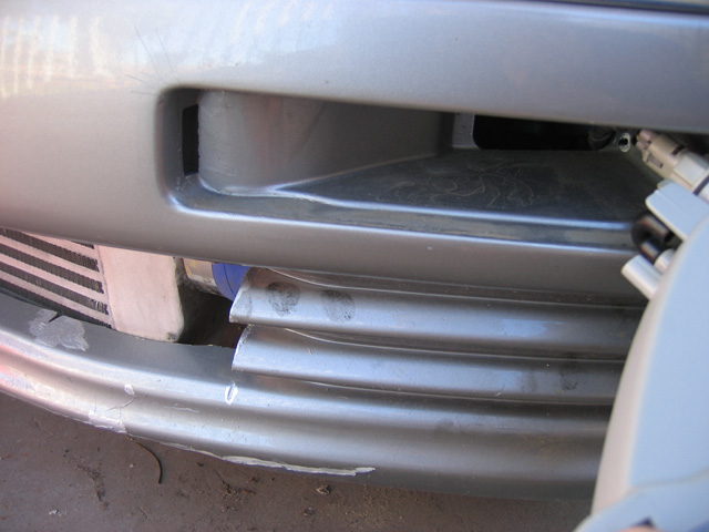

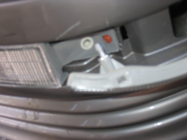

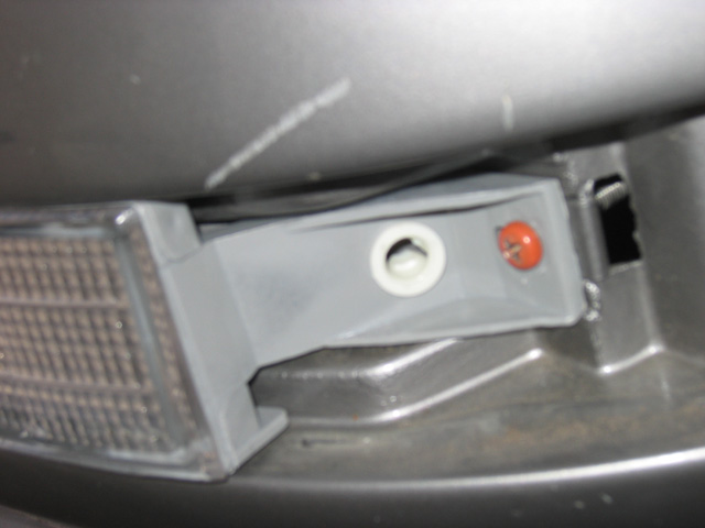

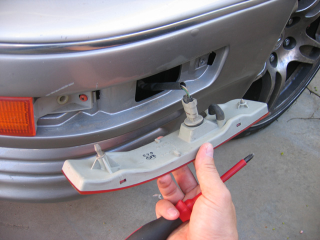

After the signal lens is out, now you can attach the night light by doing the same thing.
By using your fingers and pull the lens out.
The unit comes out pretty easy and be careful don’t pull too hard.

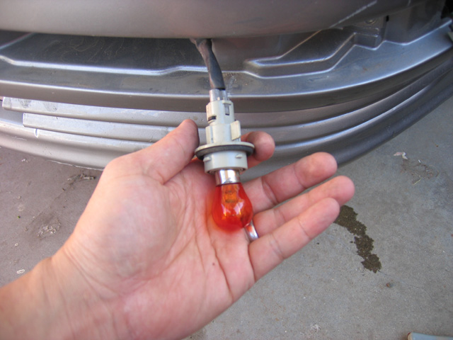

You need to disconnect the light bulb by turning counterclockwise about 1/16 of a turn.

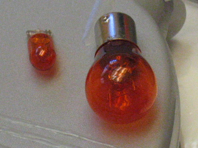

After the light bulb is detach from the lens, you need to install the street legal light bulbs.

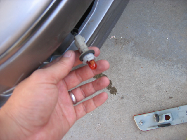

Here is another picture of the signal bulb. This light bulb comes off by pulling it. It’s a shocket like fitting.

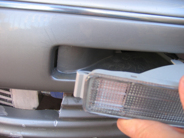

Ok, time to install the new and cool clear corners.

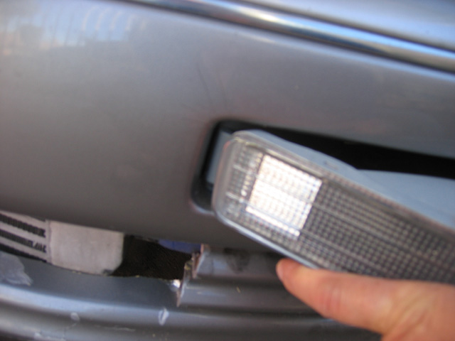

Insert the night light first into the given groove.
Once its align, you can use some muscle and push it in.
Now push the other end into the bumper. If the night light lens doesn’t look or fit right, you have the right and left light switched.

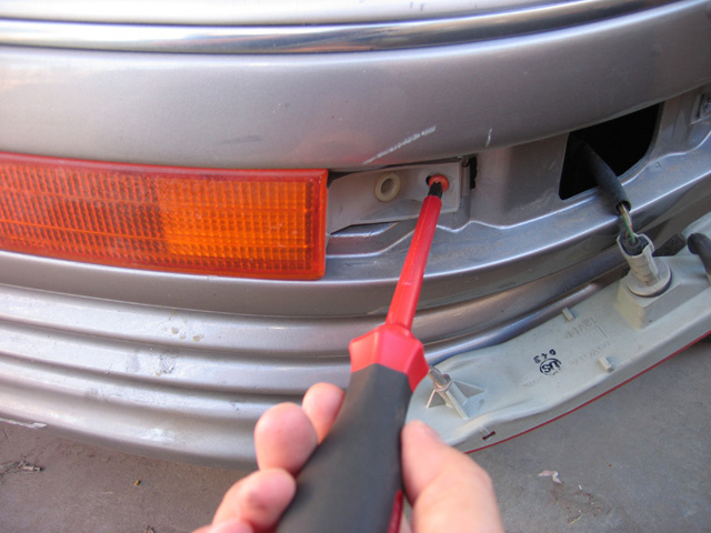

If everything is fitting good, then it’s time to install the screw back.
The white hole is for the signal lens to attach.
Align the hole and the signal lens and apply some pressure into the bumper.
Now you can tighten the last screw to stabilized the signal lens.

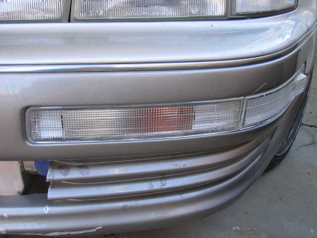

All done, now you are cool and hip.
Now you are cool and hip.  Incoming traffic will notice your car is different and it will stand out.  If you still want more coolness, then you can replace the street legal light bulbs to blue color bulb.  They are very cool, but cops may give you hassles.
