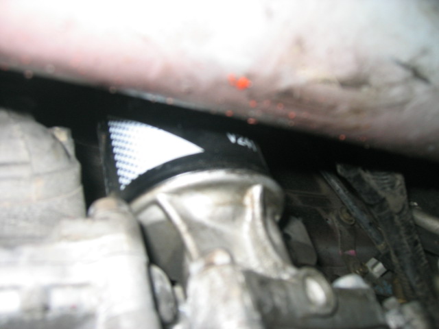

Now its time to replace the oil filter.  The filter is a round cylinder like that is located right above the cross beam.  Once again, you can not miss it.  Its normally can not loosen with hands.  Best would be getting one of the oil filter pliers.  Once the oil filter is out, you can install a new one in.

Remove and install new oil filter.
