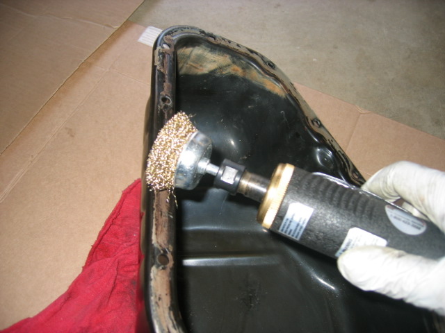

Once the pan is out, you need to clean out the old silicone on the pan and the block.  The best way is to use a wired brush to clean both contact surfaces.  Once the old silicone is all gone.  Its best to spray some carburetor cleaner or brake clean to degrease the surfaces and wait until its dry.  The next step would be to apply a thin layer of high temperature silicone to the oil pan surface.  Once you have done that, its time to put everything back.  Here are some pictures of this process.

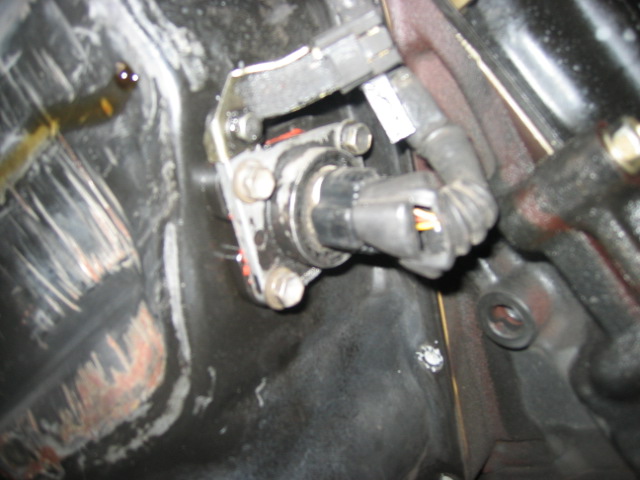

Picture below is the oil return hose and the oil level sensor.  Its located opposite side of the oil pan nut.
Here is a picture of the screws and nuts holding the oil pan                             Loosen the 10 mm screws with an extended shock
Here is a picture of the engine block when the pan is removed                        Using wired brush to clean out the old silicone

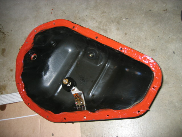

Spreading a new coat of new high temperature silicone
Final product…. NO LEAK!
