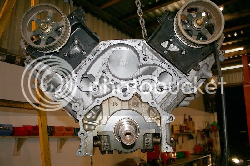

This is the new engine stripped down to just the sump, block, heads and cams.

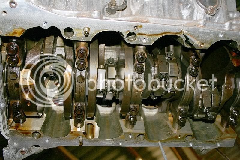

Nice clean bottom end.

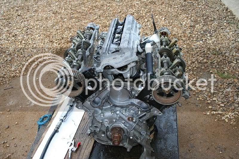

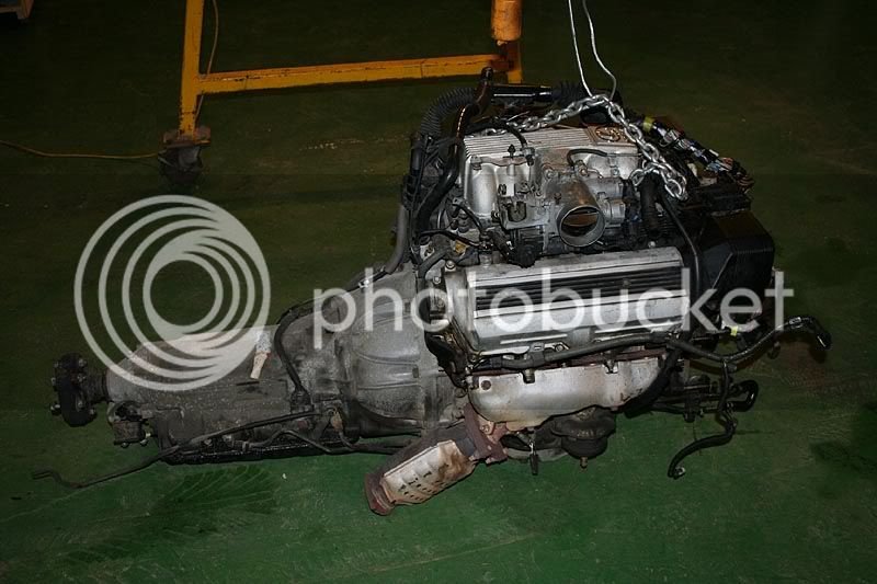

The old engine on the floor.

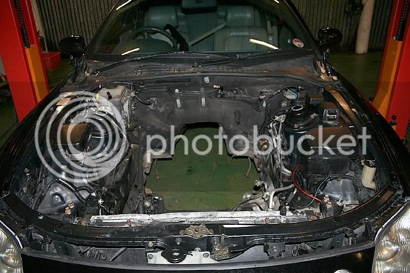

The hole in the engine bay.

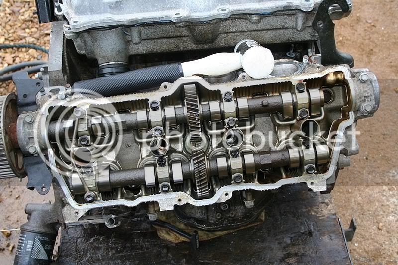

Cams on the new engine look in good condition (the cams on the old engine did too though!).

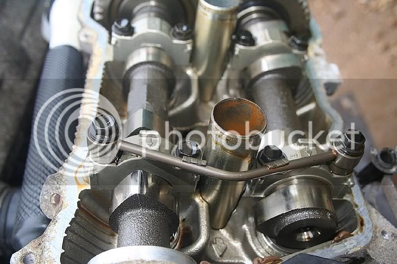

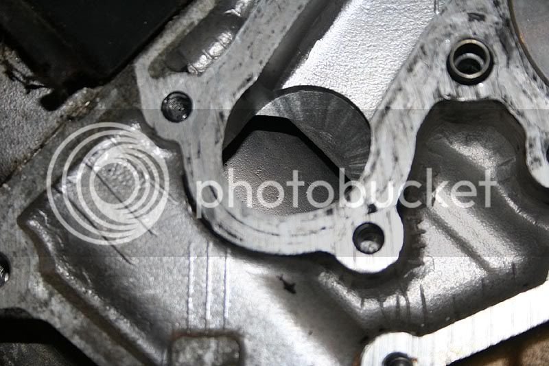

The new engine is spotless in the water jacket!
I think this bit was important!
