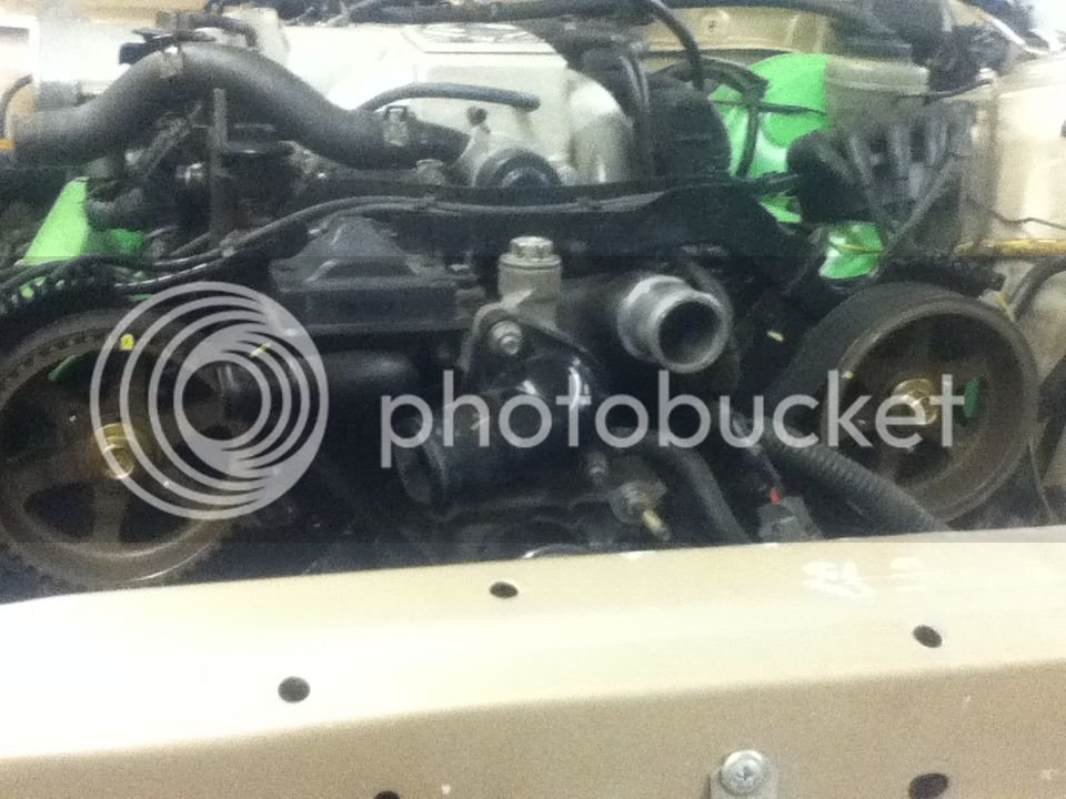

and i'm curious about this pipe, it used to got to the air filter box.
My question is can i remove it? plug it? or just leave it open & wht does it go to.
I have only been able to find them on 93' ls 400's but no info about it, any ideas?
Anybody have an idea of what that pipe is in the post above?

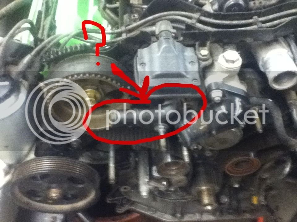

On a different note i marked all the timing marks to see what wasn't right,
Crank is at 0, the left Cam is dead on, the right Cam not so much as you can see in the picture.
this is what occurred from my water pump pulley sheering off and what i'm guessing jumped teeth.
So i'm glad to say i think i found the problem. :)
