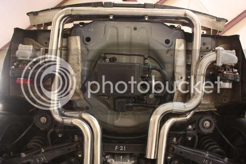

Here is a repost of the one I posted and lost in the server glitch
Remote rear mount twins, modified 5.0 liter engine.

As many pundits (including Five Axis' Troy Sumitomo) surmised, Kenny confirmed that the primary reason for the unorthodox mounting of those turbos was, simply, lack of underhood space. Time was yet another constraint. We were quite impressed by the way Brian Fox was the first of the four tuners to set up his CarDomain Page documenting the Artisan/Fox IS F's build starting with its arrival near Fox Marketing headquarters in York, Pennsylvania on 9 July 2008, not to mention the fact that the Artisan/Fox IS F was the first to generate Internet stories such as a Front Page story on our sister site LexusF.com. (To interject a counterpoint here, AndyZ of MotorworldHype.com, in a post on our IS F Forum strongly implies that all four tuners did NOT receive their cars at the same time). Still, once the Artisan/Fox IS F's paint and bodywork modifications were complete, it was driven (not trucked) halfway across the country to Turbochargers.com headquarters in Houston, Texas, with generous helpings of blue painters' tape (vaguely recalling the car's original Ultrasonic Blue Pearl paint) to protect its modded exterior. At that point, a not-so-friendly reminder of what an unsympathetic...er...female dog Mother Nature can be came when she unleashed an angry guy full of blustery hot air named Ike into the Houston area, doing serious damage to Turbochargers.com's headquarters and setting back the build schedule by almost 2 weeks.

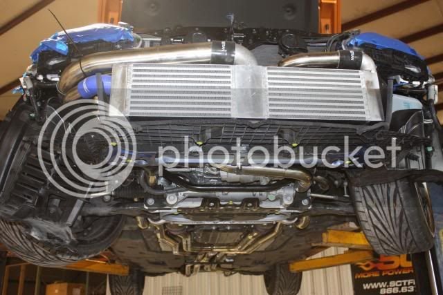

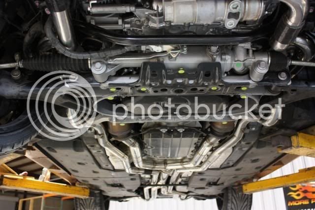

As stated earlier, space constraints under the hood (aggravated by header pipes that were already crushed) drove the twin Turbonetics GTK 350 turbos underground, so to speak. Undeniably, though, tucking the turbos up above the OEM exhaust and mufflers posed its own set of challenges, especially given Kenny Strickler's mandate that nothing in the car's chassis/undercarriage sit lower than stock. For one thing, this led to a mere ¼" drop, the least of the four project IS Fs. Hardly insignificant, on the other hand, is the 118 feet of tubing (or 59 feet per turbo and intercooler) required for this installation. Working around the front brake ducts (one of the installation's biggest issues, according to Kenny), the twin, side-by-side bumper-mounted intercoolers' lines merge into the center, as the tubing crosses over twice, travels up and back 3 times and loops around the spare tire well. Amidst all this, though, the two banks are equal (within 4") and are independent. And, yes, the turbos fire backwards, yet reach full boost at 3500 rpm.
