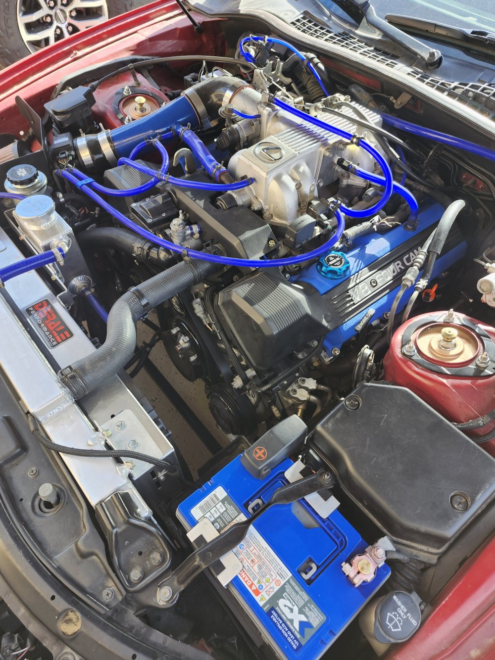

Hi guys, I have an issue.
The 1UZ Soarer hydro fan seems to be leaking from somewhere...
It appears the hose clamps may be bad on the pump outlets as that's where the gunk is but I cannot see the problem properly so the car is booked in on the 11th to be checked. I suspect a failed pump (probably the 30 year old seal) however.
I can't find a pre owned pump anywhere at a reasonable price, so I am thinking about converting to electric fans if I can't find a cheap pump, motor, or whatever the issue may be when I find out.
I've read various threads on this forum about electric fans but it seems after a while a few people had their pumps blow up, such as forum member "Jibbby". It would appear if you block the pump outlets and keep running the pump's pulley with fluid inside it will blow.
I have a couple of questions:
1. Can I bypass the fan pump pulley totally and just run a shorter belt? The fan pump won't be used with the electric fan setup, and it is not moving, so won't heat up and blow, right? Or am I missing something? Are there any ill effects to this?
Here is a diagram of what I may plan to do with the fan pump pulley:
2. Soarer hydraulic fan airflow rate is said to be 4400CFM - A 16 inch electric fan puts out under 2000CFM. What minimum CFM is actually required to keep the V8 cool in 30 degree celsius weather? Some say a v8 requires 2500CFM, others say 3500CFM, etc.
Update: It appears the bolt where hose joins to fan is leaky, as well as clamp on pump-side. Will try tighten it and see how it goes. Seems pretty tight already though.
If anyone could help out with this dilemma, I'd appreciate it.
Thanks!
