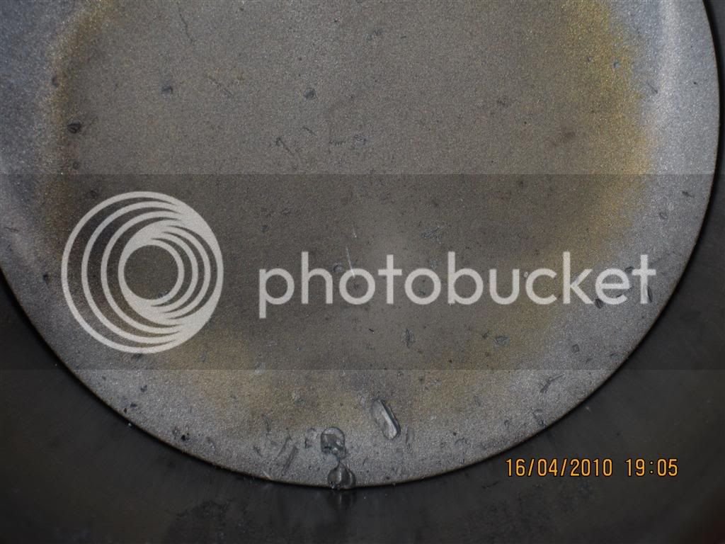

Took the left bank head off yesterday, and had a poke around inside. The colors of the tops of the pistons are all similar (of course these were coated from PolyDyn, so it’s hard to judge.) In this photo, cylinders are 1-7 from left to right:

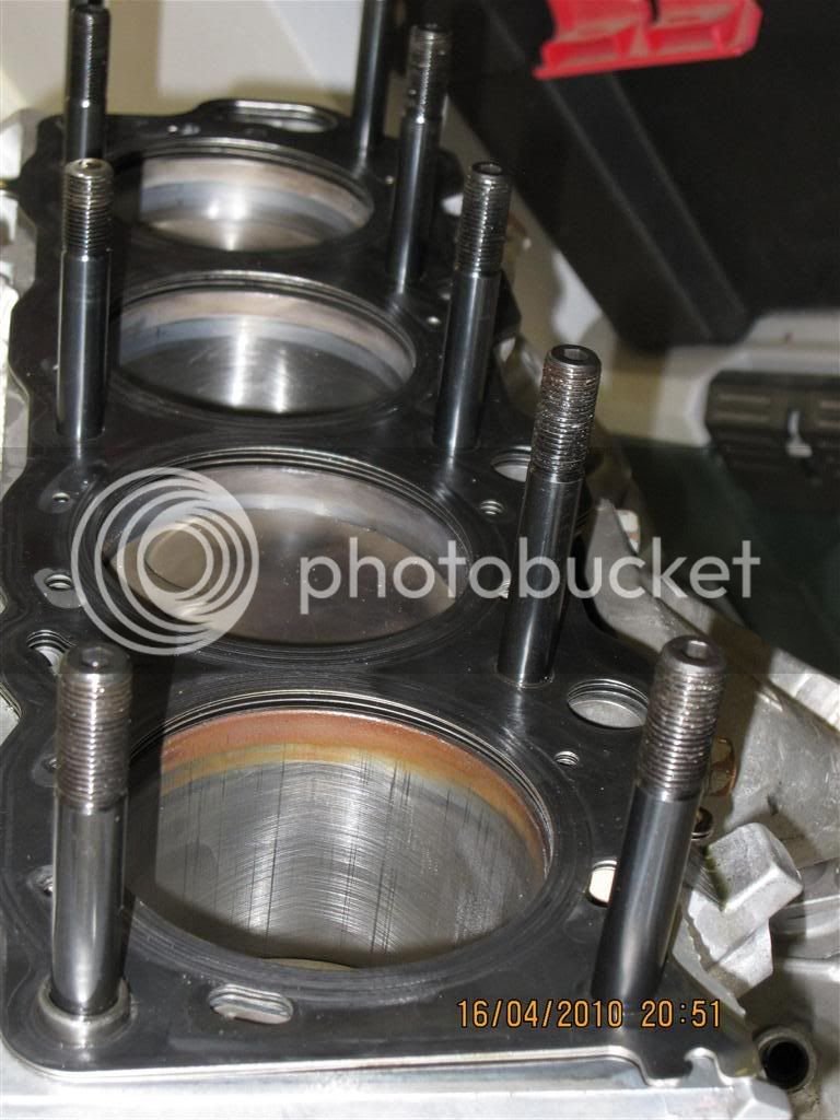

Fortunately the cylinder wall wasn’t scored too badly (those scratches look bad, but should polish right out), but it does look like the head gasket was leaking a bit in #1 and let some coolant in. This is a real p*sser ‘cause this motor has M12 head studs, and I couldn’t break them loose with a ½” ratchet; I had to put a 2’ cheater pipe on it:

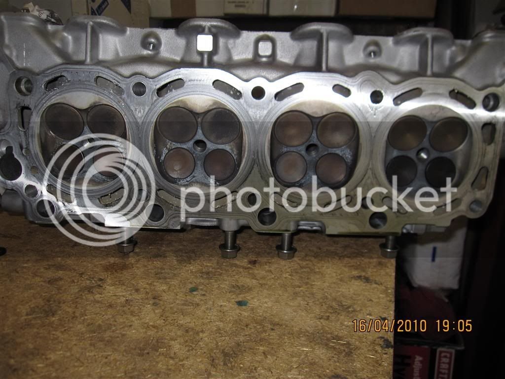

Next I had a look at the head itself, and again, the coloring looks fairly equal, and you can certainly see the effects of all the methanol we ran through it. (Cylinders 7-1 from left to right) You can also see where the spark plug tip dinged the head a bit on its way out of the motor, but this should buff right out:

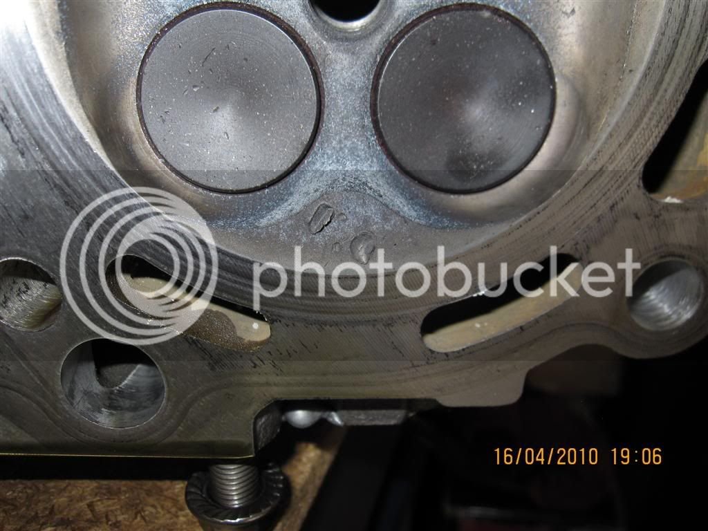

I took the head over to Dennis’ and we dropped the valves out of #1, and I was surprised to see how rough their surfaces were, and the surfaces of the seats. We both feel it was the methanol that did this. We also found both exhaust valves slightly damaged due to the exit of the spark plug tip.
If all cylinders’ valves and seats are like this, it well explains why there’s so much leakage. Good reason for making sure we spend some time doing a no boost cooldown with no M/W injection to flush all the meth out of the engine.

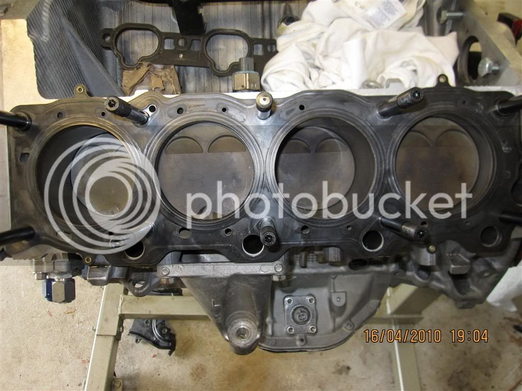

Here's some info for those of you interested in getting rid of those wimpy M10 head studs, and putting some big, meaty M12 studs in your motors. I'm not a fan of upgrading from M10 to the 7/16" hardware because there's simply not enough "meat" left in the 10mm stud bore to drill & retap to 7/16". If 7/16" hardware is going to be used, it should be installed in the block with a Helicoil or Timesert kit.

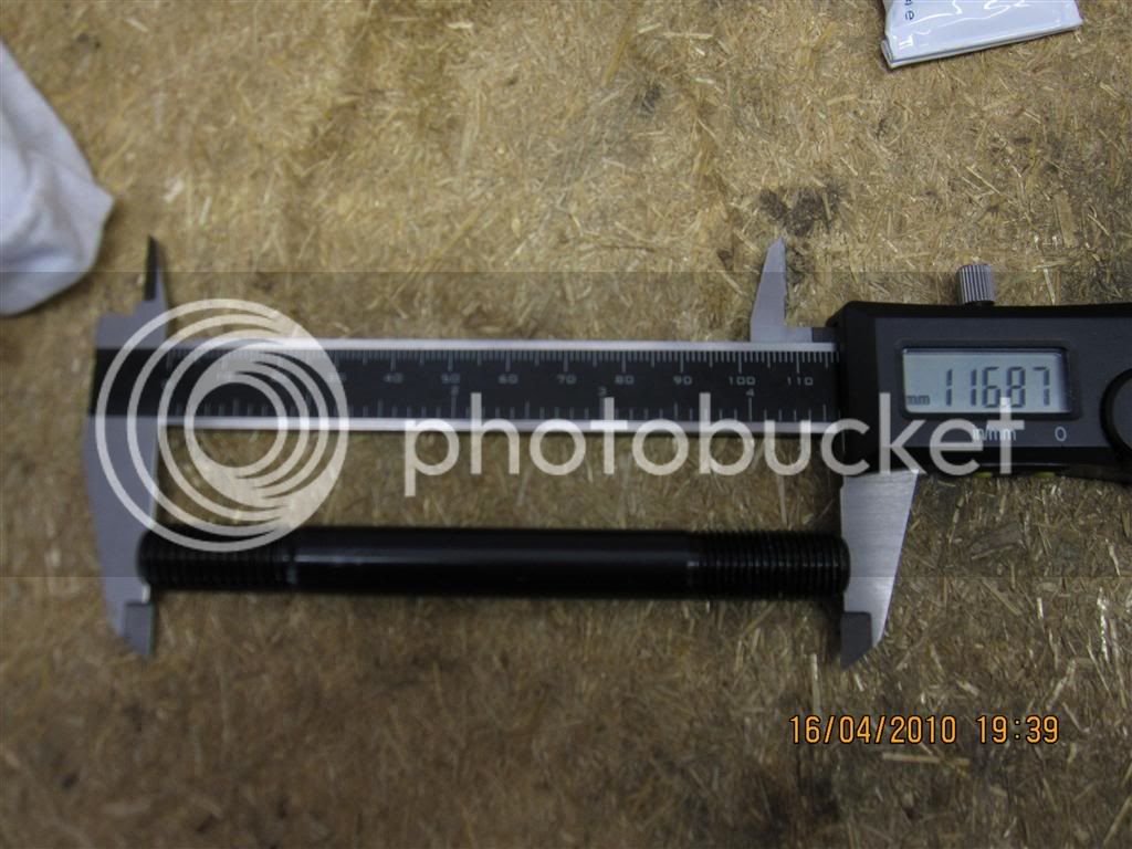

These are ARP P/N 151-4201 studs, and they're intended for a Ford Pinto. Their OAL is 116.87mm, and they have an M12x1.75 thread on the block side, and a M12x1.25 thread on the nut side; unfortunately there's only 25mm of thread on both sides (I know the nut side looks like it has more thread, but it's an illusion):

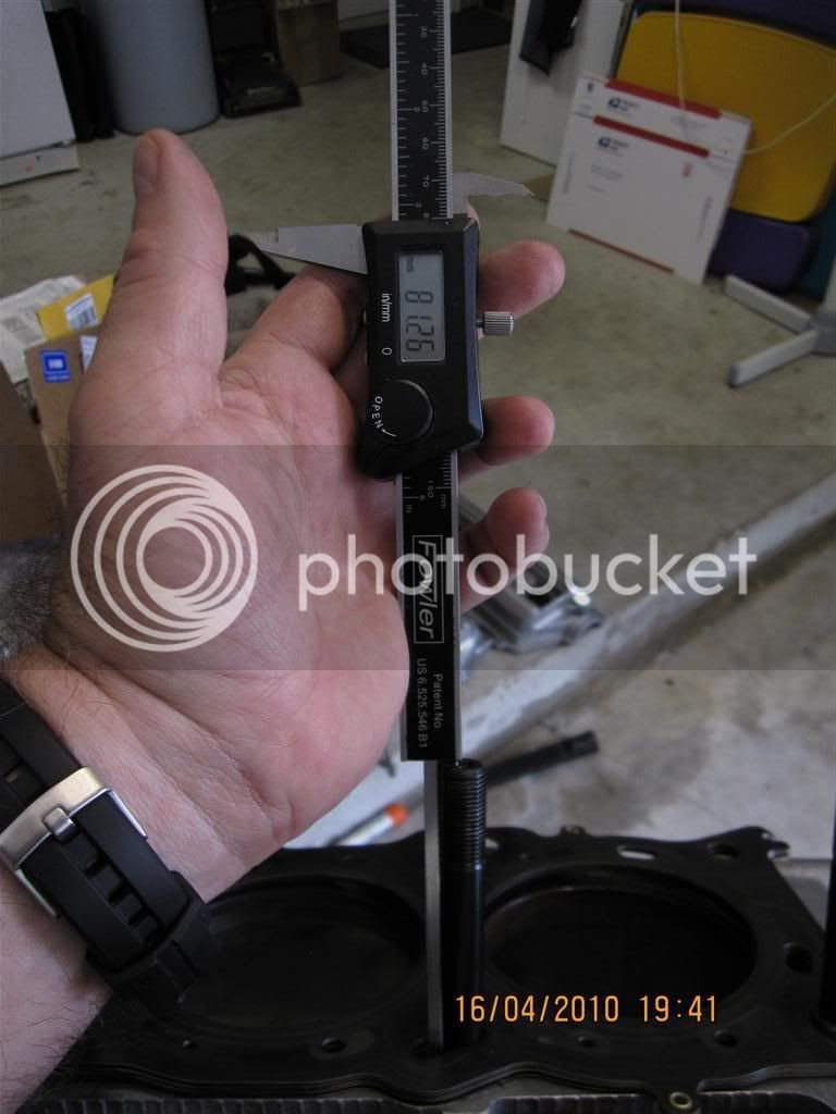

81.26mm sticking out of the block:

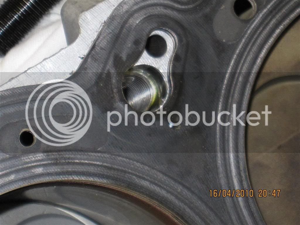

Now if you've done the math, you may be wondering how did we get 116.87 - 81.26 = 35.61mm of stud in the block with only 25mm of thread? Well, we cheated, and put a 0.500" counterbore 11mm deep in the block to "sink" them in:
It's really unfortunate that ARP didn't put longer threads on these, but after all, they were designed for the Pinto iron block application; I've been in touch with them to see about modifying this existing design to add another 10mm or so of thread for our ally blocks. We'll see what they say.....

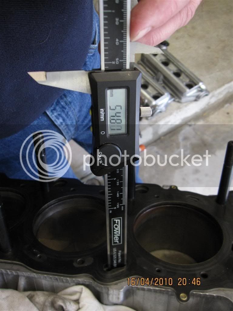

As a point of interest, the bores for these studs can go really deep without hitting the water jackets:
Other mods necessary to make these big studs work are enlarging the holes in the head, and enlarging the holes in the head gasket slightly, which we had Cometic do for us.

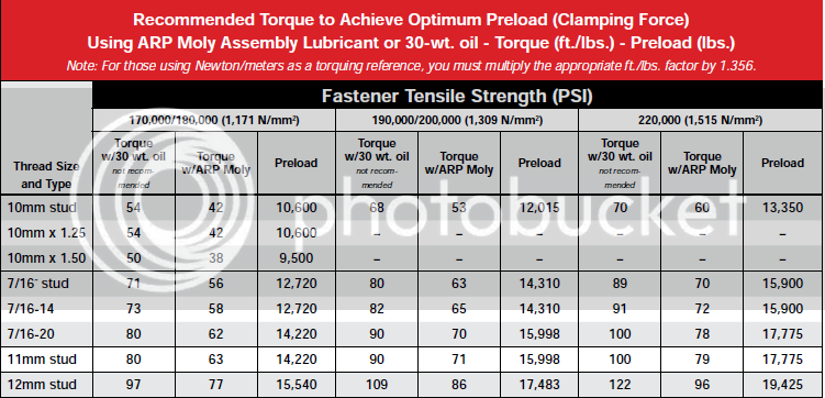

Once these are installed, since they're the standard 190,000 / 200,000 PSI ARP hardware the nuts "can" be torqued down to as much as 86 ft-lbs if ARP's moly lube is used. This is over twice as much clamping as the stock M10 fasteners and 30% more than 7/16"!
With this much clamping, the cylinders are going to be "pulled", so boring/honing with a torque plate is definitely a good idea.....

I thought they had to be modified by Cometic, but after putting the head back on the block the other day, I'm now thinking they were nearly large enough before, and once they were mounted on the deck, and the threaded portion of the studs passed through them fine, and their threads engaged in the block, the non-threaded portion of the studs simply pulled themselves through, and enlarged the gaskets the rest of the way. Not very scientific, and it may have caused a tad bit of distortion, but it seemed to work OK.
